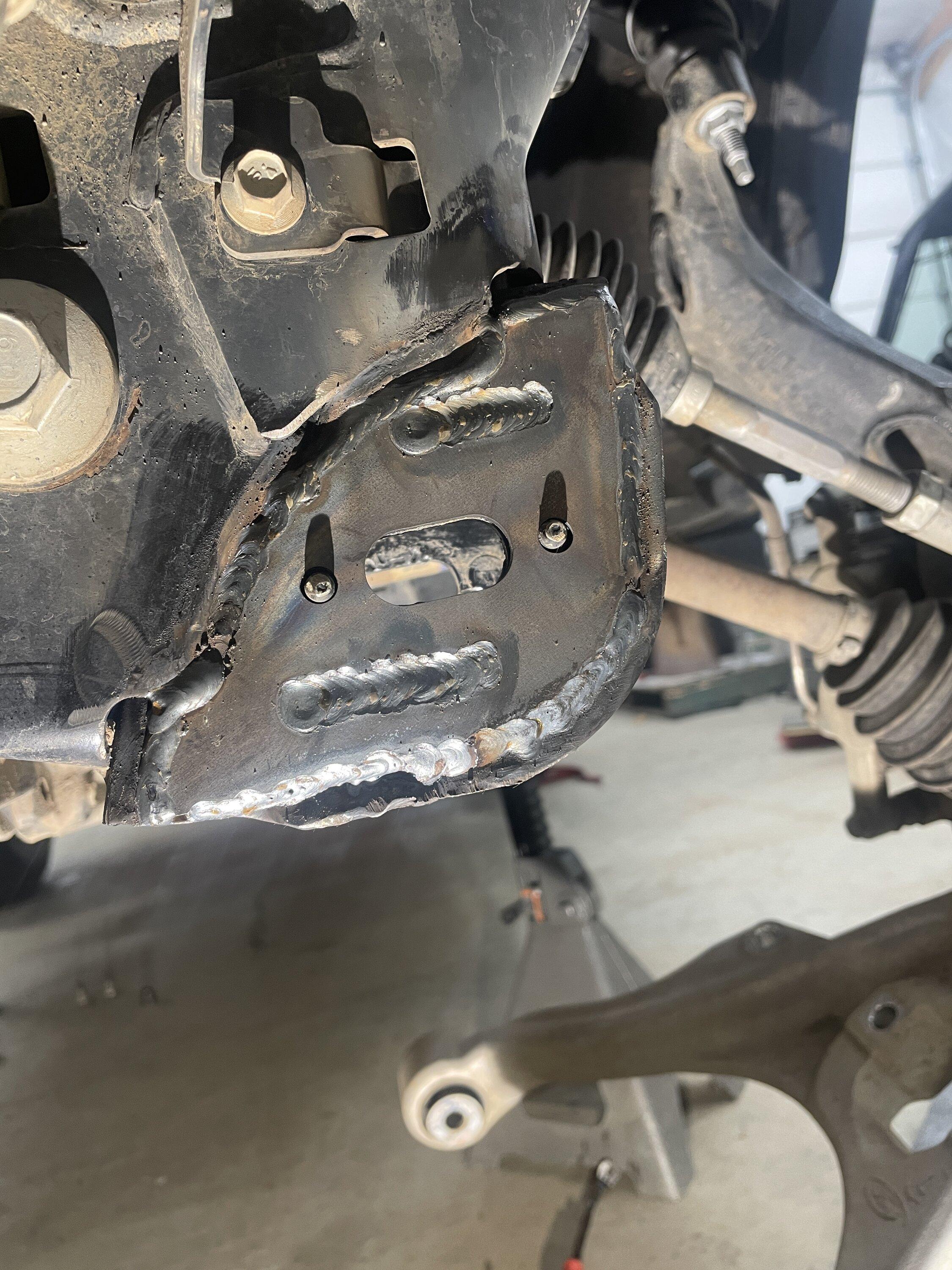

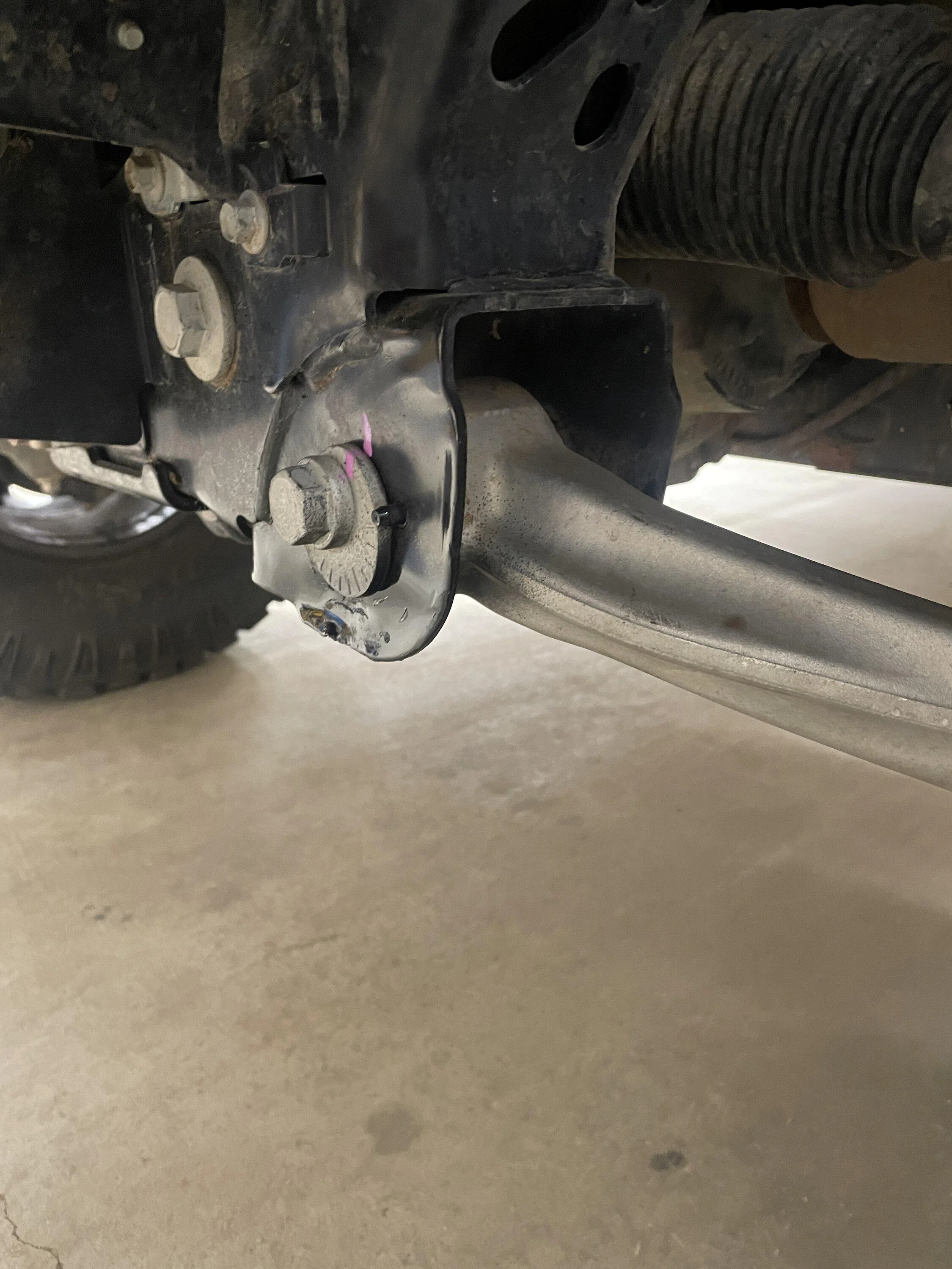

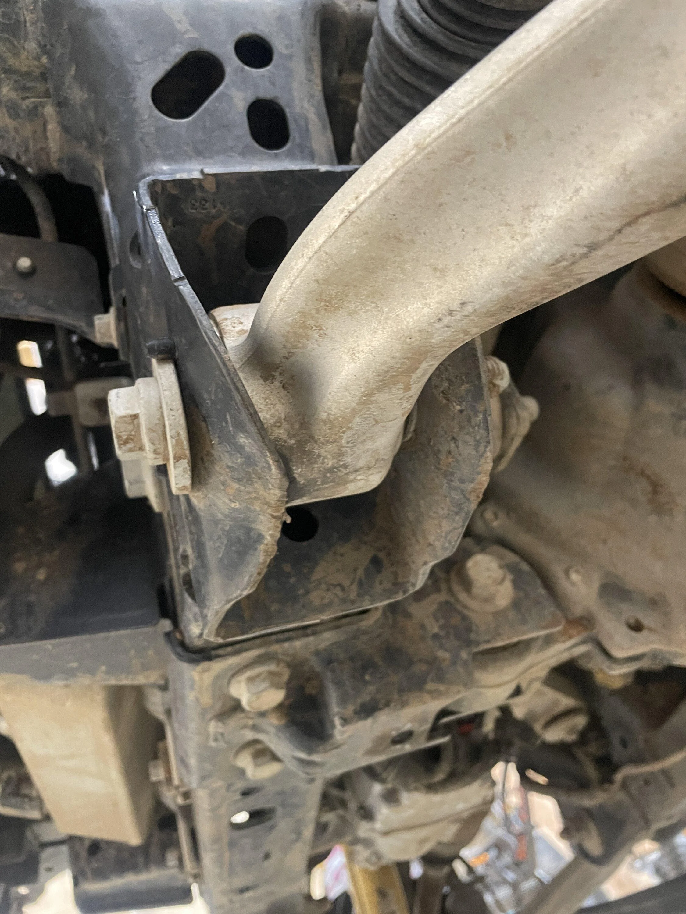

Over the summer I took a hit with a rock on a trail and folded my front driver a arm mount tab a bit.
Ford Bronco Front A arm frame mount reinforcements DAF2A1D6-711C-4D7D-B0D9-44880CB7EA6F
decided after straitining the tab that some reinforcement was in order.
Ford Bronco Front A arm frame mount reinforcements 570BEA8C-201E-4F22-94AE-4B33C55EB60C
ordered up and installed this kit from Barnes 4wd
https://barnes4wd.com/products/bronco-front-lower-a-arm-pivot-gussets
fit up was great and can’t beat the price.
in process pic of welding the plates on
Ford Bronco Front A arm frame mount reinforcements 9A6DB555-9183-4574-9CF2-25B8A501D609
Was a few hours of work to get all 8 plates welded on but well worth it to have a bit more strength.

I how did you bend it back out I have one like yours?
Mikerider
Mikerider
Oct 16, 2020
247
548
Washington
Raptor, Ranger, Mustang, Focus, Explorer
I pulled the lower control arm. Then put some all thread and nuts/washers in place to hold the spacing. Used a combination of large crescent wrench and hammer and dolly to get it back straight
