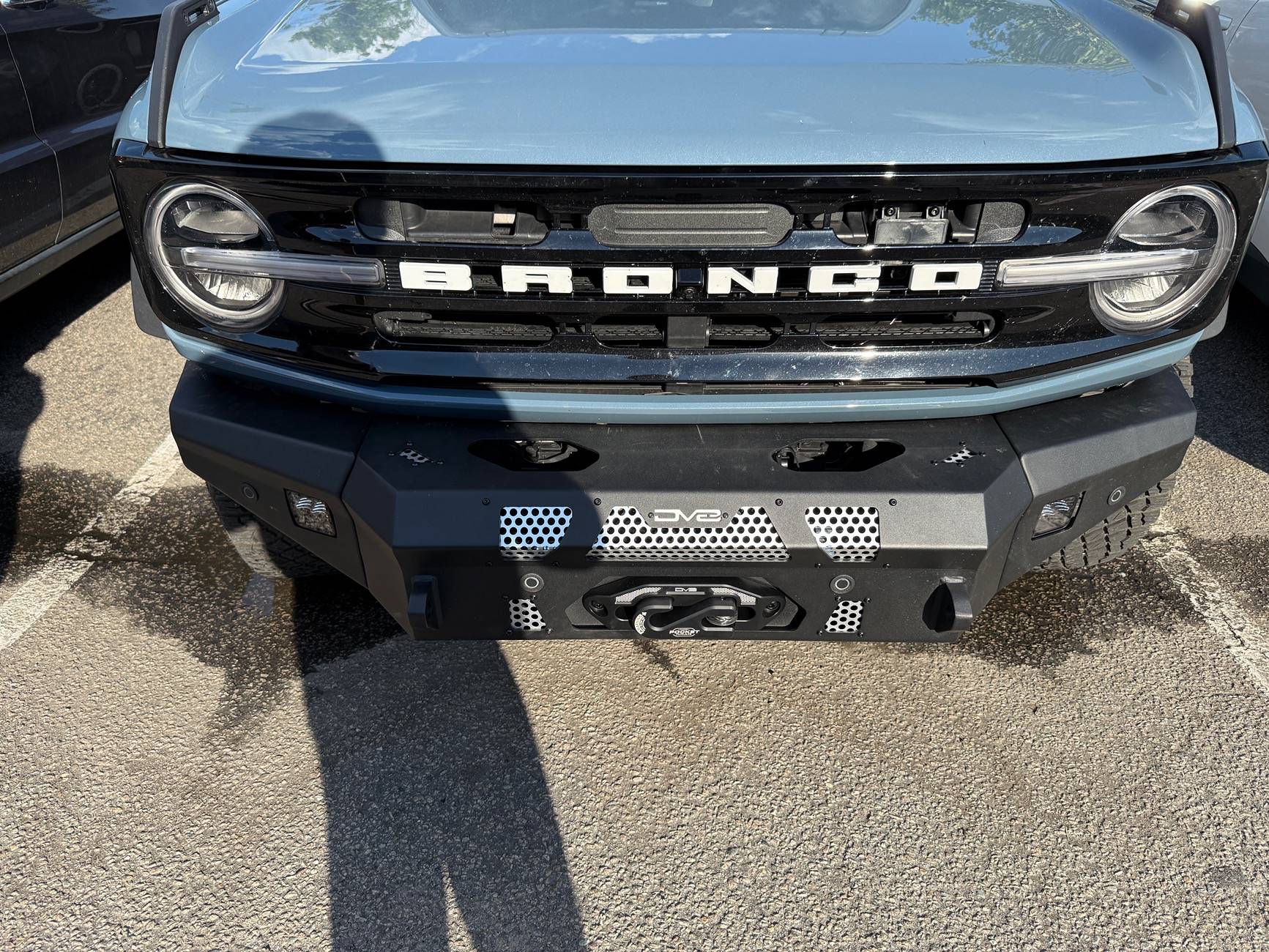

I’m trying to get a DV8 bumper on while using the original nut plate and nothing lines up. I mean I can get some of them but not all. So I need to switch to nuts instead.
What would people use that matches the threads on the nut plate?

Yeah it’s 100% the alignment of something but since I can’t muscle it in with 3 men today the rigid plate is getting scrapped for nuts.
I’ve read a few people having this issue in general.
The bolts go through just fine and I just can’t get them to all thread to the plate. Also the design of this bumper makes one bolt very hard to get to so if I can tighten from the rear it will be infinitely easier which means more likely to be torqued correctly.

I found the nuts are bent on the plate , straighten them and run a tap thru them helps.
I still have one plate to reinstall cause I was in a rush last install.

M12x1.75 IIRC
Tricky Mike
Jun 26, 2023
2,044
7,264
21 Bronco
M12x1.75 IIRC
Sounds right. Undoubtedly M12, and the pitch is fairly coarse.
Better off ditching the cheeseball nut plates anyway, they'll rip through if you put some decent force on the bumper.

Thanks I did what @Tricky Mike suggested and got rid of them. I need to back them out and apply red thread locker before I’m satisfied but it’s on there now.
Ford Bronco Front Bumper Nut Plate IMG_1036
I’m also going to try and engineer, then 3D print, some inserts for the hand holes on top.

That shouldn't be too difficult, looks good!
