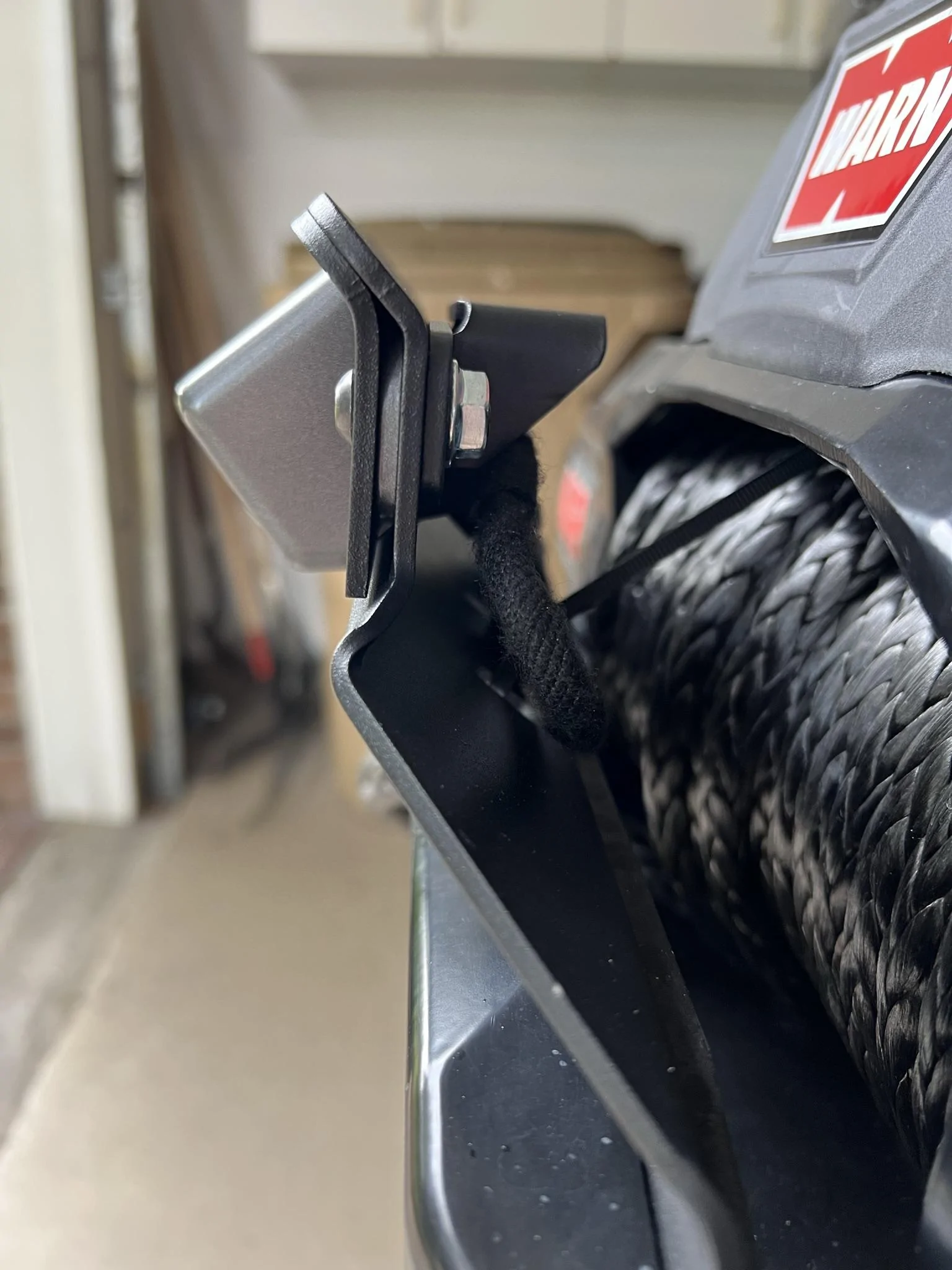

Ford Bronco Front Camera F041FAB5-AC74-44A2-A1FA-ECAE9FDE3E18

$6.49 for the cable on Amazon. And I moved my camera down to the "grill" area of the RC High Mount. Simple and free lol, had the two bolts, washers and nuts on hand.

Yeah I'll get some pics this evening. It's all simple, remove grill, remove camera, plug new cable to the end of the new cable, put grill back on, fish new cable behind the grill and through the winch mount, attach camera to the front of the mount where the led light would go.
