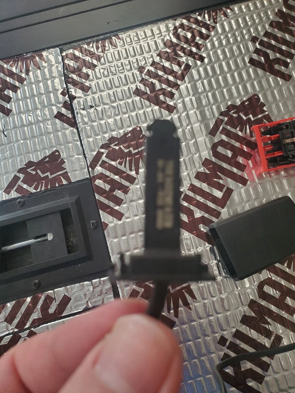

For my rear I actually removed the belts. To not get an airbag warning light you have to crack open the latch side of the belt and remove the device that sends the signal. It is on my build page.

The process should be the same of removing the receiver end cracking it open removing the wire and stuffing the electronics out of the way. Or am I missing something?

This peice correct.

rear seat belts: yes the pic from above is the correct part for the rear seats. I purchased two rear seat belt assemblies and hulk smashed that little part out, then simply plugged it in to defeat the rear seats belt alarm.

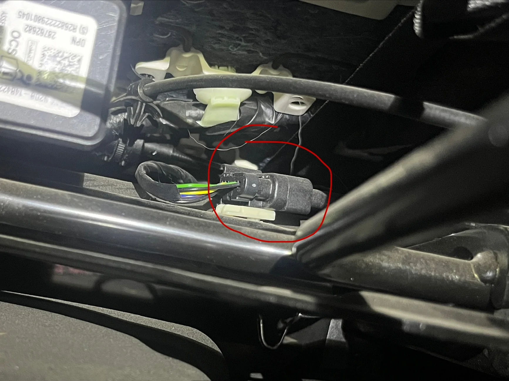

Here’s what little I know so far. I unplugged this harness under the front passenger seat and the dash error displayed a “rear seat belt” error. I can’t remember the exact warning but it was “rear”. (I should have disconnected the battery first but I did not, will do next time. Yes, vehicle was off). I believe this is the one I need to figure out.

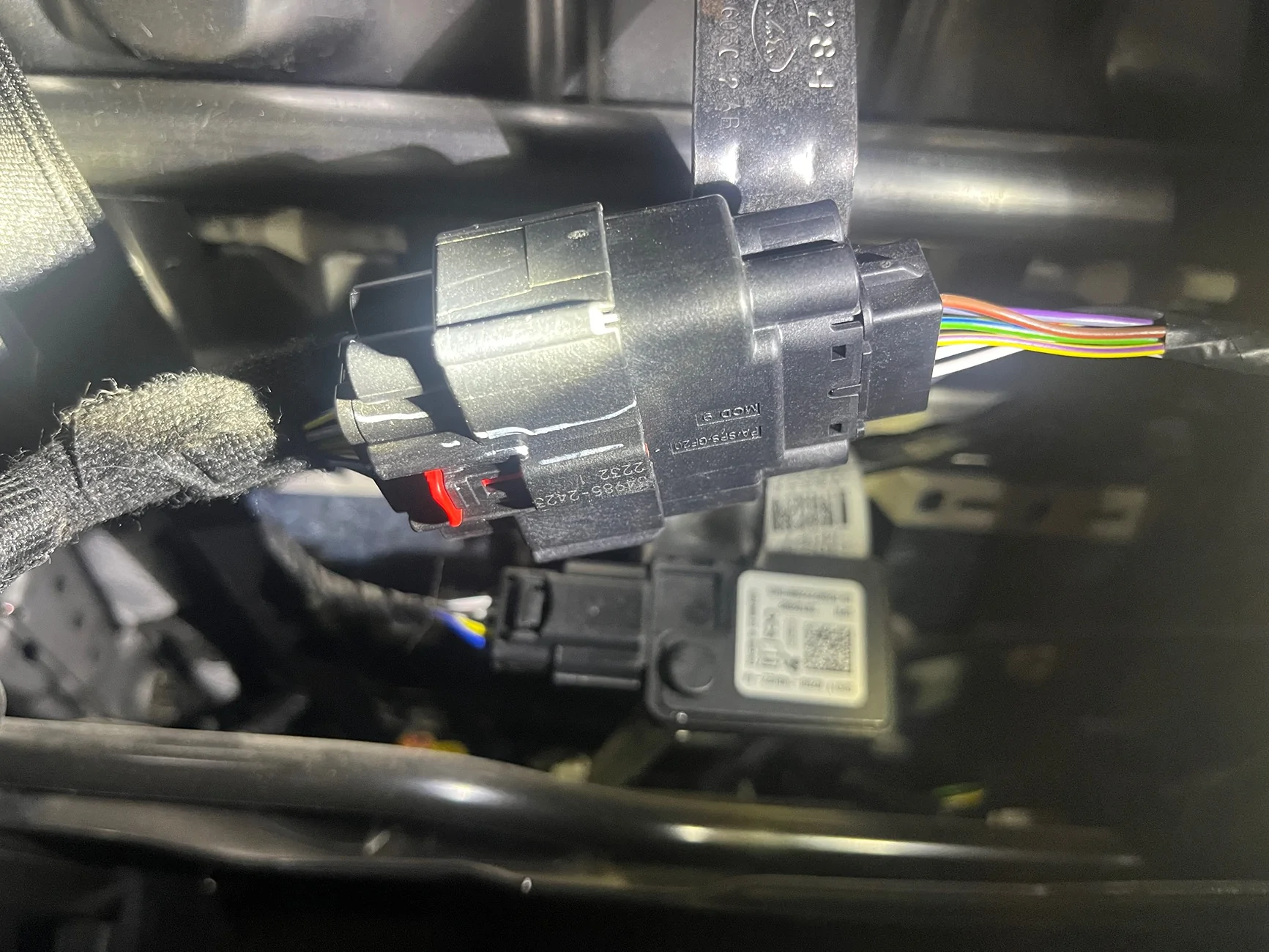

Also under the seat is this plug, looks like it leads to the female seat belt buckle but I’m not sure yet, and definitely not flexible enough to jam myself under there to see what’s going on without pulling the mounting bolts and making some room. If this is true then I’d wager the process to defeat would be similar or identical to the rear buckles

This of course is only speculation, I’ll admit electrical skill is at the bottom of my skill set. Ha ha ha.
Also it’s worth mentioning, this entire idea is only valid if the process to remove the seat is relativity easy. As I would only do this once or twice a year, so it would need to be easily reversible and simple to execute.
