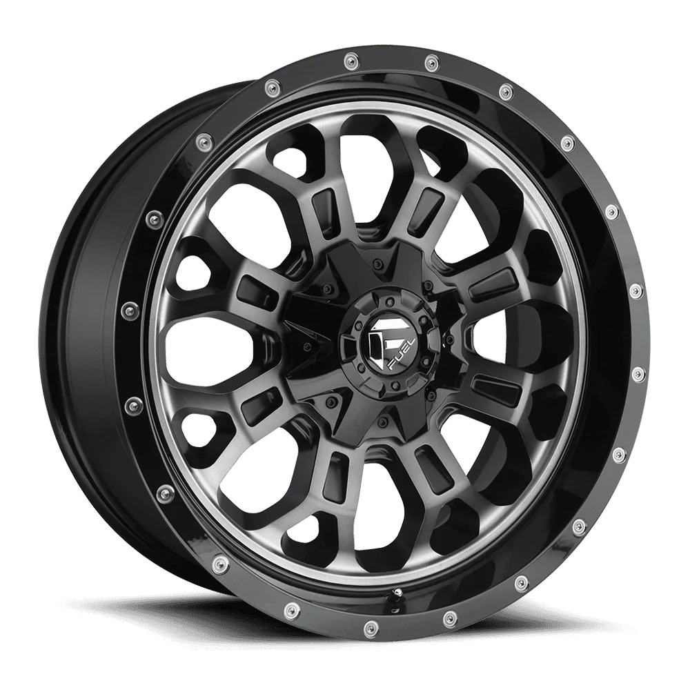

I see that the stock wheels on the Bronco are 55 offset. I have a base Bronco on order and want to put on 33” tires with the Fuel d557 wheel with a 6 offset. It should push the tires out about 2”. Does anyone think this would work ok?
I am also getting Fuel Wheels, a different one the "Crush"
Ford Bronco Fuel Wheels D557 6 offset FuelCRUSH
. I am going up from a 17" to an 18" wheel. I am going to get the 20 offset(it's made in this style) as they don't make a 55 offset...it puts the wheel outward 1.38" and I think it will look nice and still be street legal. Check your local laws on tread coverage by flaps/fender. Note the hub sizes do not match I and strongly suggest you get hub centric rings. The hub on the Bronco is 93.1, check the bore hole size on the wheel you select and get an adapter. (the adapter for mine is a 93.1 / 106mm) You can find most of them on Amazon. My tires will also be 33". There are offset calculators on the net that will show a photo of old and new set up overlayed. Your local wheel specialist should also be a big help to you.
