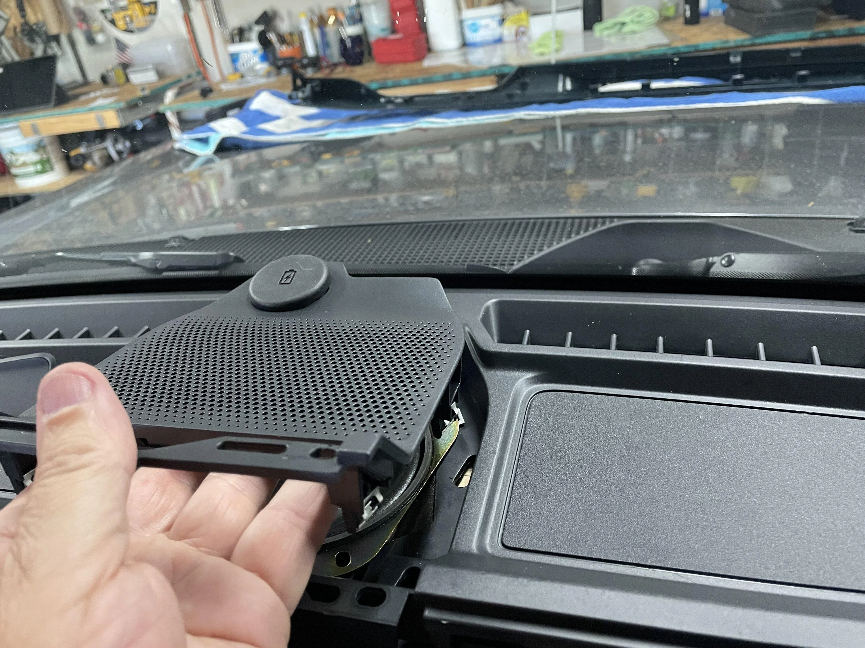

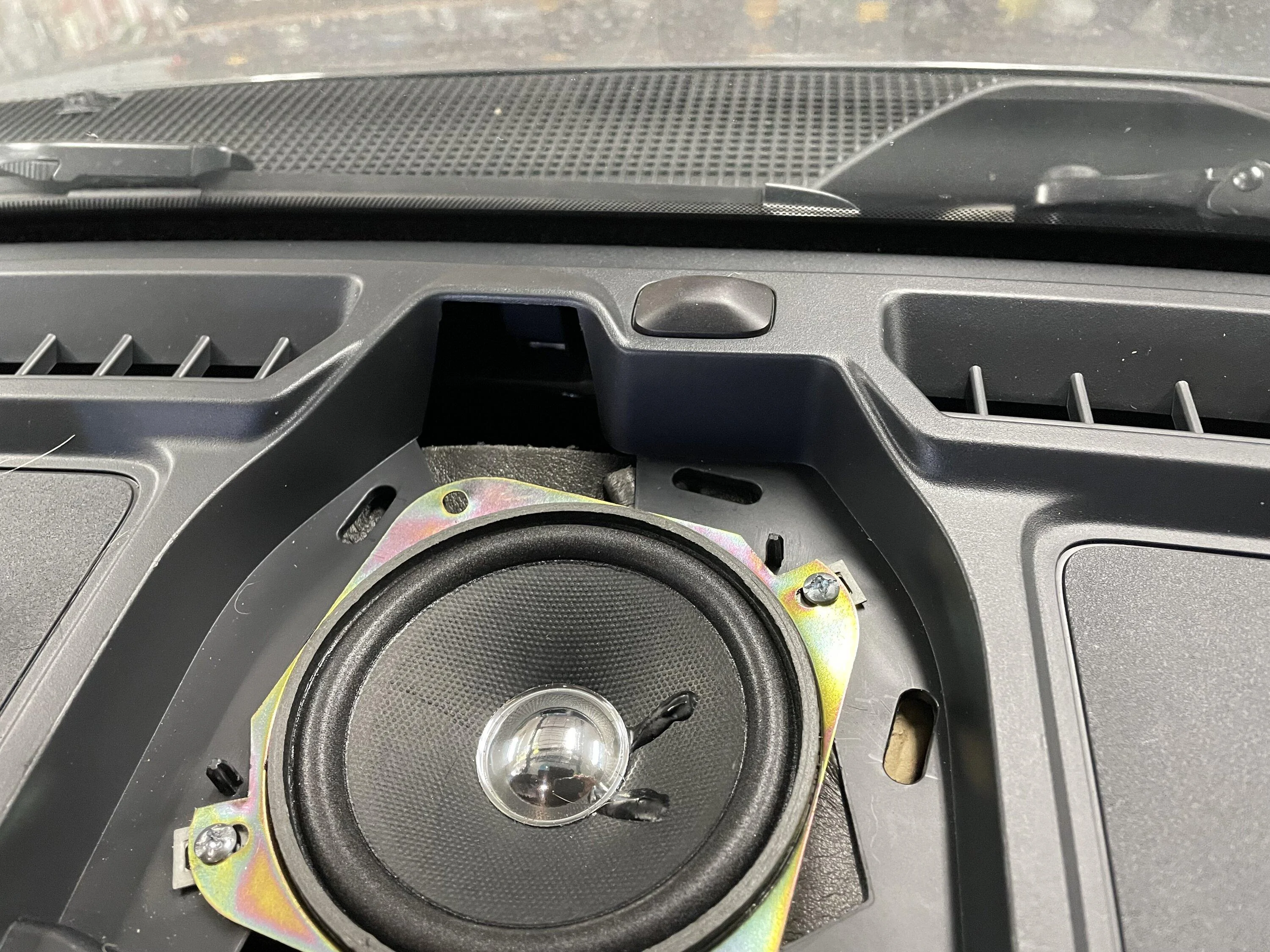

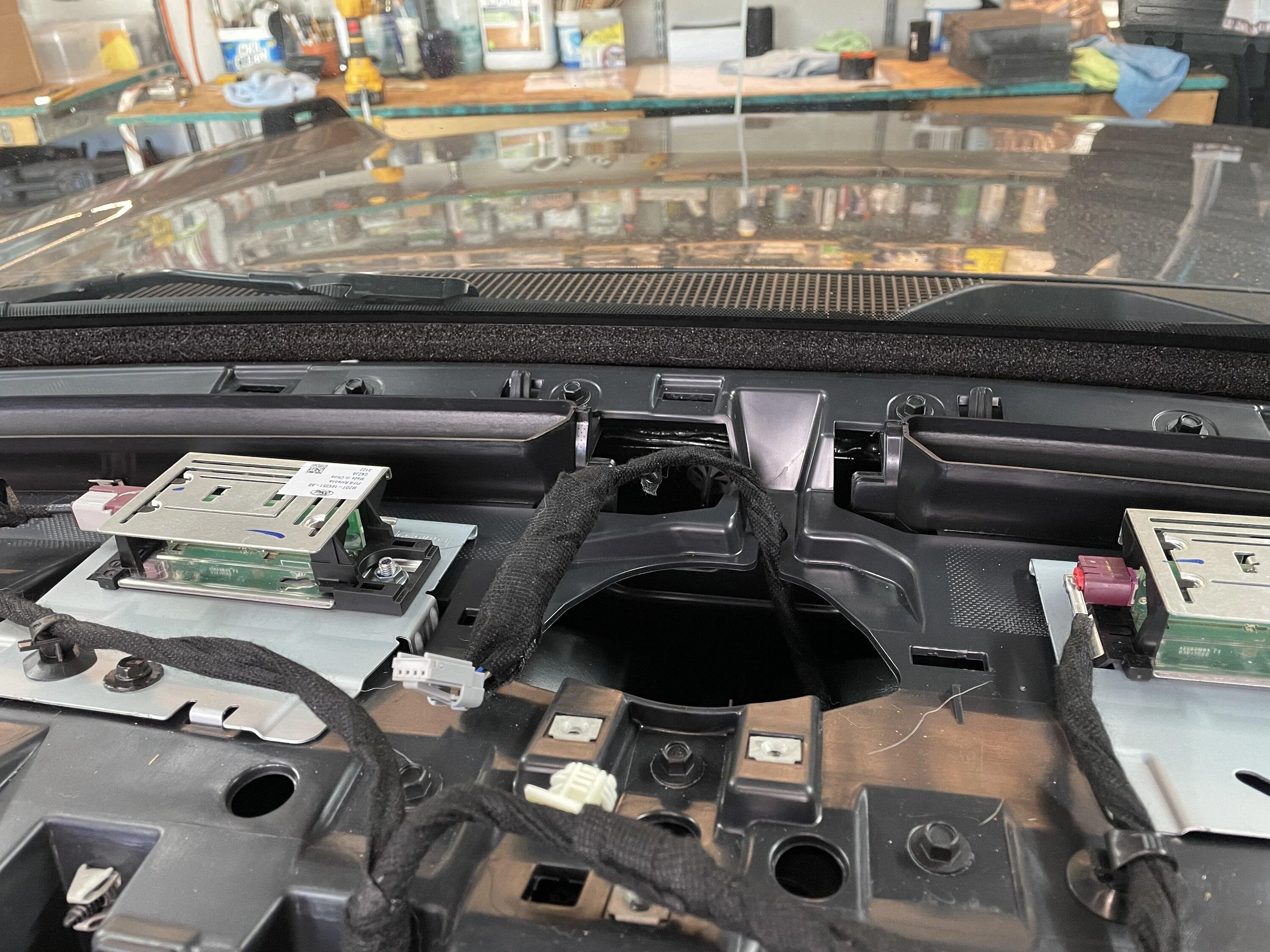

I did a Midlands MXT275. My stereo is the basic OEM so I had no center dash speaker thus I purchased a new upper section with the center speaker hole and the grill to snap in. I also got the external speaker from Midlands and removed the speaker from the plastic box.
taking apart the upper dash was easy then installing the new section, adding the external speaker.

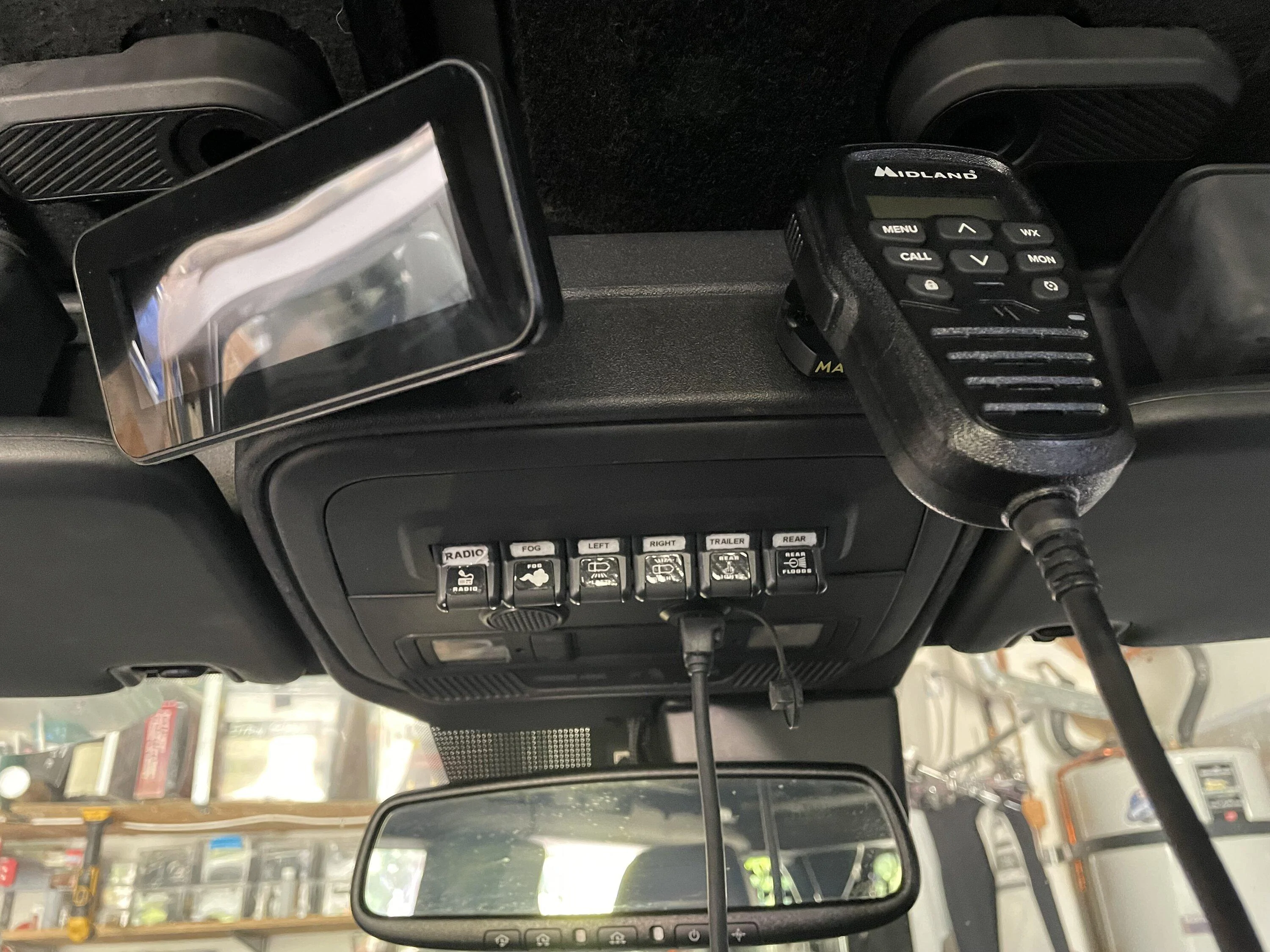

I installed the MXT275 in the area above the glovebox with a self fabricated bracket was simple.

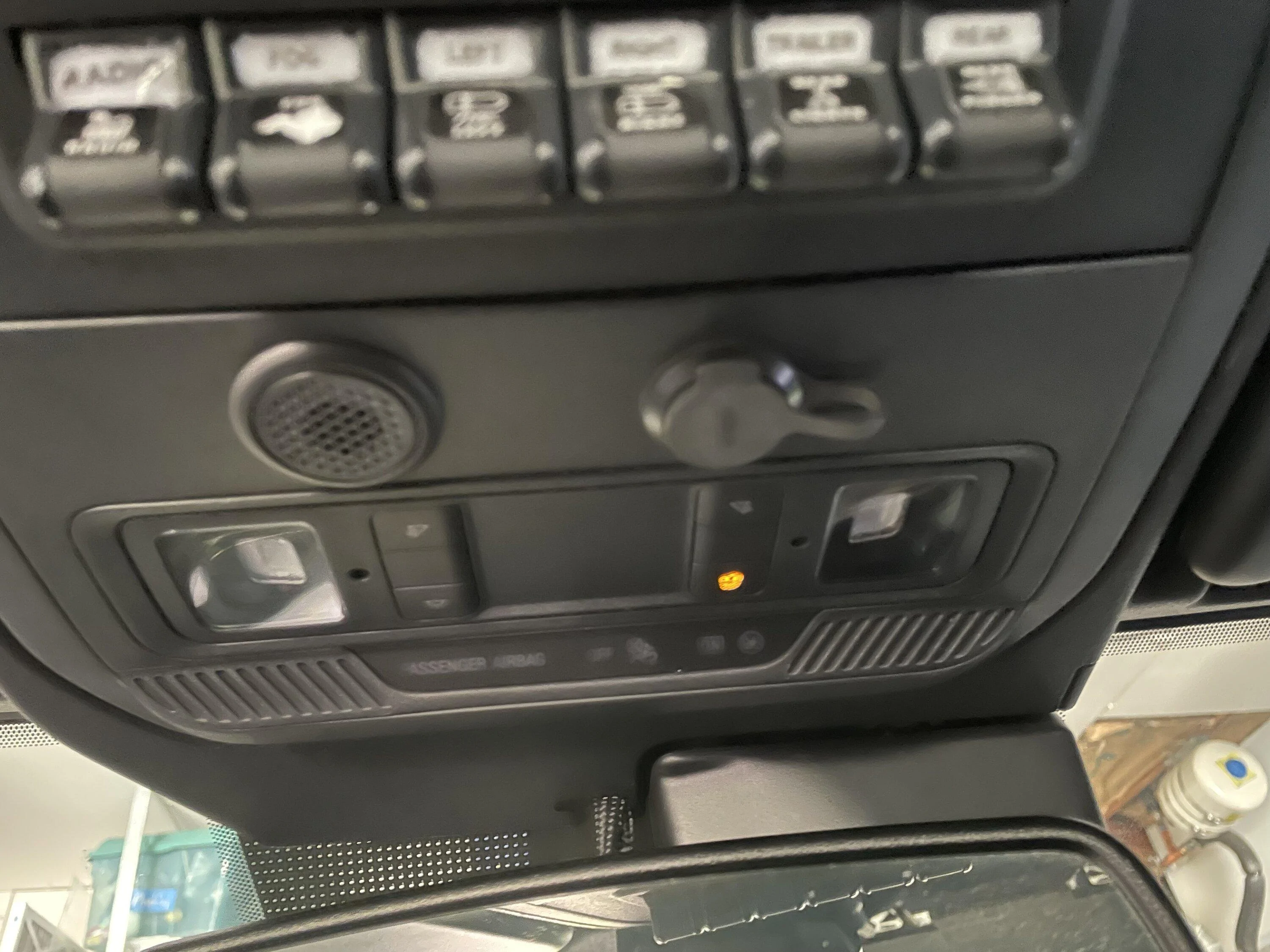

ran the power for the radio to the first auxiliary switch.
and lastly I ran the microphone extension through the dash up through the A-pillar to the auxiliary switch box and installed CAT6 feed through connector.
installed a magnetic mic block on the front edge of the Auxiliary box.

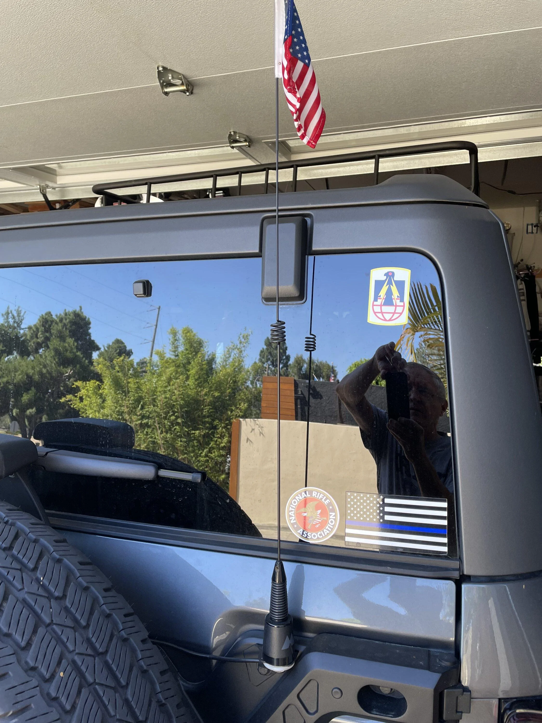

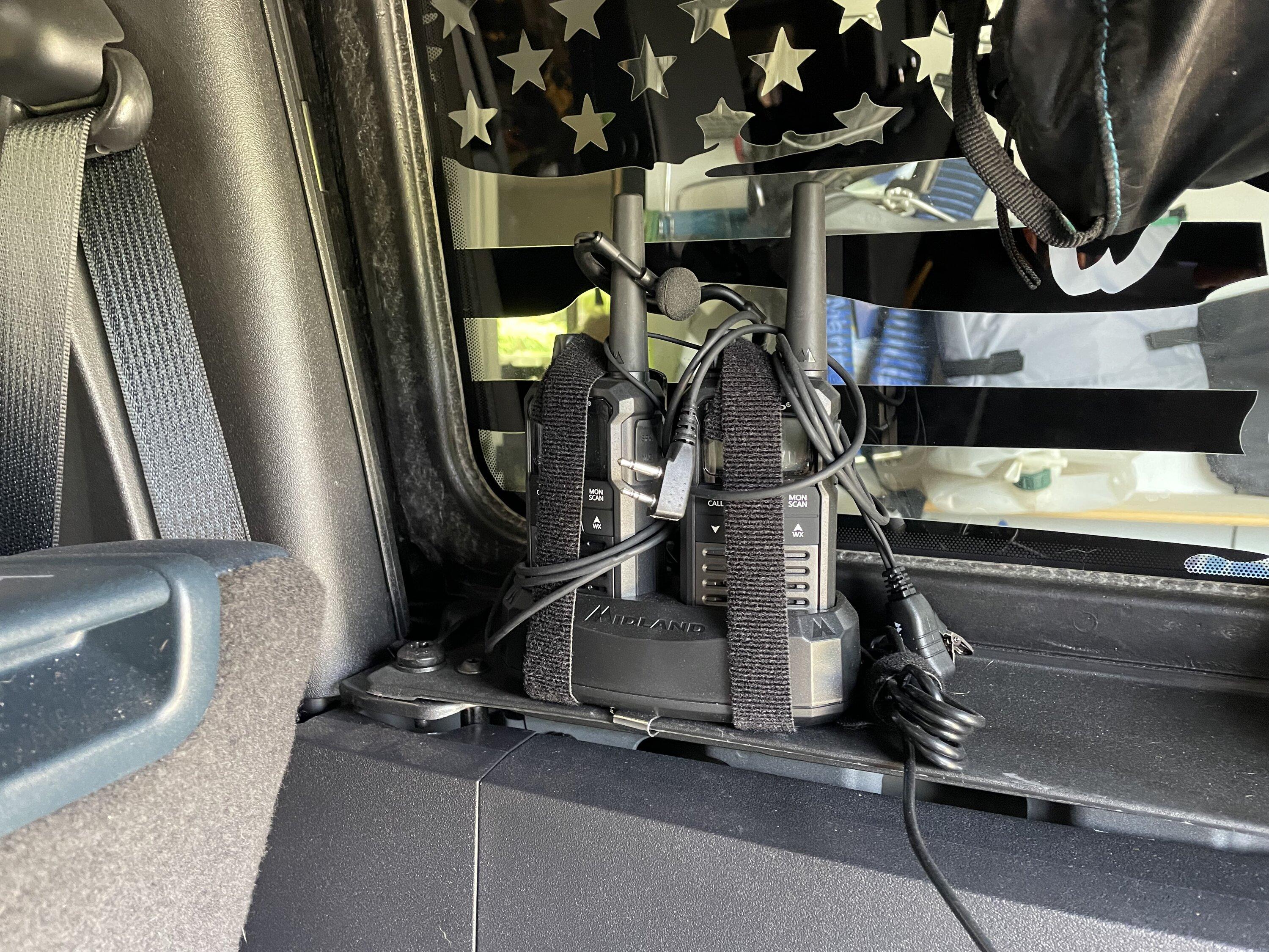

Two other things to complete the install was the add of antenna extension and whip ran to the rear. The last was due to the package deal of the 2 handheld remotes with charging stand, they got a clip add to the bottom for easy mount on the rear edge of mic.

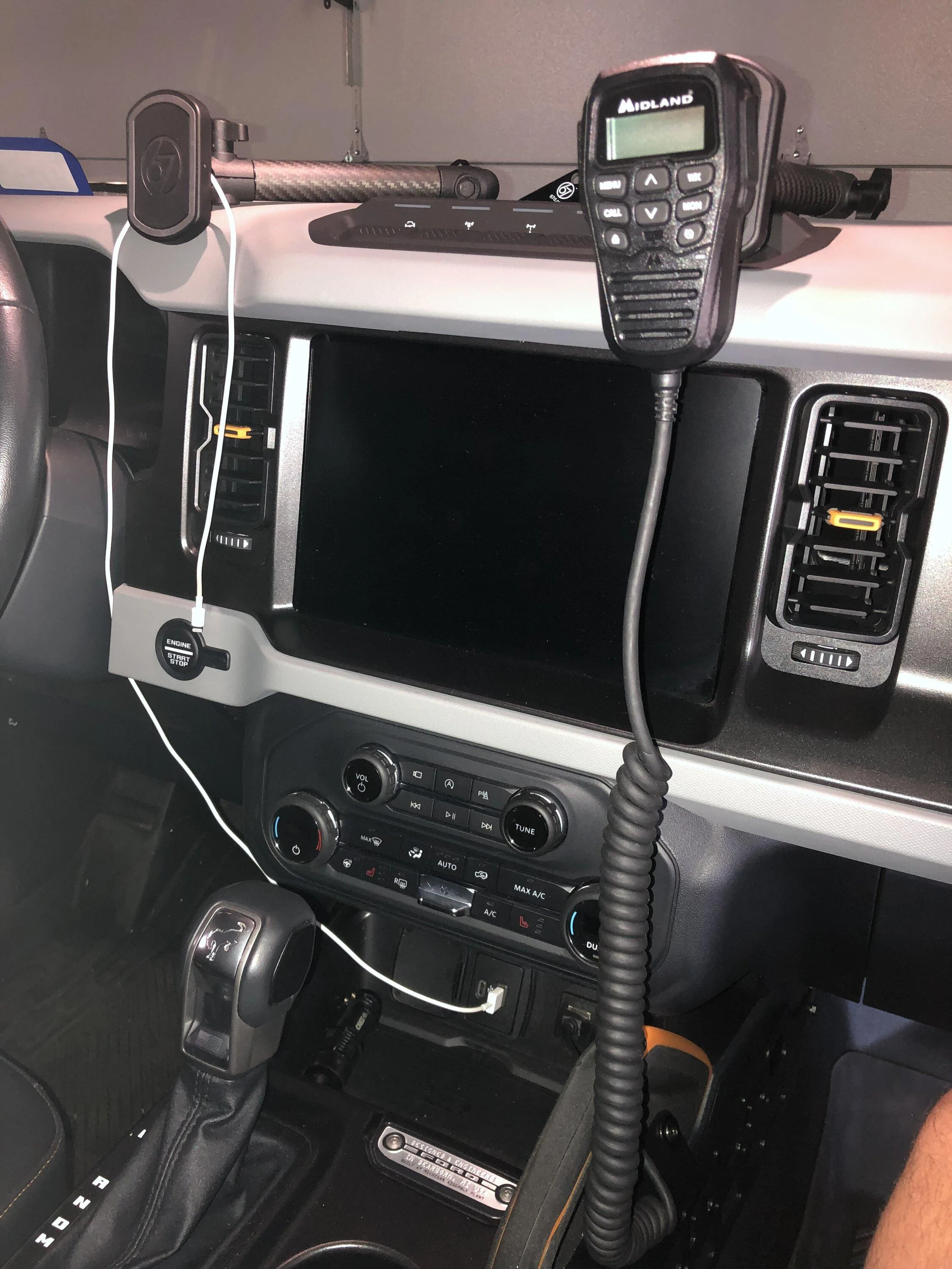

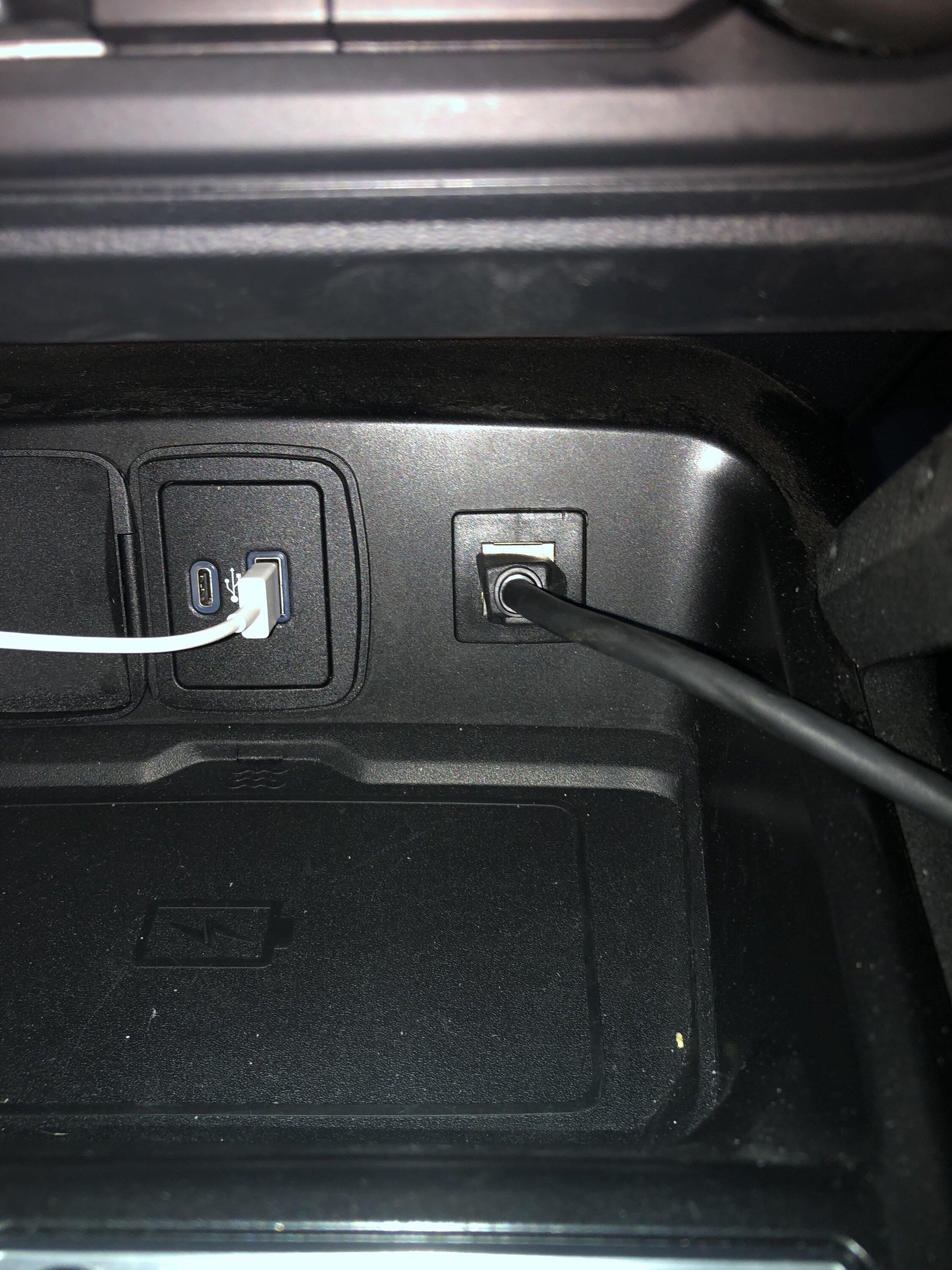

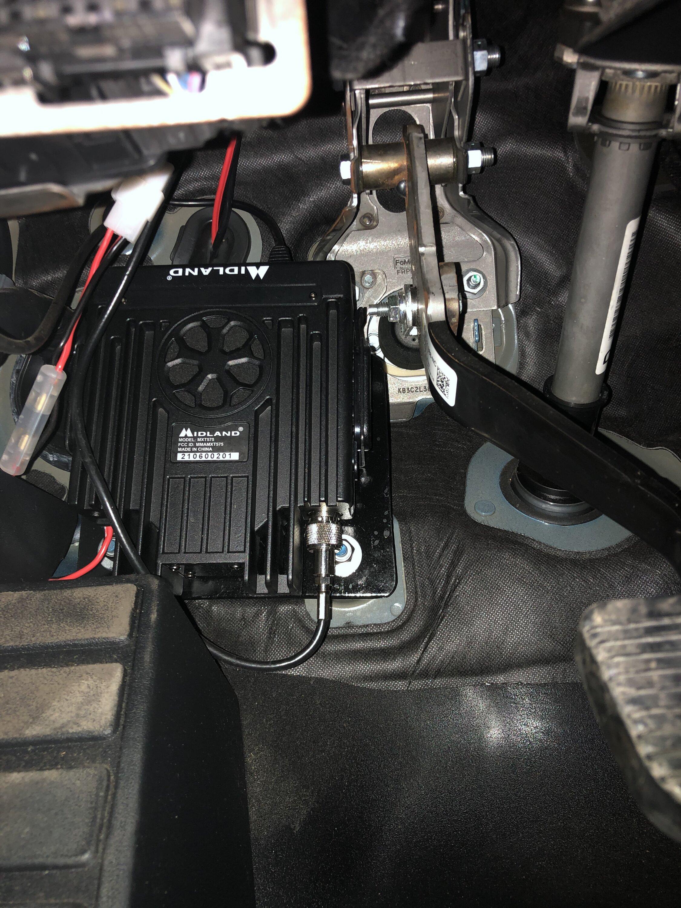

I chose the Midland MXT 575 for the extra power but it’s larger size makes it difficult to hide. I found a great location on the firewall just to the left of the brake pedal arm. I purchased an extension cable from Amazon to run the mic mount to the center console by the charging pad. When I’m not using it, I can remove the mic and put it in the glove box so nothing can be seen. I just use the speaker in the main unit and it’s more than loud enough even though it’s mounted under the dash.

Do you happen to remember the part number for the center dash section?
Bellime
Keith
Nov 12, 2022
68
719
651
2022 Ford Bronco
M2DZ-78044E82-DA
M2DZ-18978AG​
Defroster Grille
Grill center speaker​
