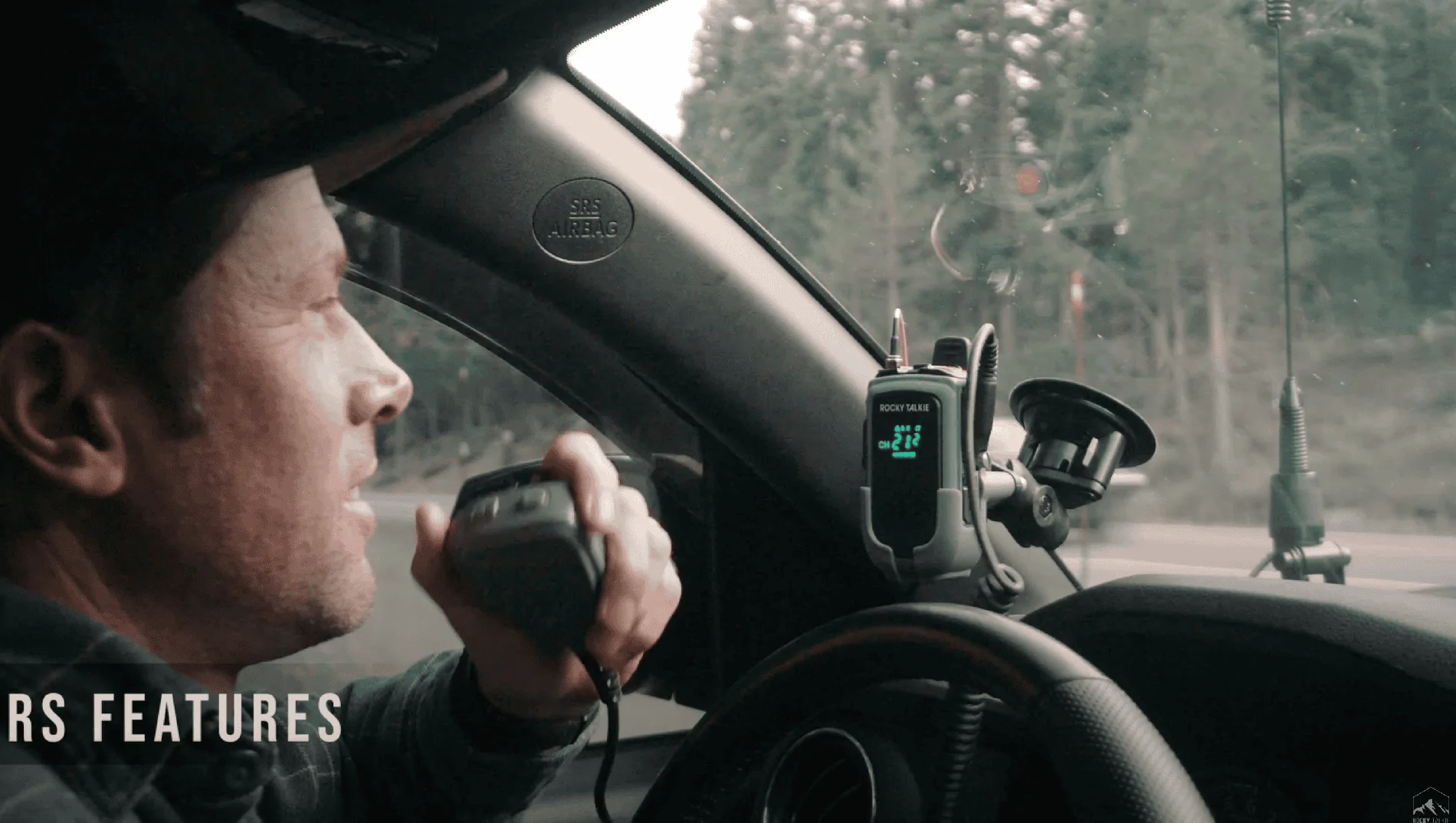

Interested in the Rocky talkies. You like them ? Clear transmissions? I looked at them plus Scott Brady recommends them but I’m a newbie so I am just looking for something that works and is reliable. Not going to be traveling in large groups etc. just more of a personal preference I guess. Plus I am more of “less is more type of a guy.”I don’t want a zillion pieces of electronic equipment inside. No need for more GPS, iPads, or other miscellaneous navigation.
I've had my pair of 5W Rocky Talkies for about a month now as well and really impressed with their quality and performance. We mostly use the Bronco for camping and hiking, with some off road adventures mixed in. These things are perfect for those kinds of activities like around camp or for the occasional spotting when rock crawling. We haven't done many group runs, but these would work fine for that as well.
I'm interested in their dashboard mounting cradle that they've teased so the handheld can have a dedicated place instead of in the cup holder or just clipped onto something. I'm also entertaining the idea of connecting it to an antenna mounted outside the Bronco to increase the range.
