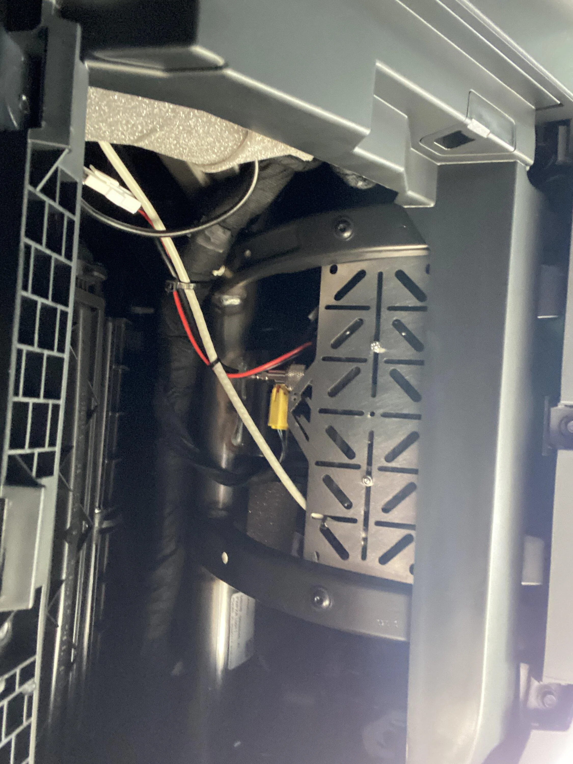

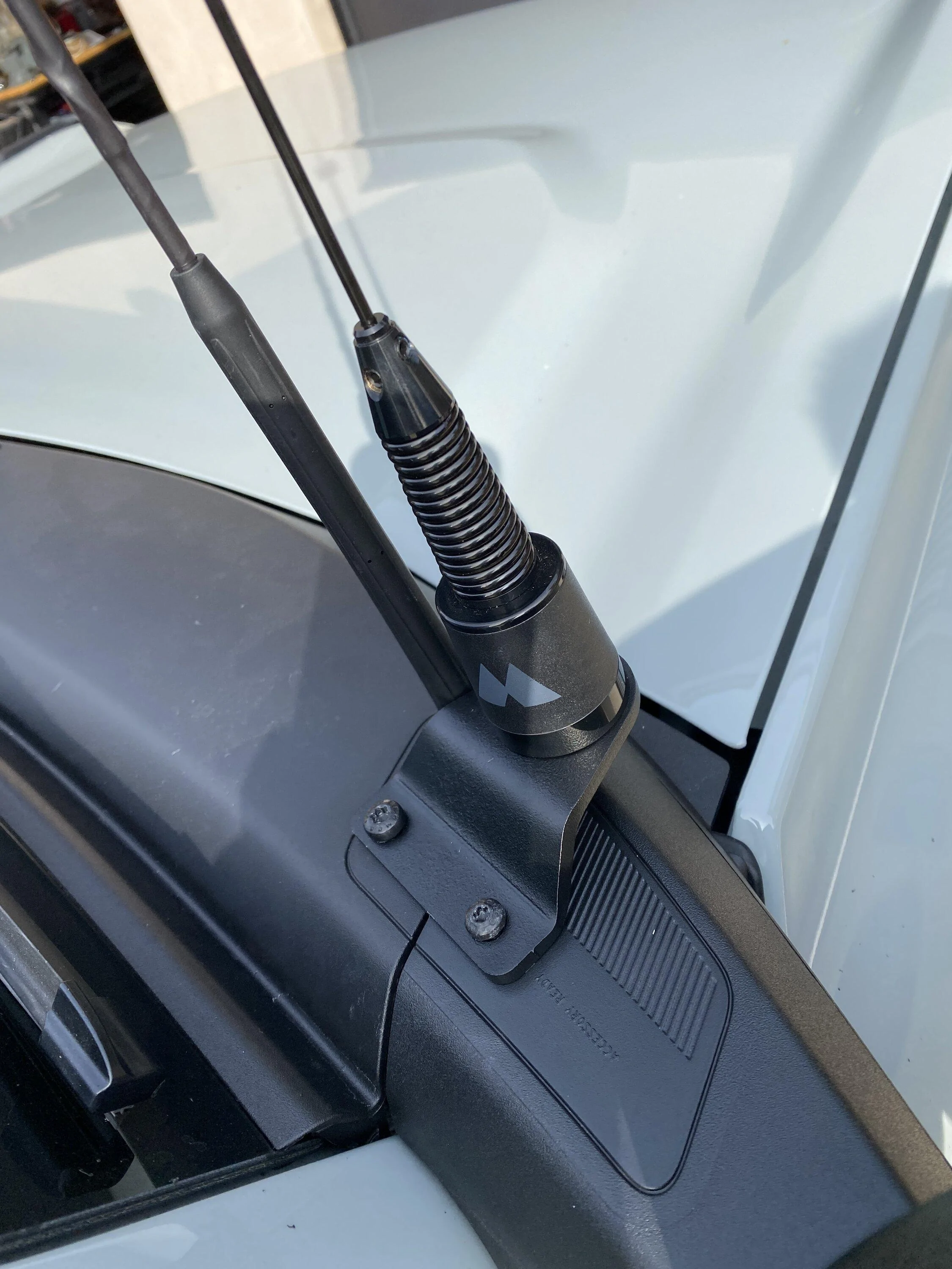

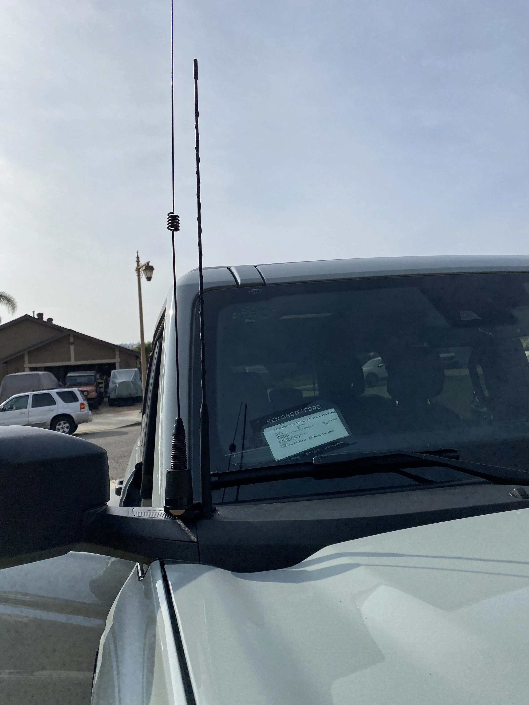

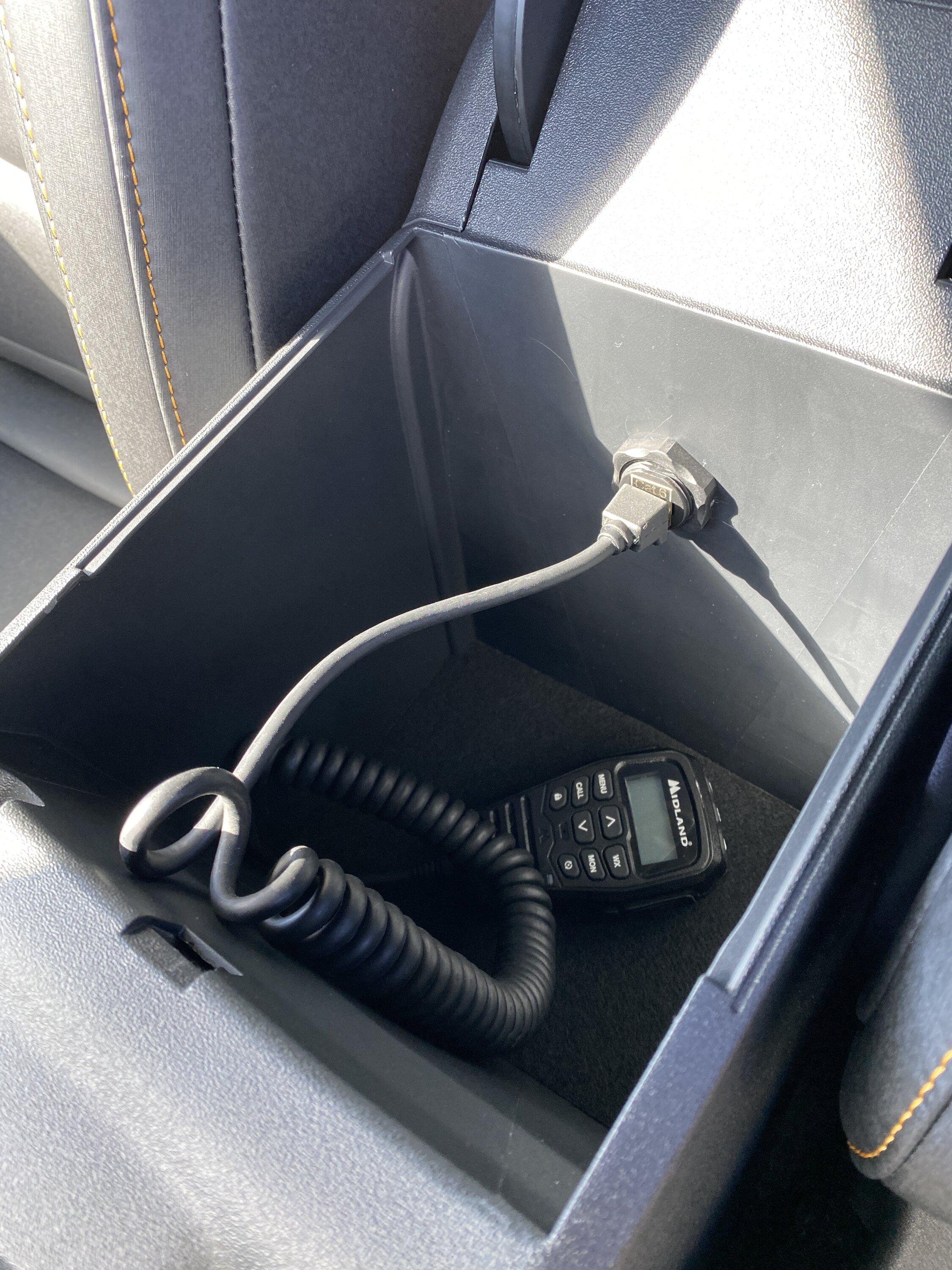

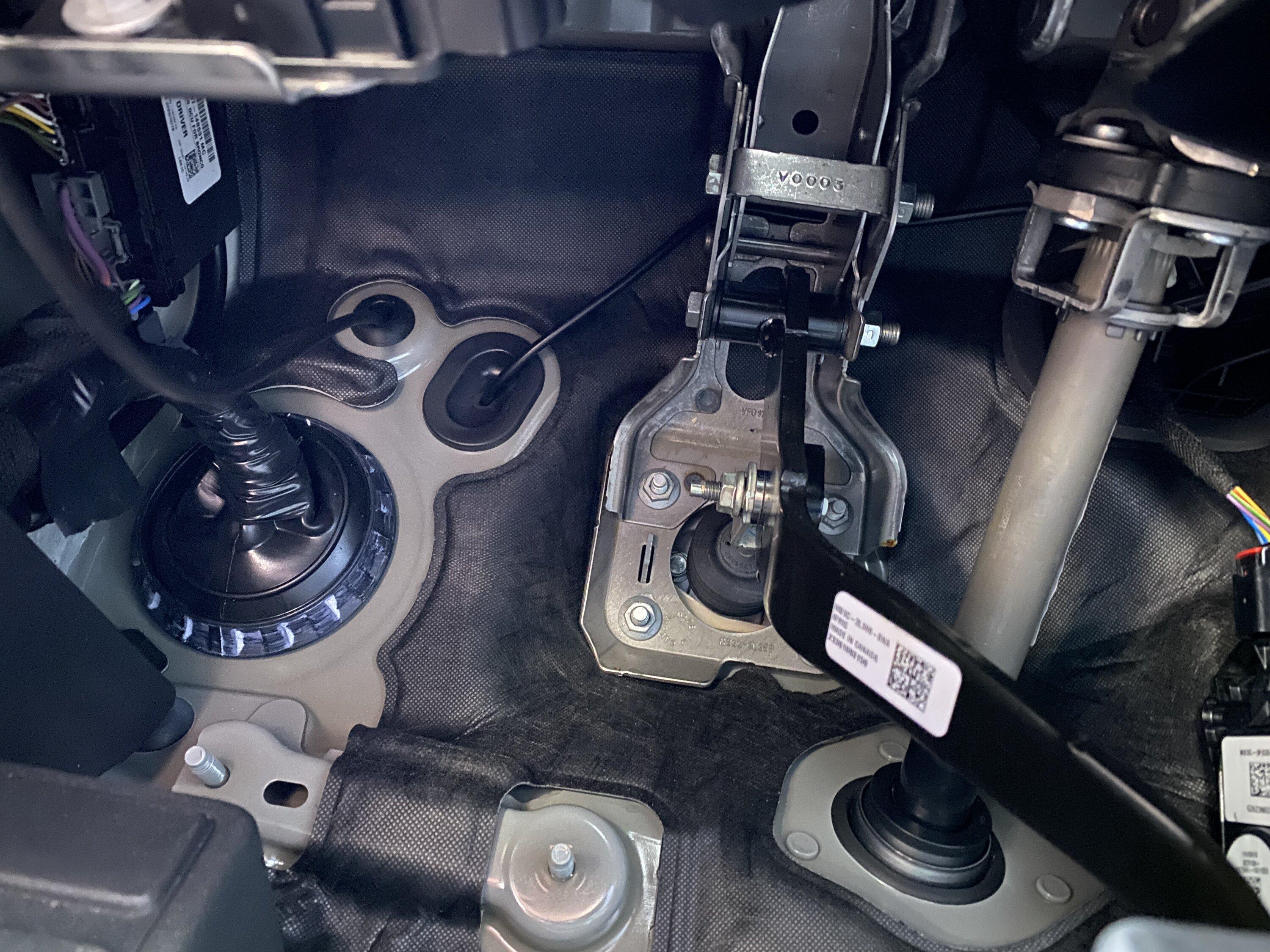

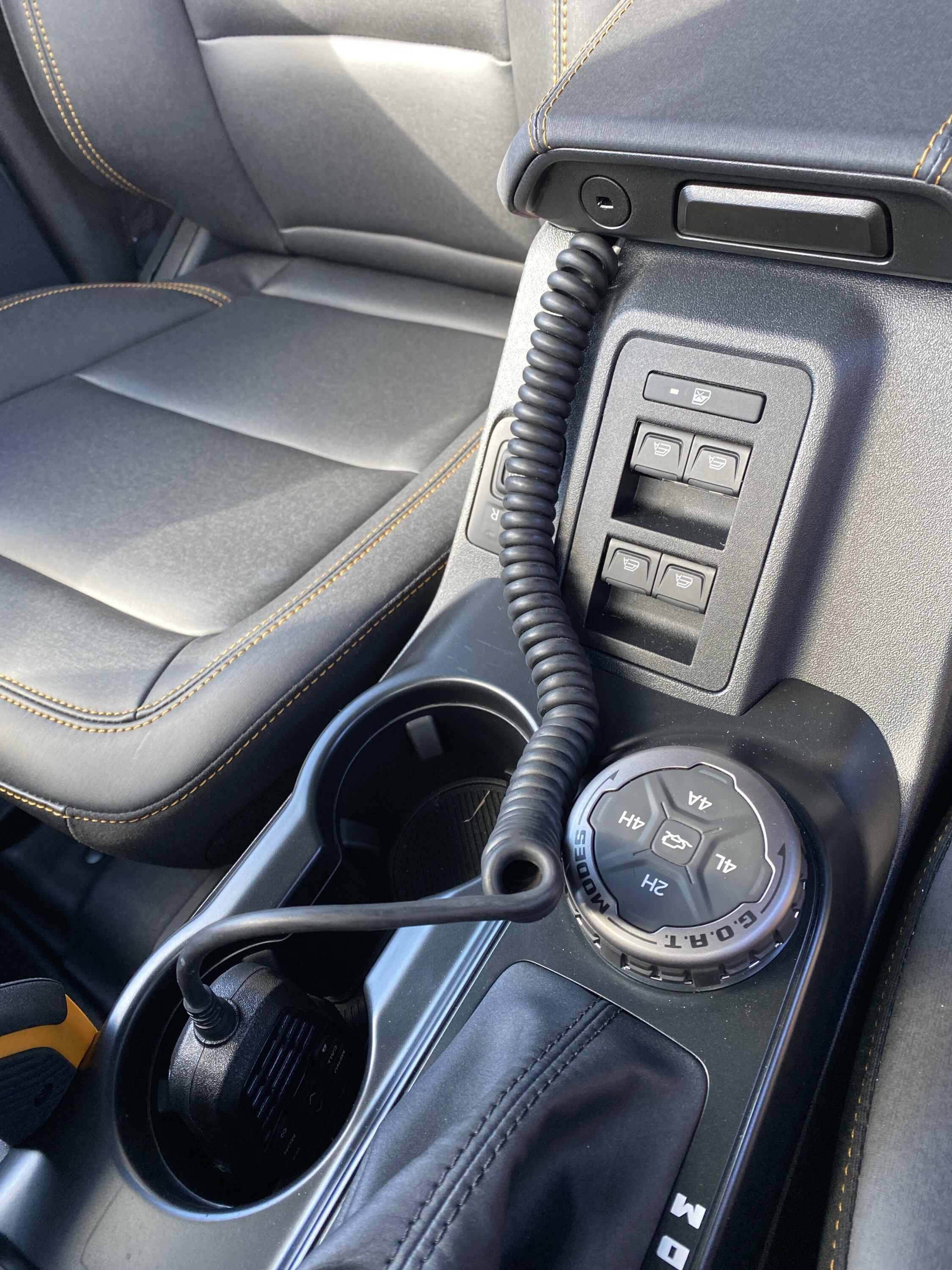

First change from stock. Today I installed a Midland MXT275 radio and a Midland MicroMobile MXTA26 Antenna. Following is my equipment list:
Mountains2Metal Bronco Antenna Mount
Mountains2Metal Under Dash Mount for Amp/Radio
12' CAT6 Patch Cable
Amazon - InstallerParts CAT6 RJ45 Female/Female Feed Thru Coupler
I replaced the 12V outlet in the center console with the RJ45 Coupler and used the patch cable between the radio under the dash to the coupler. The antenna cable was routed through a grommet on the drives side.

I like it,except for the mic in the console. Rolling around with the lid open is just asking for it to get broken somehow.

Getting a mic dash mount for wheeling. This is to keep it out of sight day to day.
Ford Bronco GMRS Install 20240218_180114366_iOS
Hats off to you for a creative install.

Where did you mount the unit? I am not understanding it.
Also do you get any interface with the radio when you talk on the GMRS?
The radio is mounted up under the dash behind the glove box using a Mountains2Metal Under Dash Mount for Amp/Radio. The patch cable is then run from the radio, routed through the center console back to the RJ45 pass through.
