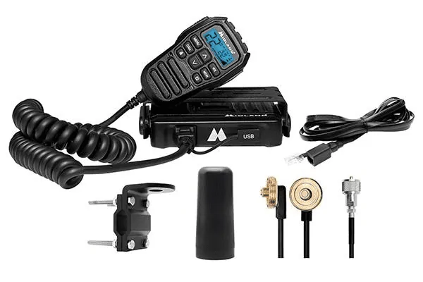

I wanted to buy this but didn't pull trigger and now looks sold out. Do you think this stubby is likely good when not separated by big mountains?
Watch some of NotARubicon YouTube reviews, the guy is a riot and a GMRS god.

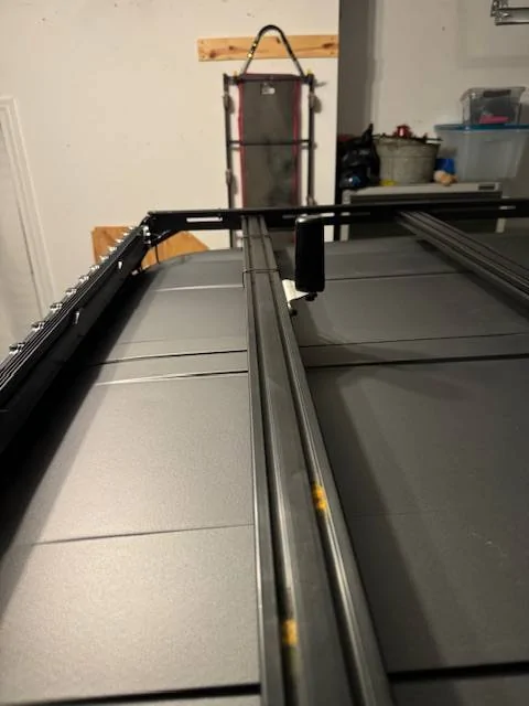

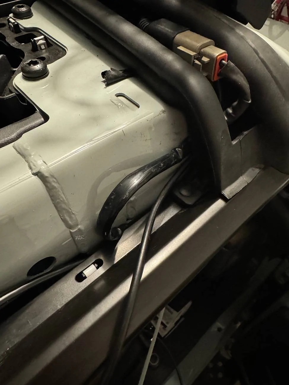

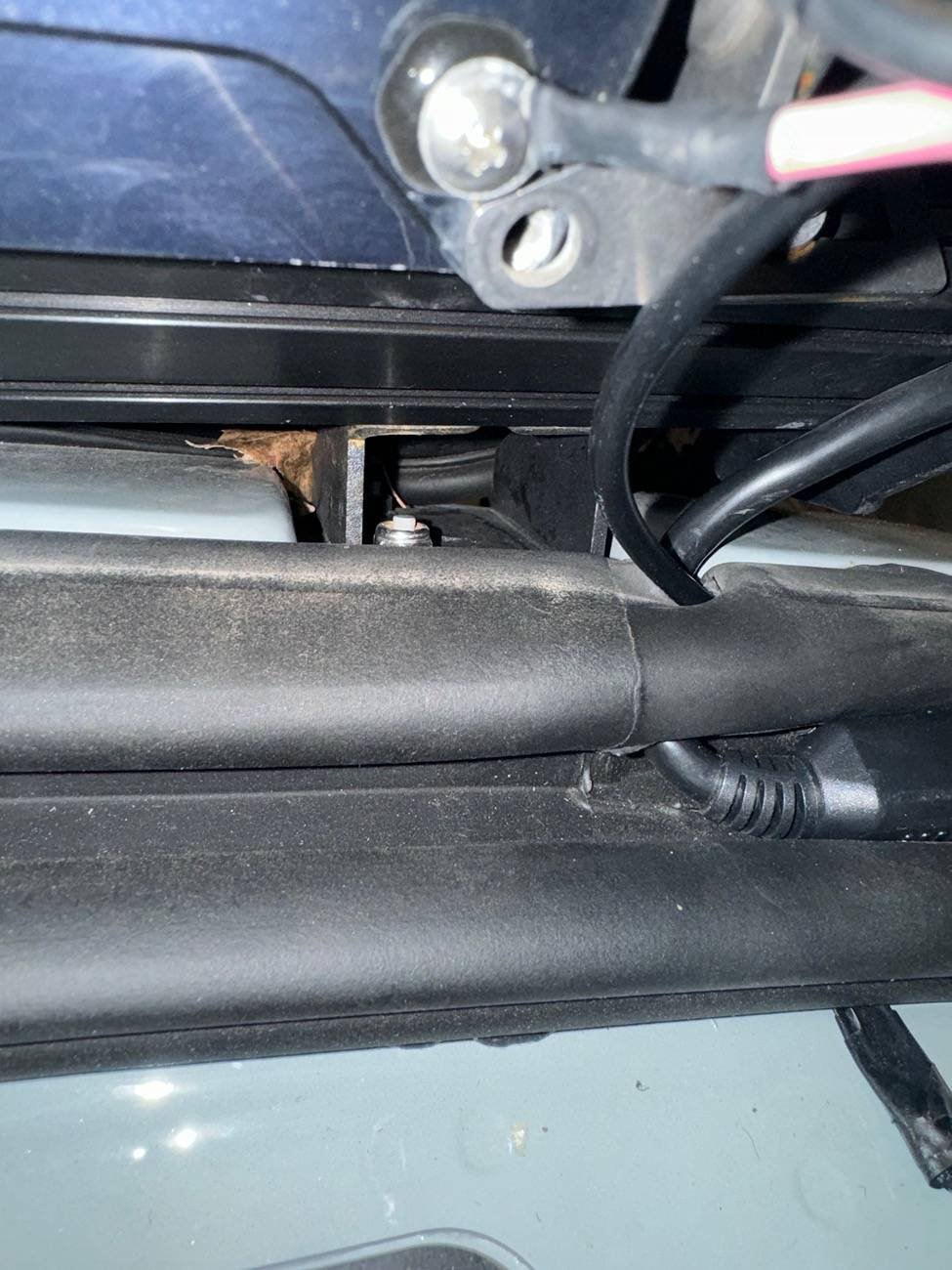

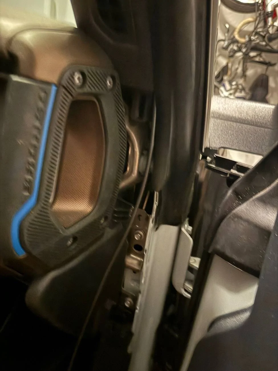

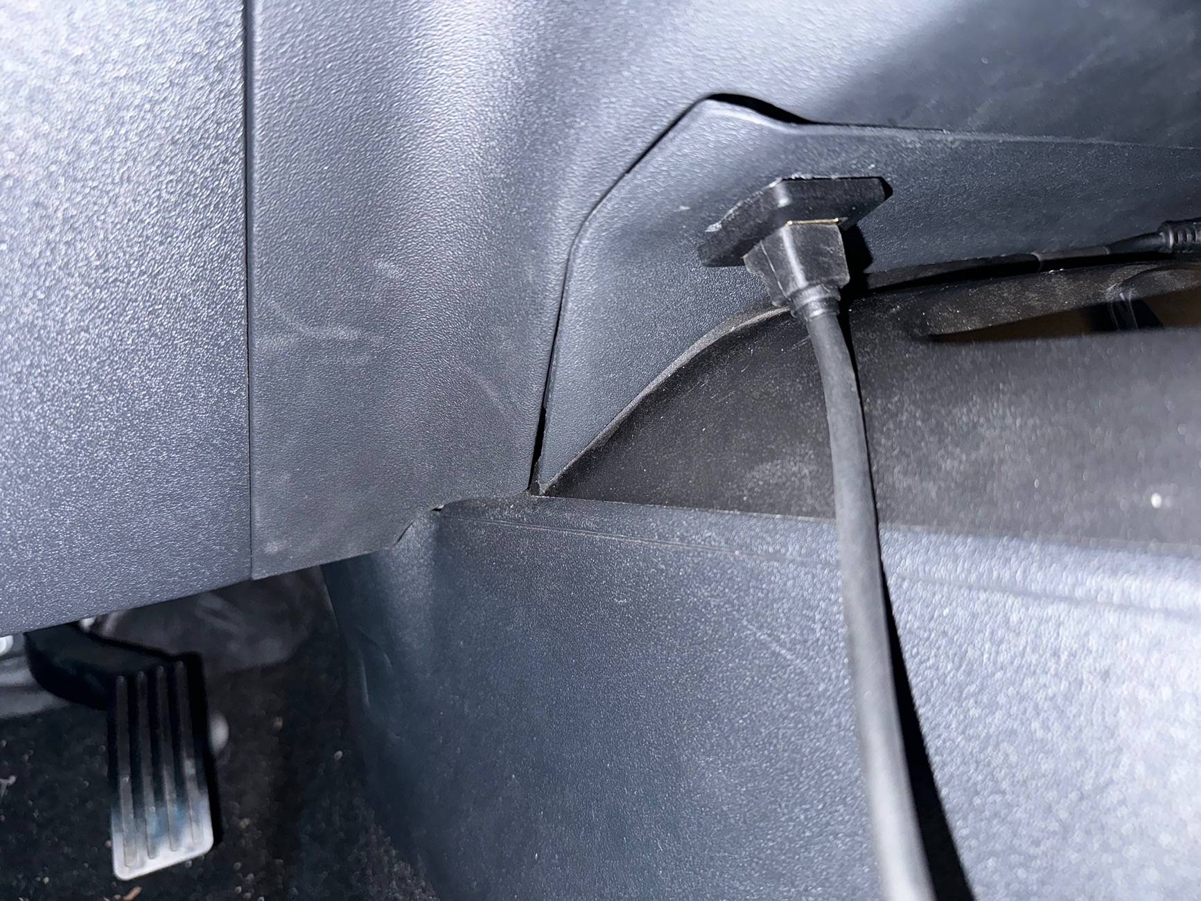

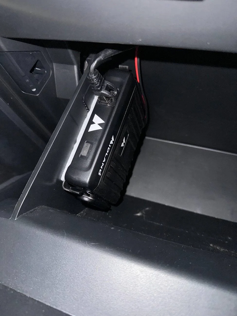

Just thought I’d put this here as I just finished installing my MXT275 and ran the antenna differently than I’ve seen others, utilizing my @TrailRax roof rack. Interior install is similar to what I’ve seen on the blog. Ran power to my switch panel because I had a buttons to spare and didn’t have a fuse tap to run to an ignition fuse. New bulletpoint arm and mic holder should be here tomorrow.
