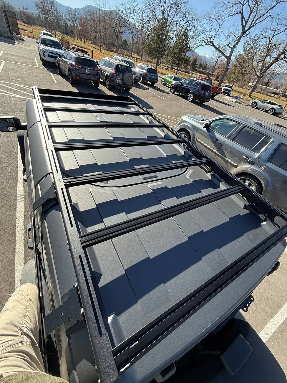

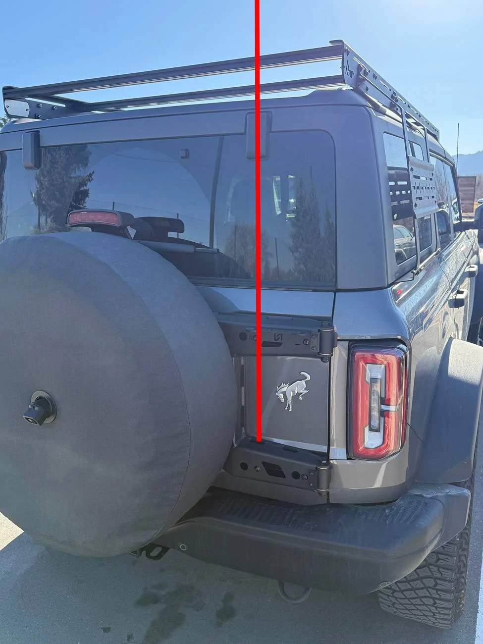

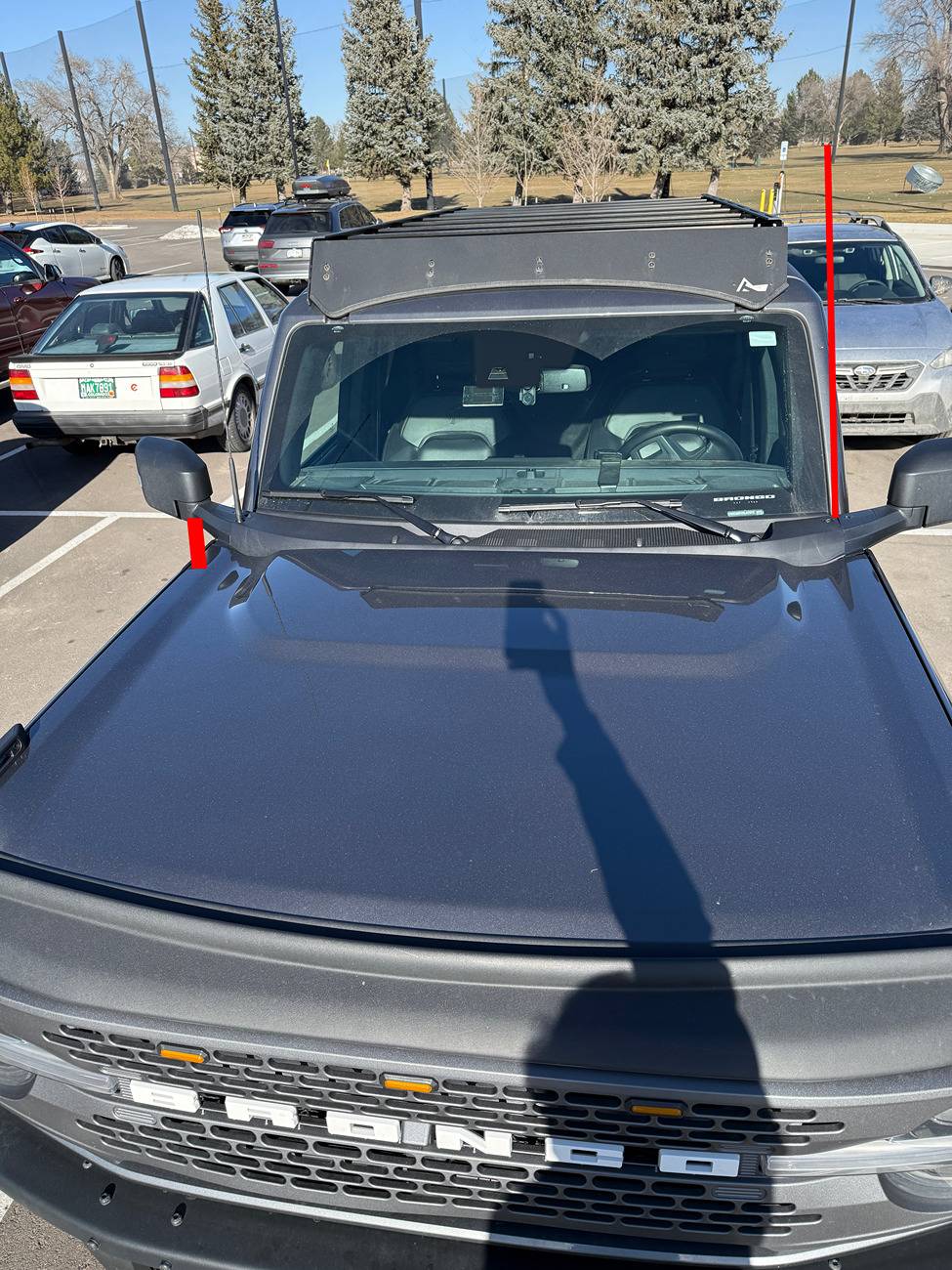

I own a '24 Bronco 4-door Badlands SAS, with a TrailRax Aluminum roof rack installed. I have three questions regarding mounting a GMRS antenna:
1) Best type of antenna for backcountry use (western states)?
2) Best location for mounting antenna given my setup?
3) Best antenna for quick removal when I drive into bad parts of town?

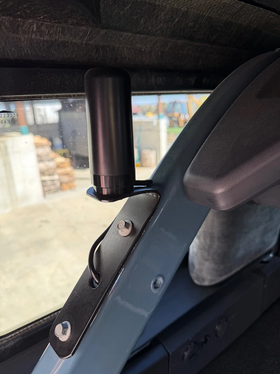

I'm using a 15W Midland and 3db ghost antenna mounted inside on my PVO Traction Board Brackets...can hear and transmit front to back on group rides of 20-25 vehicles pretty spread out trying not to eat dust.
Any antenna with an NMO mounting can be taken off as needed and caps are available to protect threads. I think the most time consuming installs are to the tailgate. Anything mounted on the hood side can easily be pushed through the firewall plug.
