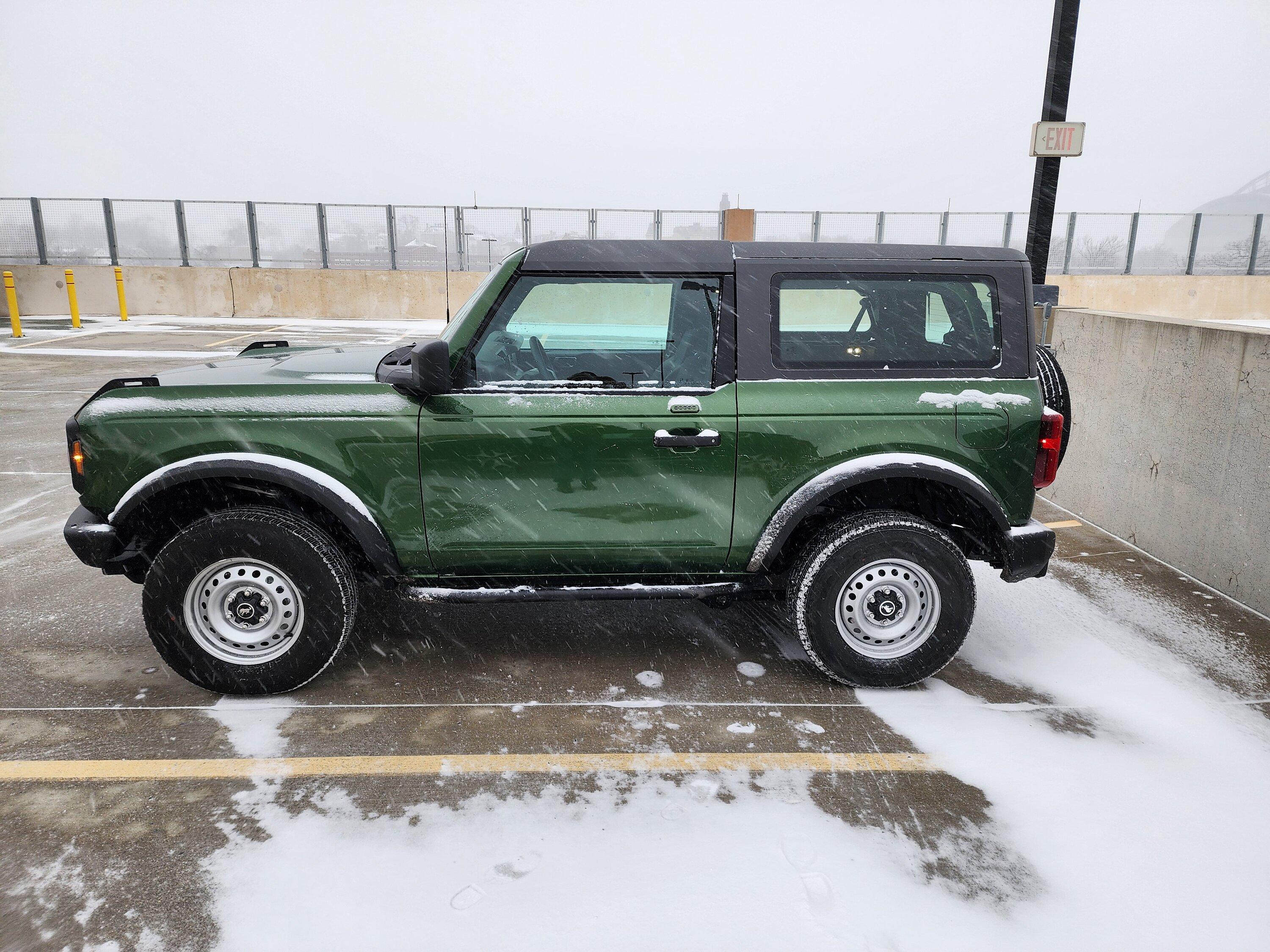

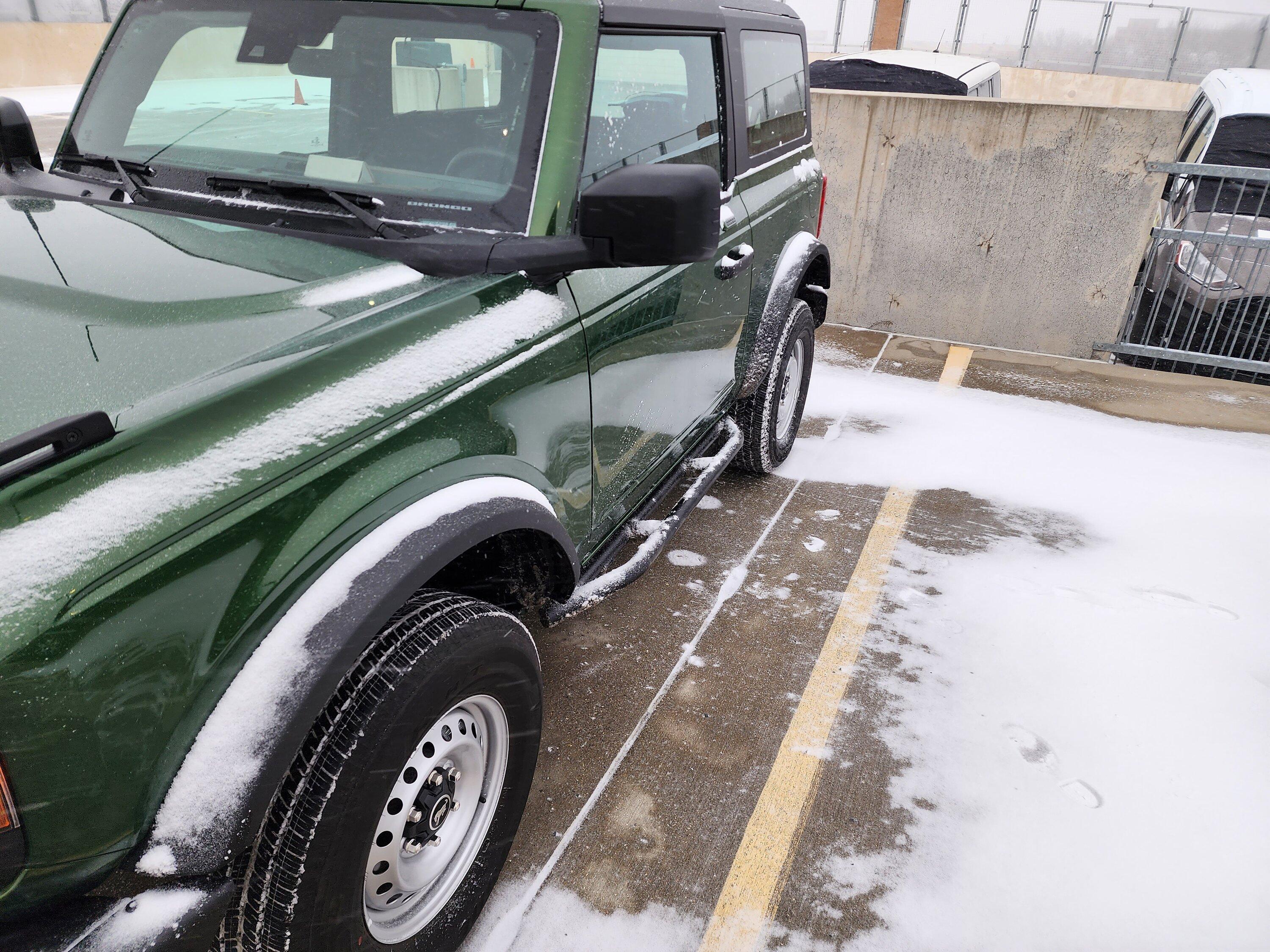

Here are some before and after photos for ya!
