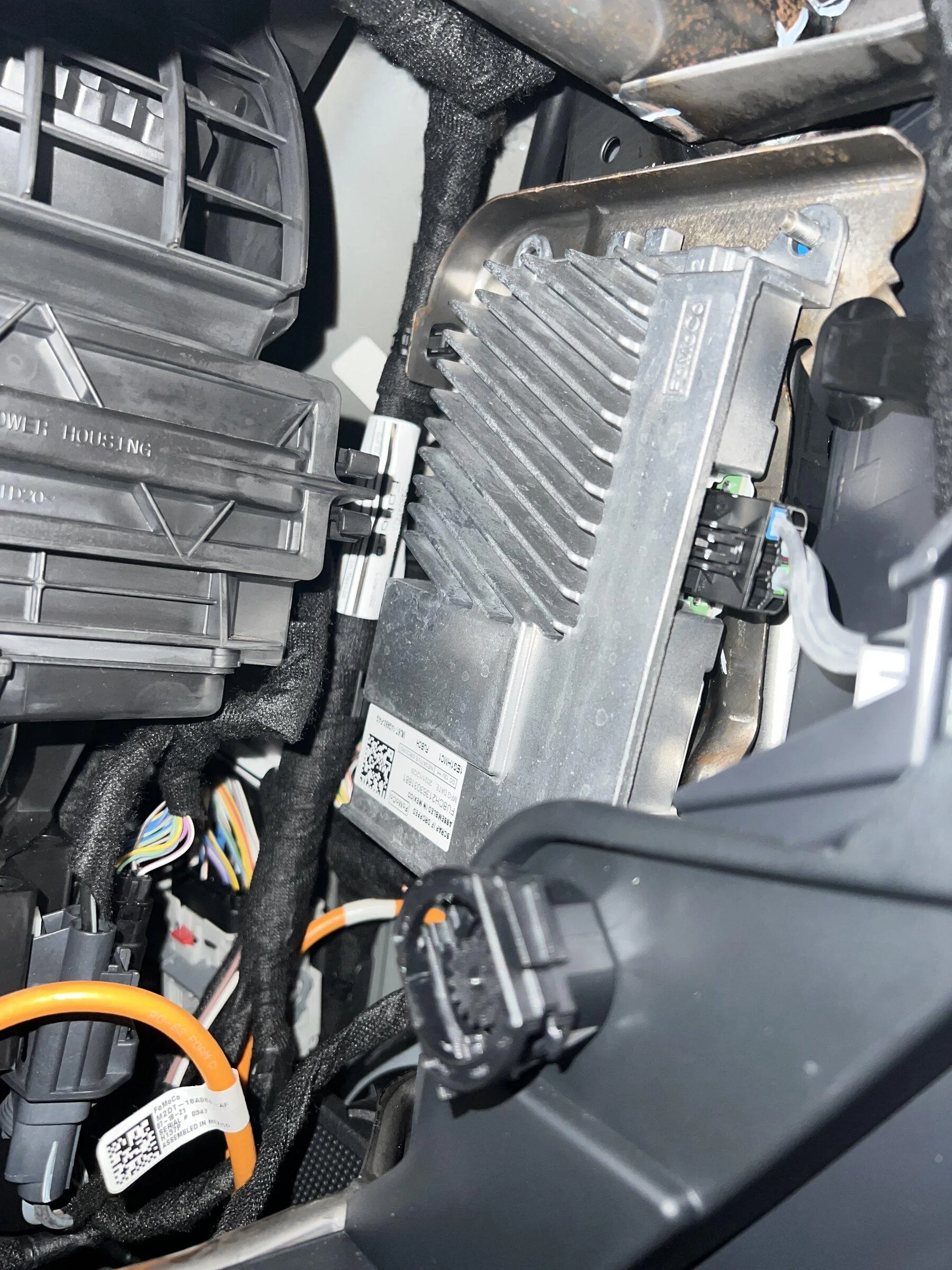

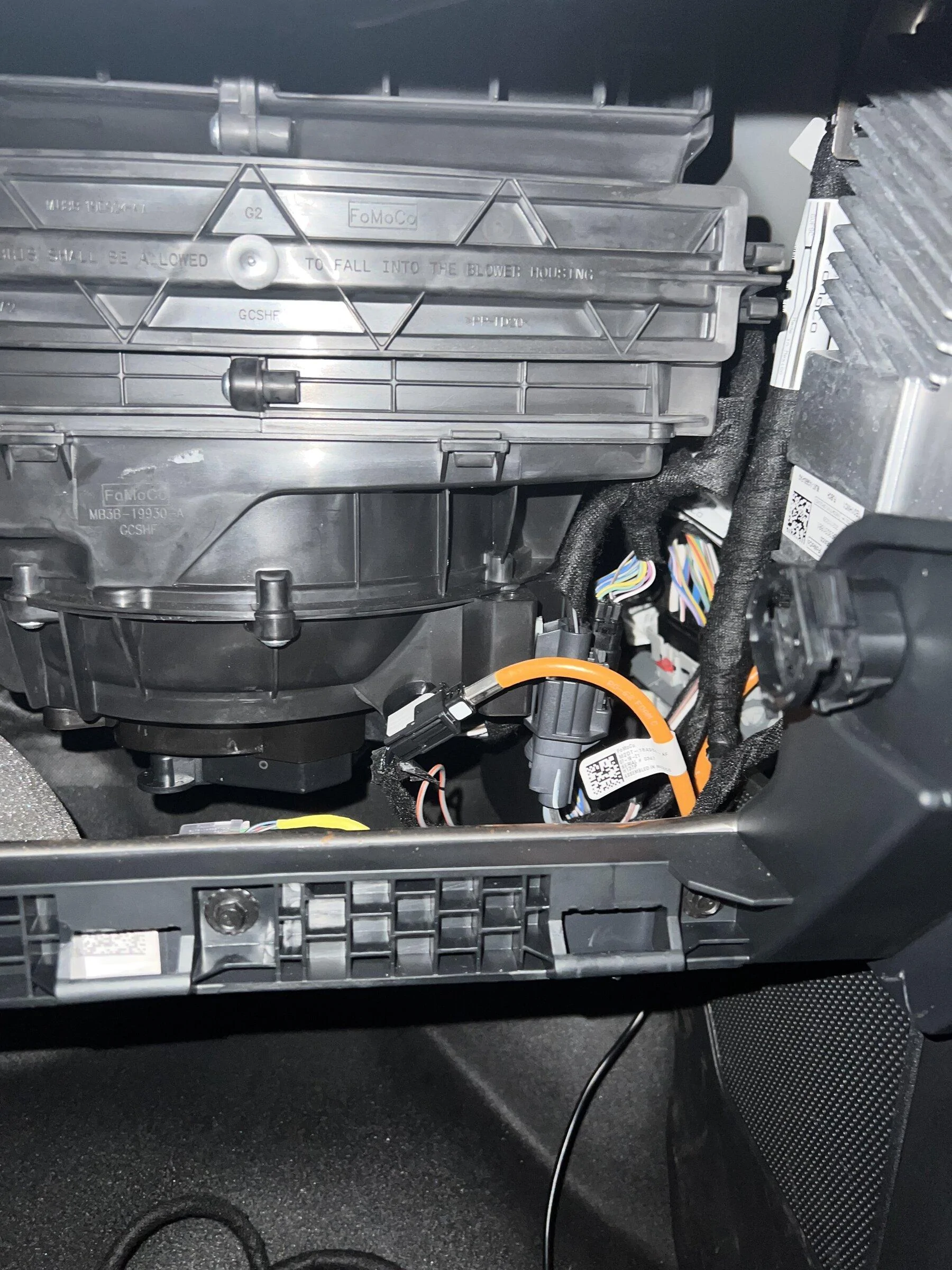

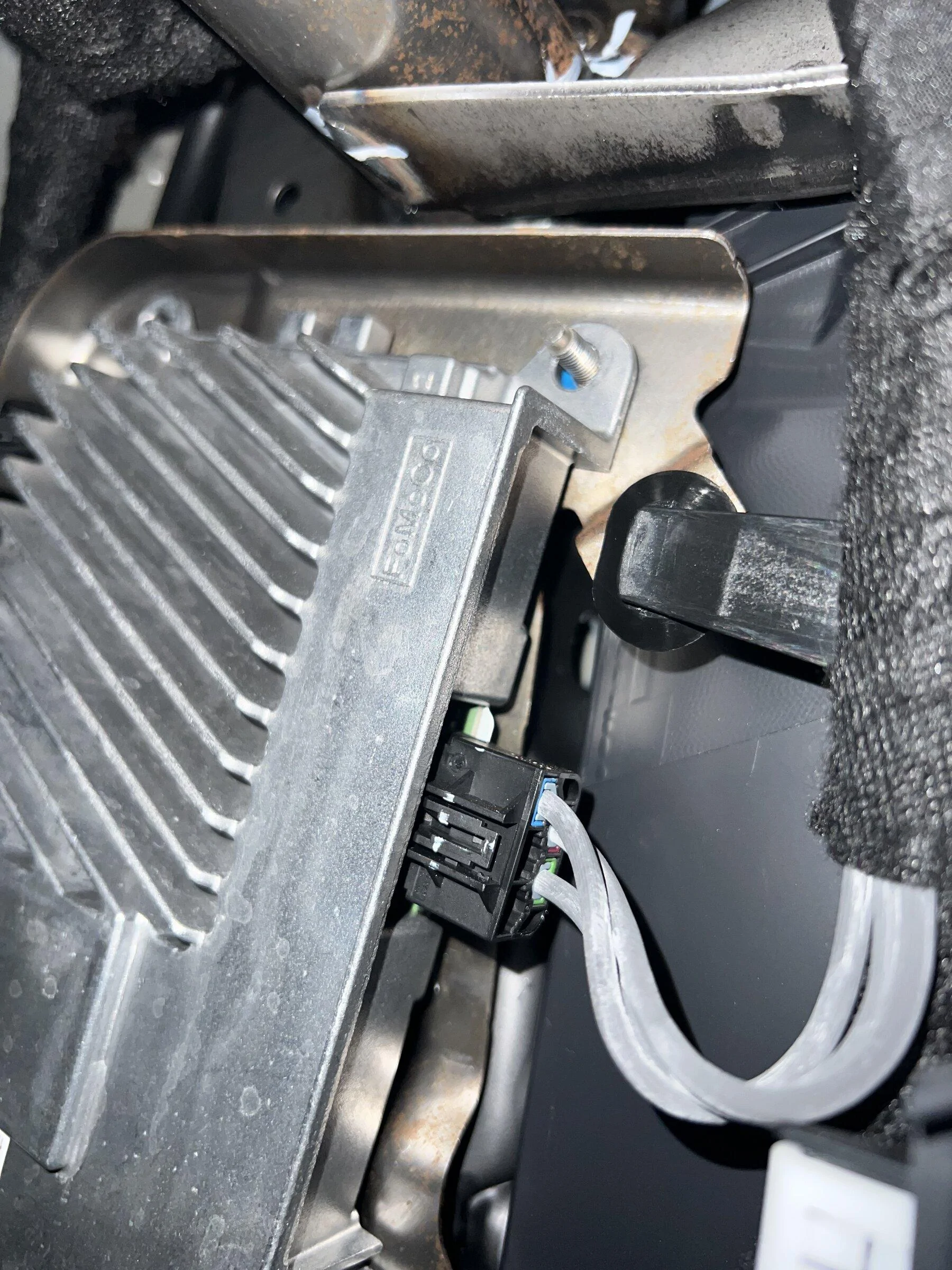

I’m trying to figure out a grounding point for a sub on the passenger side of the bronco, only thing I was able to find so far was this bare metal bolt and was just gonna throw a ring terminal with a nut over it. But I’m not sure if it’s a good idea since it’s holding some kind of electronic. Thoughts? Can we ground things to other electronics?
this is likely a dumb question but I don’t know much about electrical:whistle:

Don't use that bolt.

As long as that stud is mounted to the body it will work for a ground, shouldn’t hurt an electronics some modules are even Case grounded which means they get grounded through the body of the module FYI I am an ASE certified master tech
