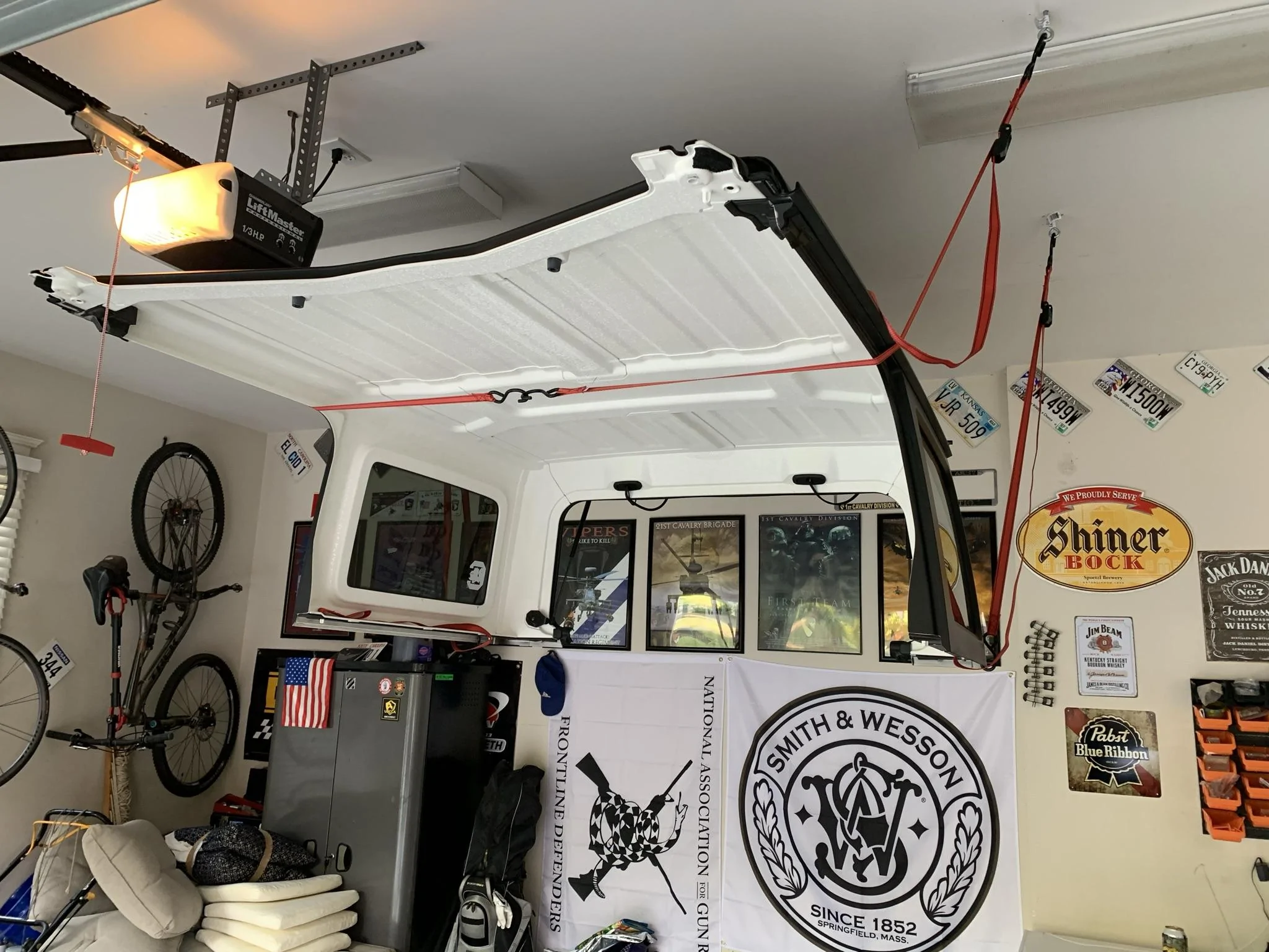

Just installled mine this weekend. $25 all in. 4 eye bolts and 2 ratchet straps ran through pool noodles for the top to rest on. I'll run them front to back with the glass open.

Ford Bronco Hard Top Hoist FFC086D2-D33B-41D6-9F24-194BBF9C2CCA
$20-$25… less than 1 hour start to finish.

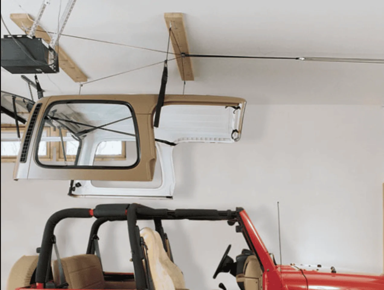

The part that can be trickier is figuring out the actual straps or lift points on the top itself and how to rig it so it stays level... That seems to be what the Harken lift does with cross straps and four smaller pulleys with separate ropes that to the main rope/cable? Might have to play with it a bit...

Harken top cross straps:
