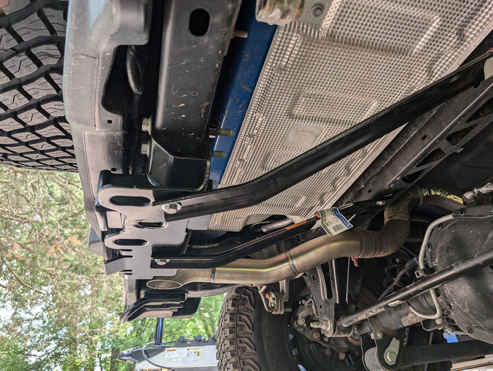

Does anyone have part numbers for the hardware used to attach Raptor hitch braces to the hitch/frame? Assuming something like 4 bolts and 2 c nuts.
II am adding them to my BD in a couple weeks after I switch to a Borla exhaust that puts the muffler ahead of the rear axle (opening the former muffler location for the braces). I already have the raptor hitch installed and the braces are sitting in a box ready to go.

Thanks, I looked at that, the one side may clear the pipe but the other one would defiantly hit the muffler. When they replaced my receiver after the rear end collision, I think they may have installed the Raptor receiver because it's threaded for the braces and I don't remember it being that way but I could be mistaken.
