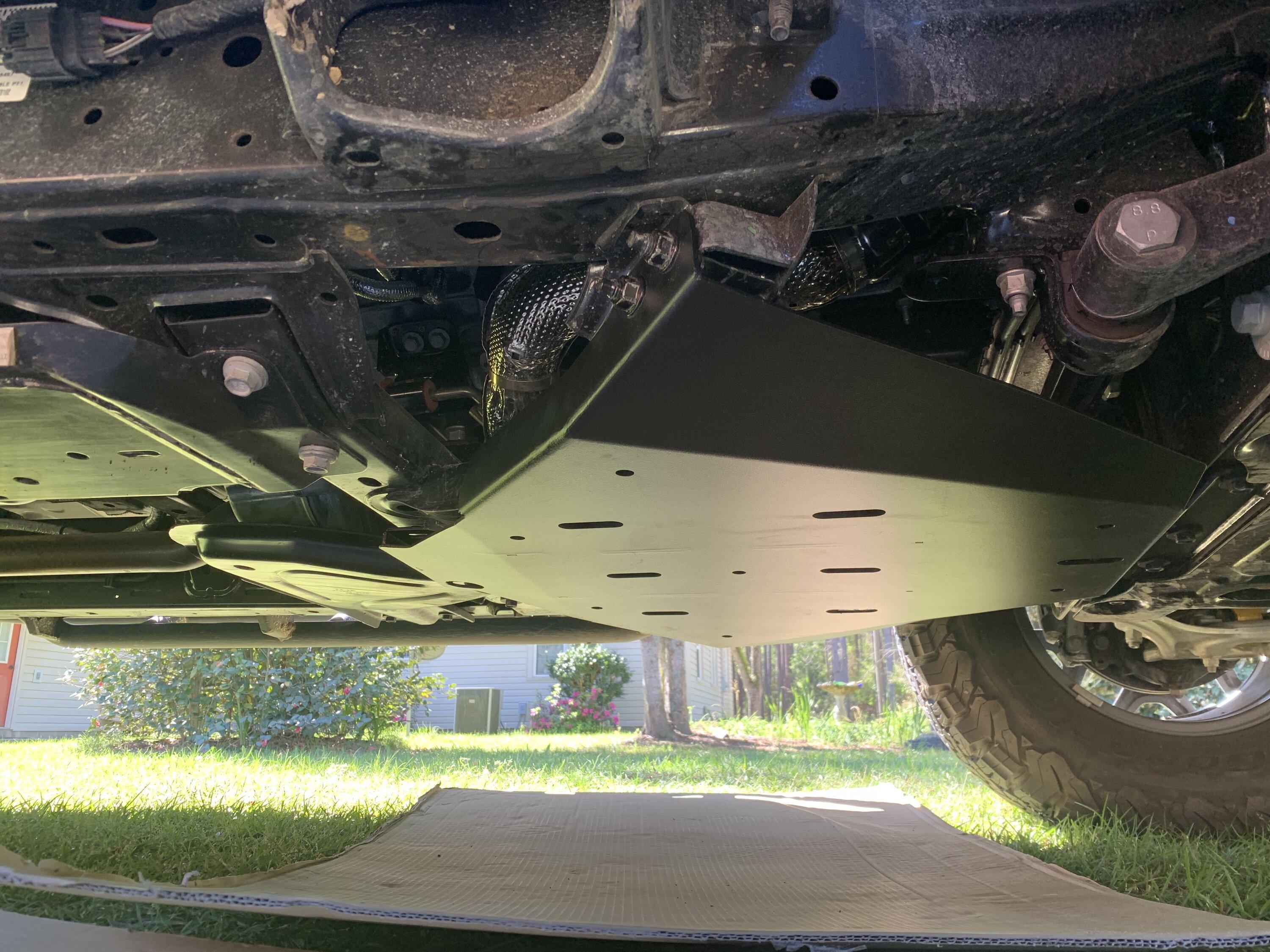

On my badlands I added the LOD trans skid. It covers the transmission cross braces and replaces the sway bar disconnect skid and covers trans. The cross bars were the first things I bent.

I put a transfer brace and trans skid from Asfir and shock skids from Barnes and metal tech sliders
I’ll see how they all do in Moab
