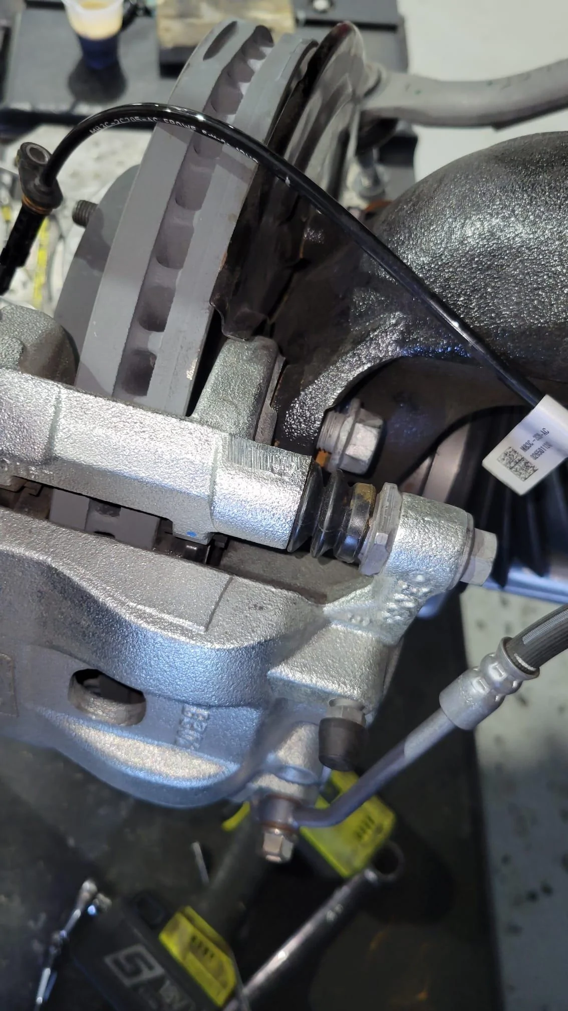

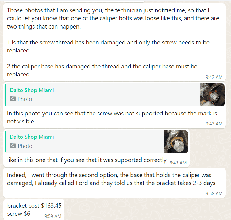

Hey guys, not sure how to approach this, any help would be much appreciated. I have my Wildtrak in the shop right now getting perch collars installed. The shop messaged me the following:

The wheels and tires were installed two weeks ago. I picked up the vehicle less than two months ago, there are currently 745 miles on the vehicle. I am unsure how to proceed with this. I do have the bumper to bumper warranty. Thank you all for any input.
Edit: The driver front side is the area in question

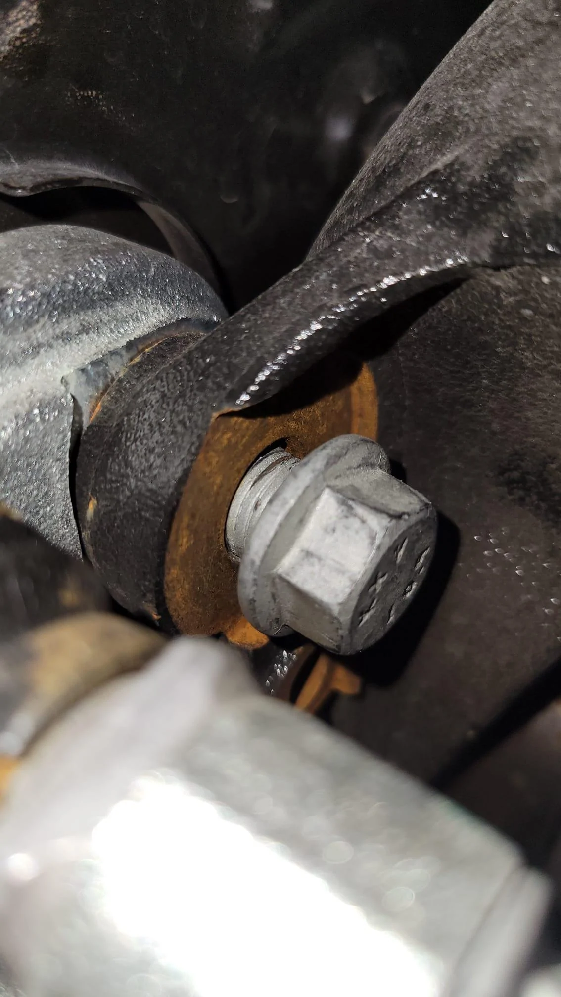

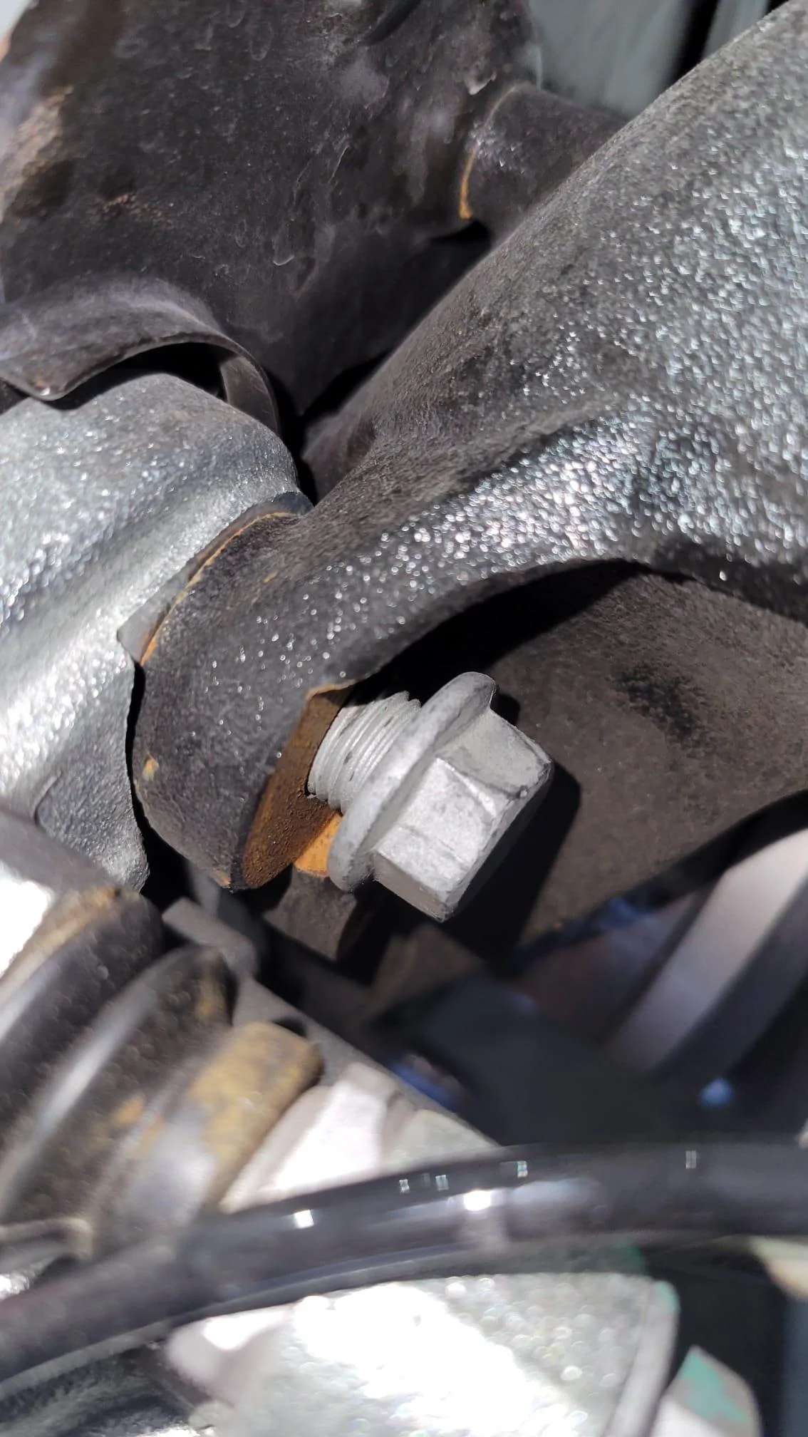

So who took the bolt out is the question. Option 1, the bolt was never installed correctly when it left the factory and the selling dealer didn't notice it. Option 2, wheel and tire installer took it out for whatever reason and didn't reinstall it correctly. Option 3, you did it and not fessing up (kidding).
Based on the amount of rust where the bolt shoulder should be, my guess would be option 1 or option 1.5 which the bolt was not completely backed out when the dealer did the PDI and did so over the course of you driving it.
Did they say if there was any factory loc-tite on the bolt? Either way, I'd have them throw a new bolt in the support and ask them to check torque on the others. Surprised the tire shop didn't see it when they did their thing.

*edit: I think $170 is just parts, I hope it's including everything.

Thank you very much for your input. The wheels and tires were installed at Discount Tire, and done right in front of me. They didn't touch any other bolts from what I saw unless something slipped my sight while I was staring at my new wheels.
I will ask the shop to throw a new bolt in there, hopefully it's something easily done. I will ask about the loc-tite. Do you think the "damaged caliper base" will allow a new bolt? Reaching out to them now.

I received this in response:
"The problem is not the bolt, since when assembling the bolt they placed it on its side and inside the thread at the base of the caliper is damaged, that is why the screw does not fit anymore."
What the hell does that even mean? If that's the case it was a factory defect and should be covered.
