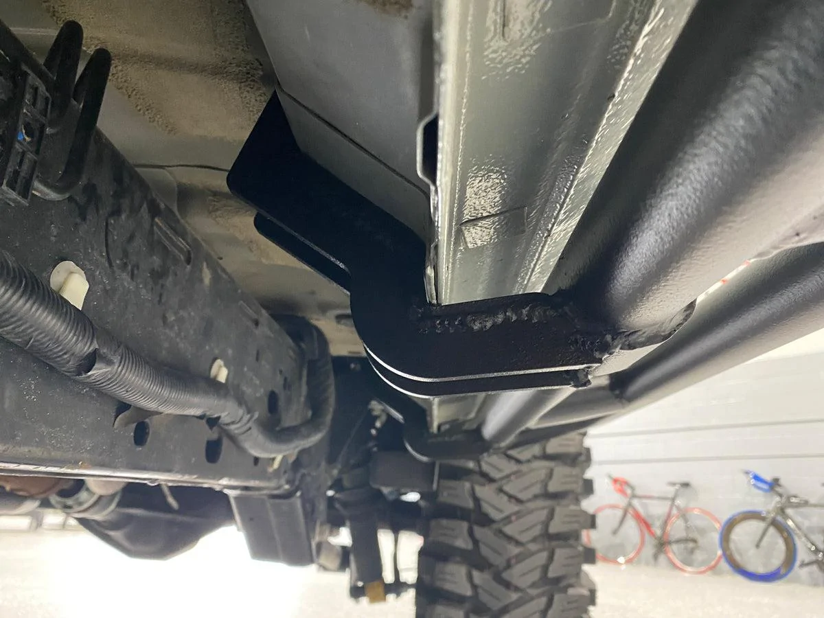

The photos on their site...some of the worst welding I've seen to date. Here's one...
Are those GoatFab or Expedition One?

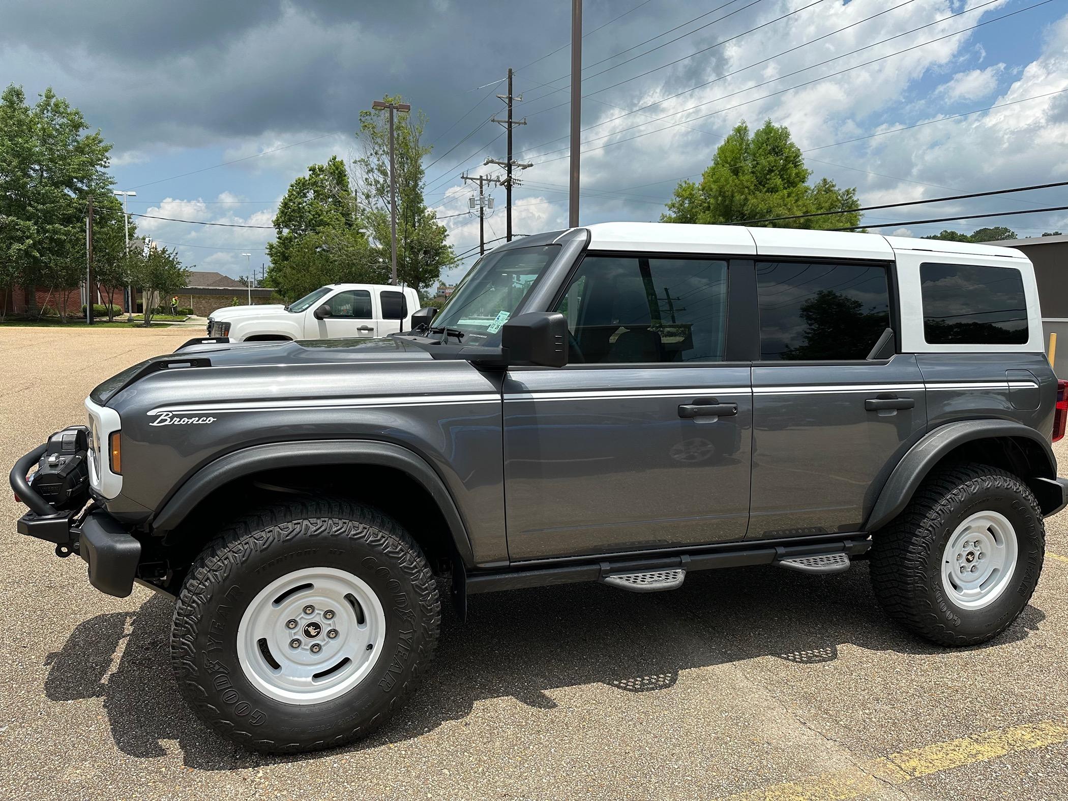

Build update:
  • 1” RC level kit added - The stance seems correct now with ever so slight rake.
  • Modular bumper air dams removed - It looks better that way.
  • 2nd steps added at request of my 3yr old “Where is my step Daddy?” - I bought as a set of 4 but never put second on until he got opinionated and whats to be like me in everything.
  • 2nd OEM tow eye add in rear. - A used item at low cost from Bronco Outfitters in Houston shipped to my house.

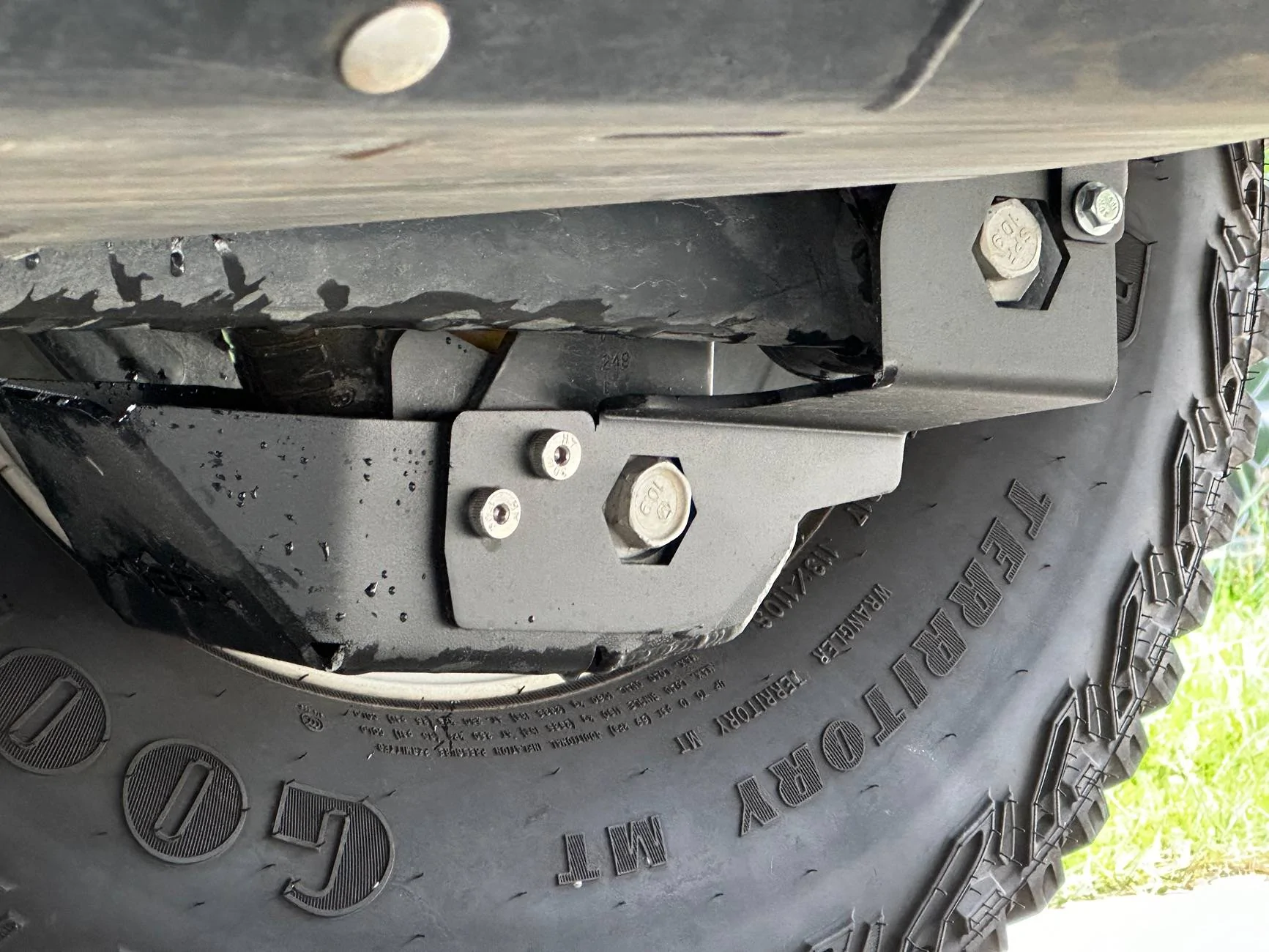

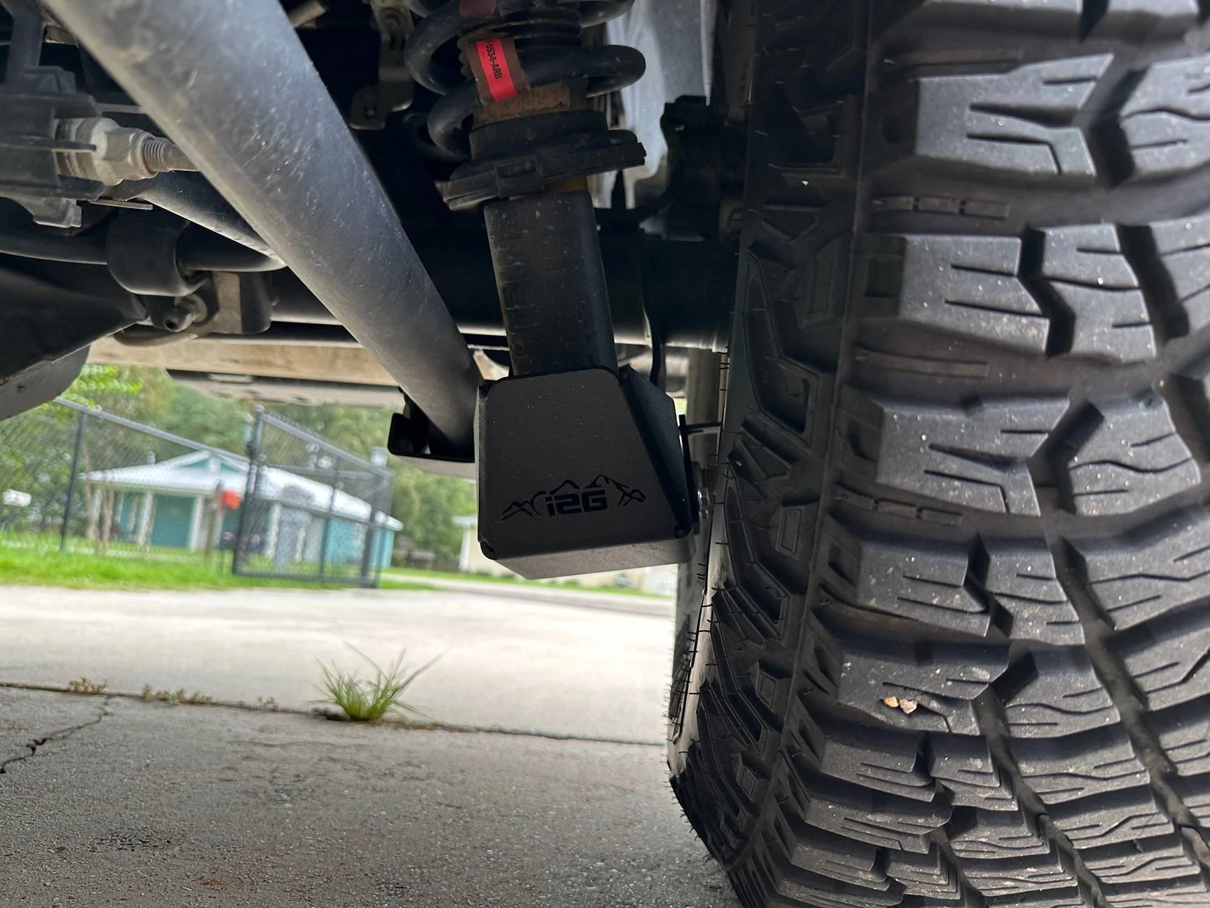

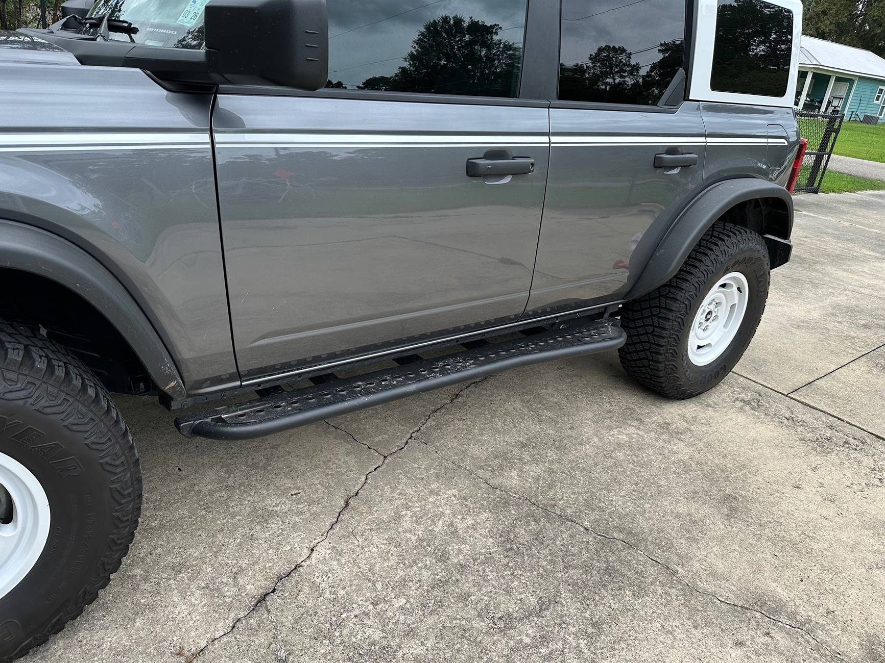

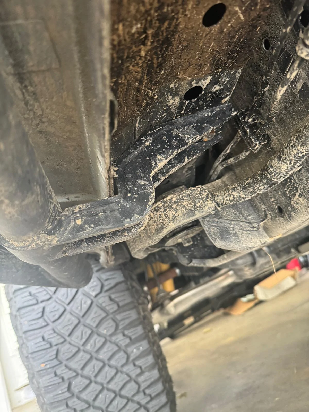

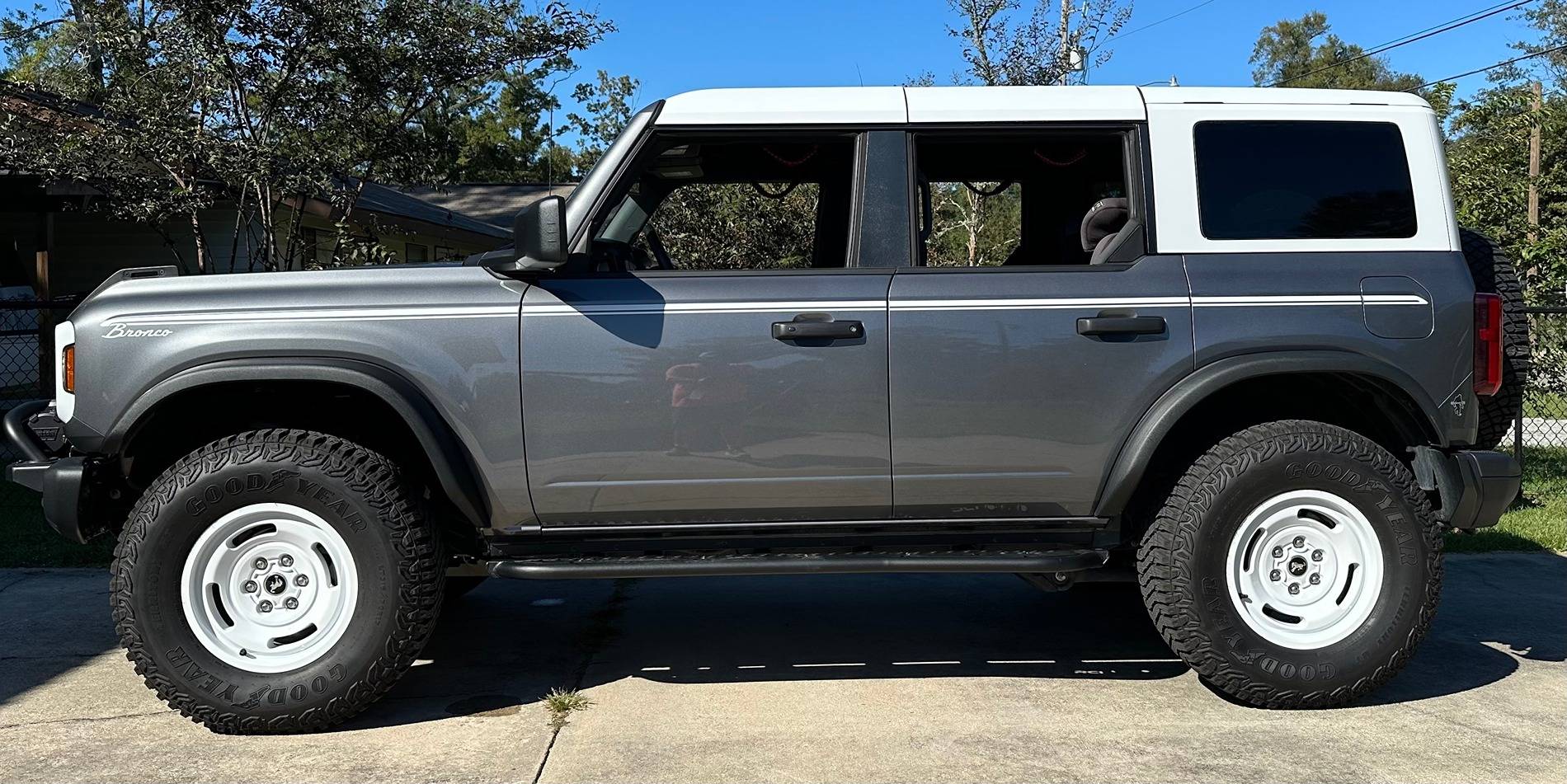

RCI sliders and IAG shock mount skid plates installed. There was some minor shipping damaged to slider power coat and to avoid another 8 week wait we used some can coating on the spots. RCI is sending the pinch weld cover complementary for my trouble and understanding. Yes they are already dirty.

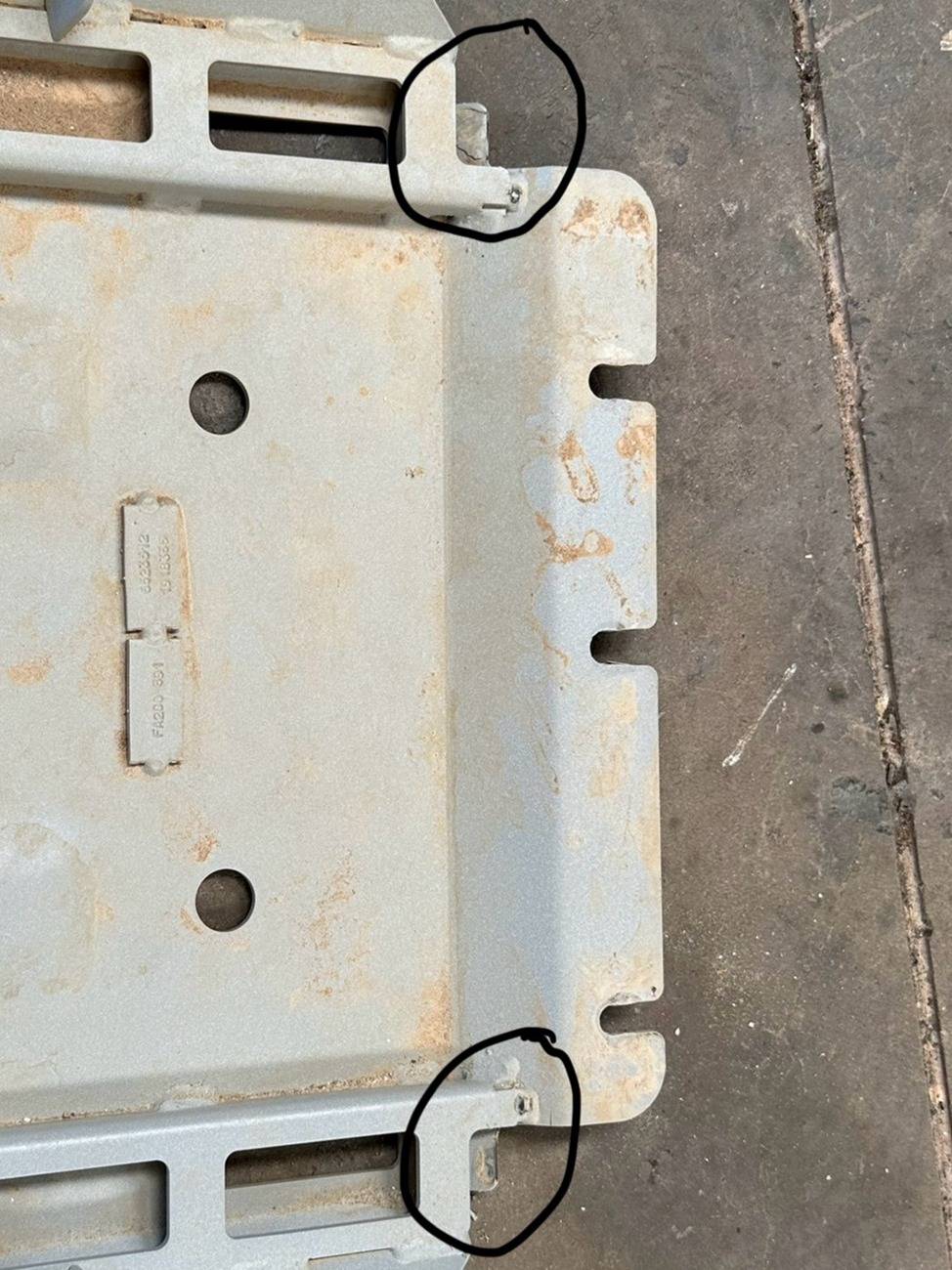

How are those ARB skids holding up?
sts90
sts90
Theo
Feb 20, 2024
60
107
Louisiana
Bronco Heritage
The ARB skids are holding up well. However if you have the 2.3L you will need do some fiting to prevent a growning sound where they contact the frame(image below with circled areas). I called ARB USA and confirmed these were designed for both models but only tested for fit on the 2.7L which as the additional cross members. They are execllent on draining mud/water and under carrage ventilation which is my objective considering the location of transmission cool on 2.3L.

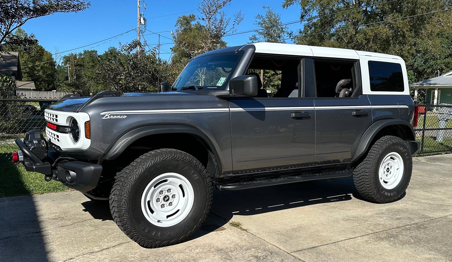

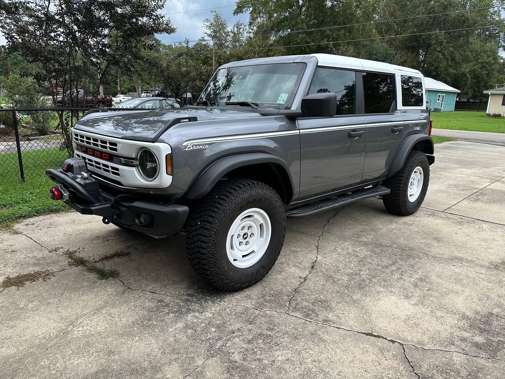

Status Update:
RCI pinch weld covers added. It does make it look better.
I believe the next items will be a Bumpers. I am considering the following, any input would be great.
  • Front bumper :
    • 70% set on Icon winch bumper as it tucks up everthing but will have mount my fog lights.
    • ADD Krawler Front Bumper but gosh that price.
  • Rear brumper:
    • 90% set on the Expidition One as it transfers the rear tire weight to frame but will need a license plate solution.
    • ADD Bomber Rear but will need to reinforce tail gate and license plate solution.
I can't find any true heritage style ones for or I would go that way. Thanks for reading.
