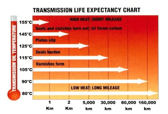

^^^^ This is the best infographic that I have found.
I personally am uncomfortable with a transmission staying above 220f, peaking at 220f or so is fine, but staying at 220f or above is too hot.
Most transmissions are designed to operate at 195F for optimum performance and longevity, too cold and you will actually decrease performance and life expectancy.
I saw Ford says 206-215f, which seems a bit high, maybe that is a CYA. I have never noticed my trans going over 200f in day to day driving with 100f weather.
If you consistently see above 220f when wheeling, I would add a secondary transmission cooler, like a universal Hayden.
Ignore the lubeguard crap, but most transmissions are designed to operate at 195F for optimum performance and longevity, too cold and you will actually decrease performance and life expectancy.

A quick search online shows that this range appears to be completely normal for Ford 10-speeds, but who knows. I’ve seen mine anywhere from 190-205ish during normal operation
This is correct, supposedly the fluid and trans are designed for 200+ temps in normal driving and higher when working hard. I wouldn't worry about it too much unless you see it get over 230 and maybe consider changing the trans fluid before the 150k recommended interval.
