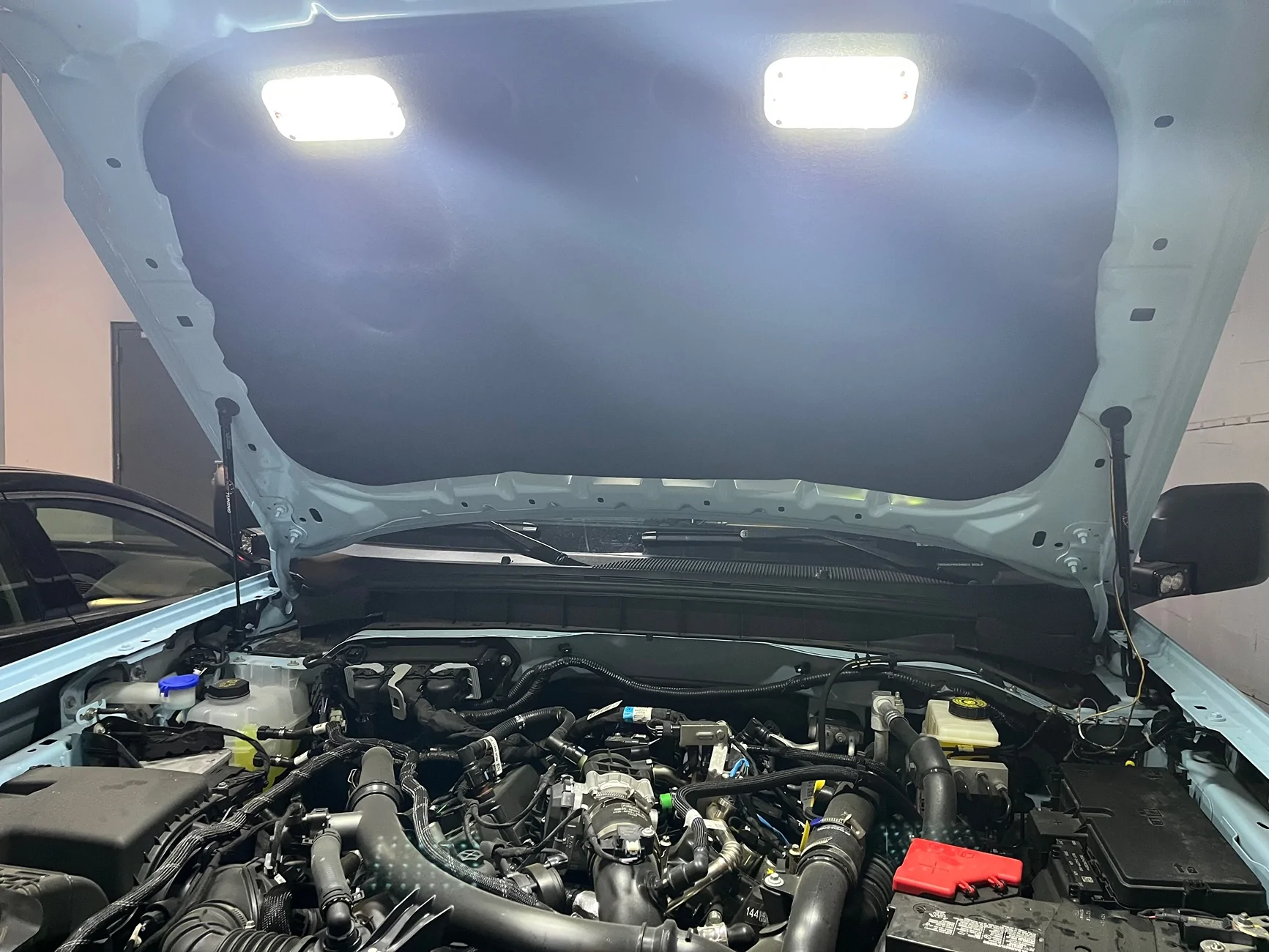

I wanted to add some under-hood lights but didn’t like many options on Amazon or ARB (spendy)
I found some 12v LED rv lights for $10 and used some wire and connectors I had laying around.
https://a.co/d/1N6BaXX
I used stainless hardware with a washer on the back side to mount the lights to the the hood insulation.
I wired it to one of my overhead aux switches- I know it will only work when accessories are on, but I didn’t want to direct wire or use a switch to detect when open.
Ford Bronco Hood lighting DIY IMG_3827

Nifty lighting upgrade! 👌🏻
