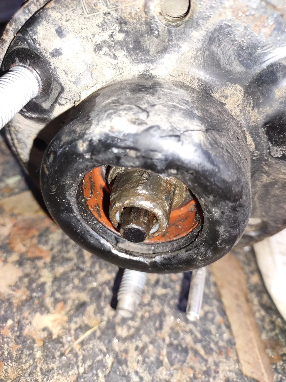

Ford Bronco How do I remove the strut top hat? IMG_20251021_151221487

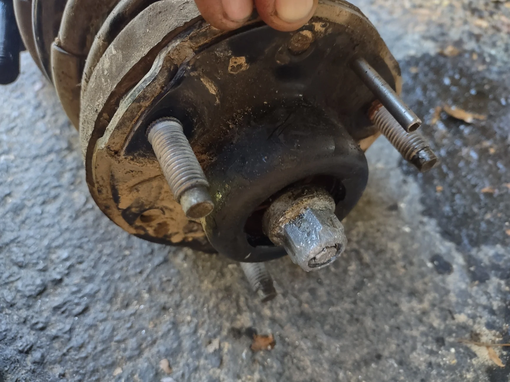

Ford Bronco How do I remove the strut top hat? IMG_20251021_141330227

Well I hated feeling like a quitter, and didn't feel comfortable knowing that nut was 3/4 of the way off after I reinstalled it. So I tried again.
First was vice grips on the shaft.
Then vice grips on the shaft and my uncle's high torque impact.

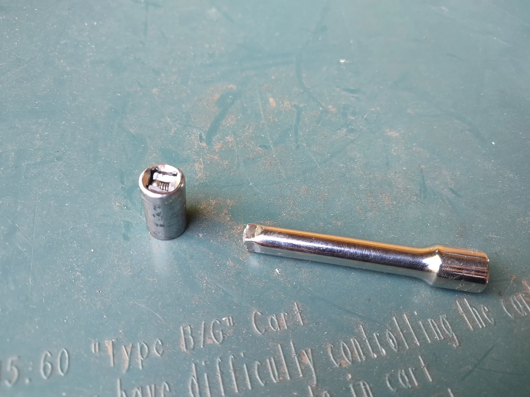

Then a series of dremel, punches, chisels, etc.
Ford Bronco How do I remove the strut top hat? IMG_20251023_145353752_HDR

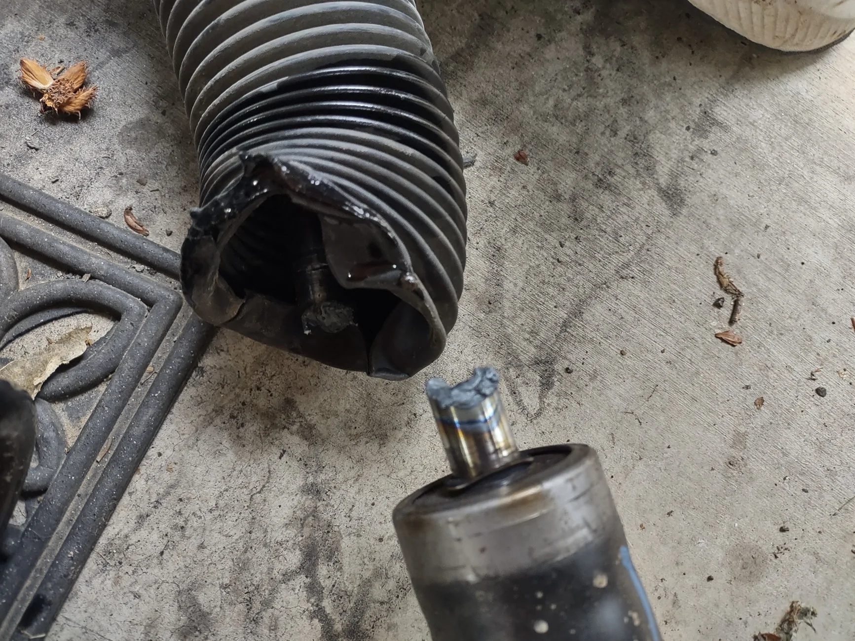

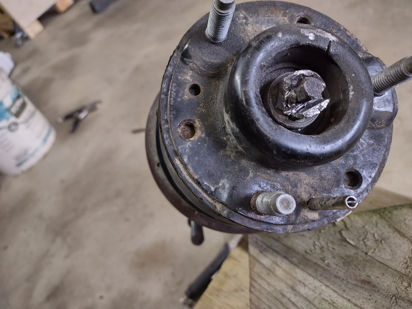

Literally nothing worked. About to give up but figured it's already ruined let's drill/drain the shock body and cut the shaft.
Ford Bronco How do I remove the strut top hat? IMG_20251023_153821476_HDR
Success. All this heartache for one stupid tophat! And if it wasn't recessed like that it would have never been an issue lol. So...one corner is done!

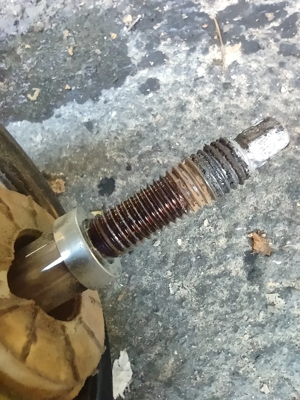

Success on the second one, but it was still a PITA. I had to pick mud and crud out of that recessed cup the nut sits in. So everything was pretty rusty. Used a brush to clean everything and the threads and put anti-sieze on the visible threads in hopes to lubricate it's journey up.
The initial movement of the nut took a LOT of force. Then it was pretty easy to move, I went 2 steps forward one step back the whole way.
The PROBLEM though, is by the end you're still on the threads and you completely run out of post to grab?! What kind of idiot design is this? I much prefer the kind where you put a hex key down into the post, you won't run out of depth there. However, vice grips on the shaft did grip enough to get it off. Phew.
Also realized I'm an idiot and if I compressed the spring even more I can expose the whole nut....so we could have more easily cut that nut off the first one. Doh.
Ford Bronco How do I remove the strut top hat? IMG_20251024_112530119
Ford Bronco How do I remove the strut top hat? IMG_20251024_112351506_HDR
