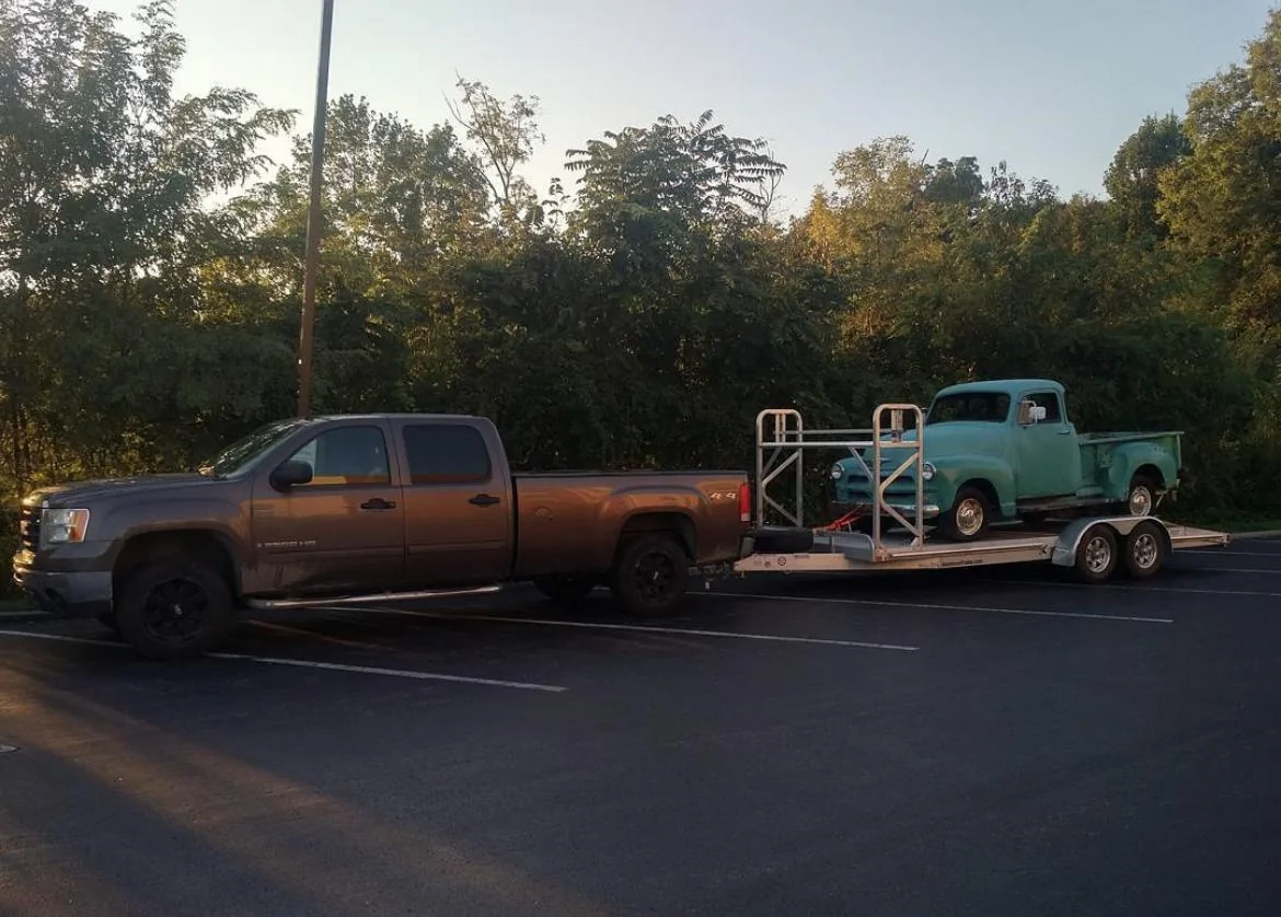

The trailer weighs like 1503 pounds. Just enough that it needs a yearly inspection with the Quebec government. And I like to always weigh on the safe side so I added 3000 pounds for the car with fluids etc. The trailer is very light for a size, but it still has a 22 foot deck. Hooked up to the Sierra, the whole rig is seriously long! For fun, and especially for perspective, see photo below. That’s a 1954 Chevy 3100 for scale.
