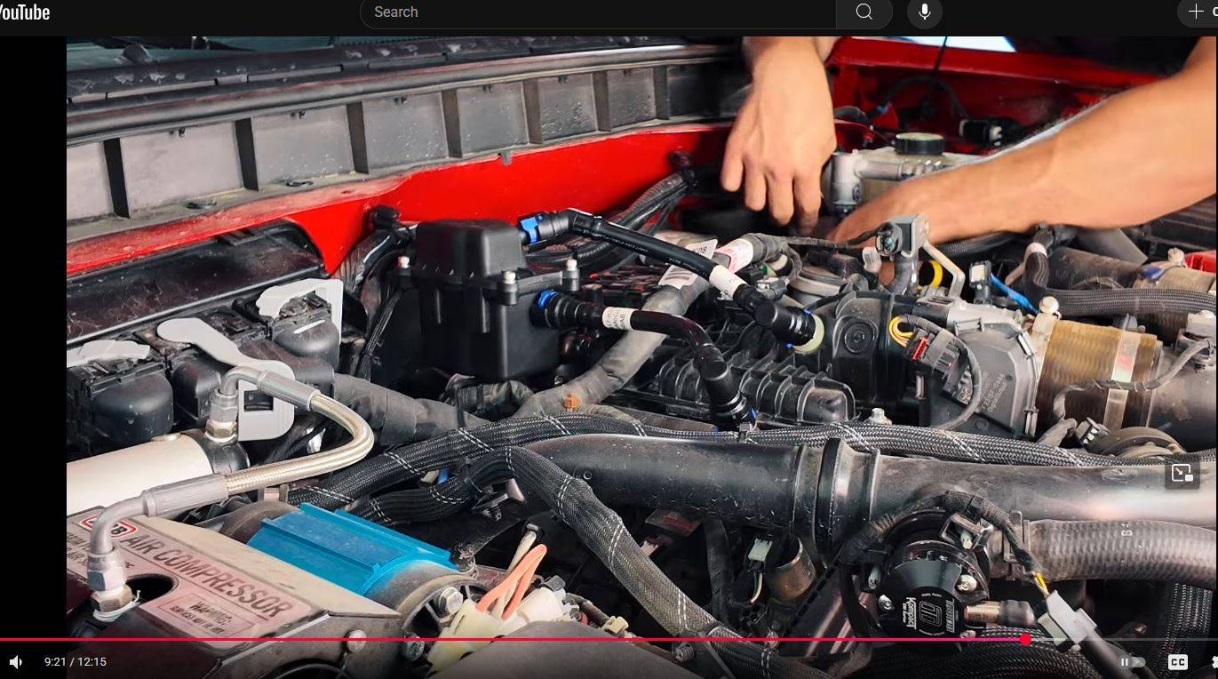

Here's from when I installed mine. Note the height of the pass side separator. It actually sits more in the center of the engine at the firewall, and the driver side is down low near where you'd find a brake booster.
Ford Bronco IAG catch can system 20241016_185200%20copy-X4
Now look at the height of the FP separator on a 2.7. Similar location and the higher of the two for that application but still well below those on the Raptor.
