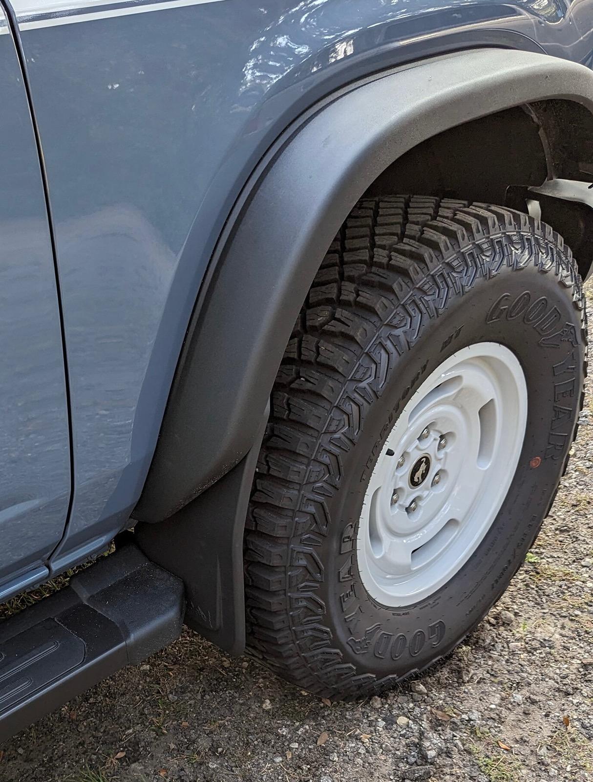

I have the IAG flaps on my HE so yes, they fit. Try their video for install:
Someone should chime in to let you know about getting longer tabs but I used what came with it.

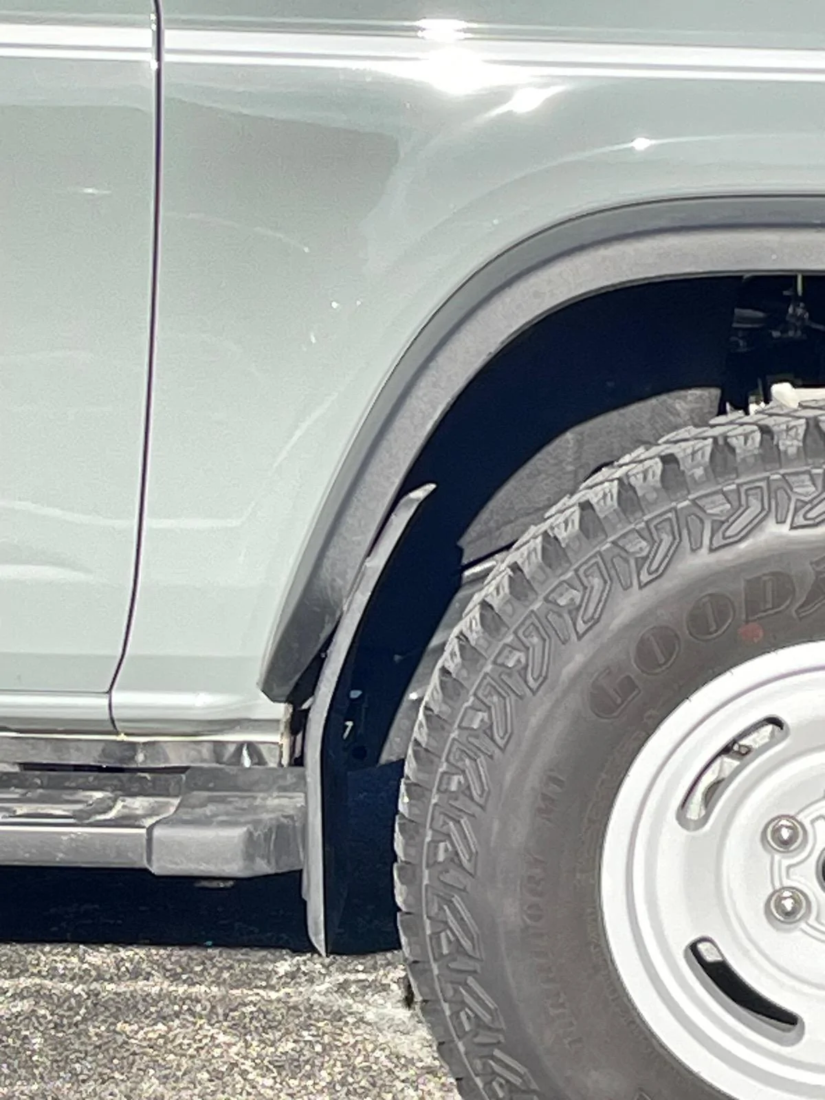

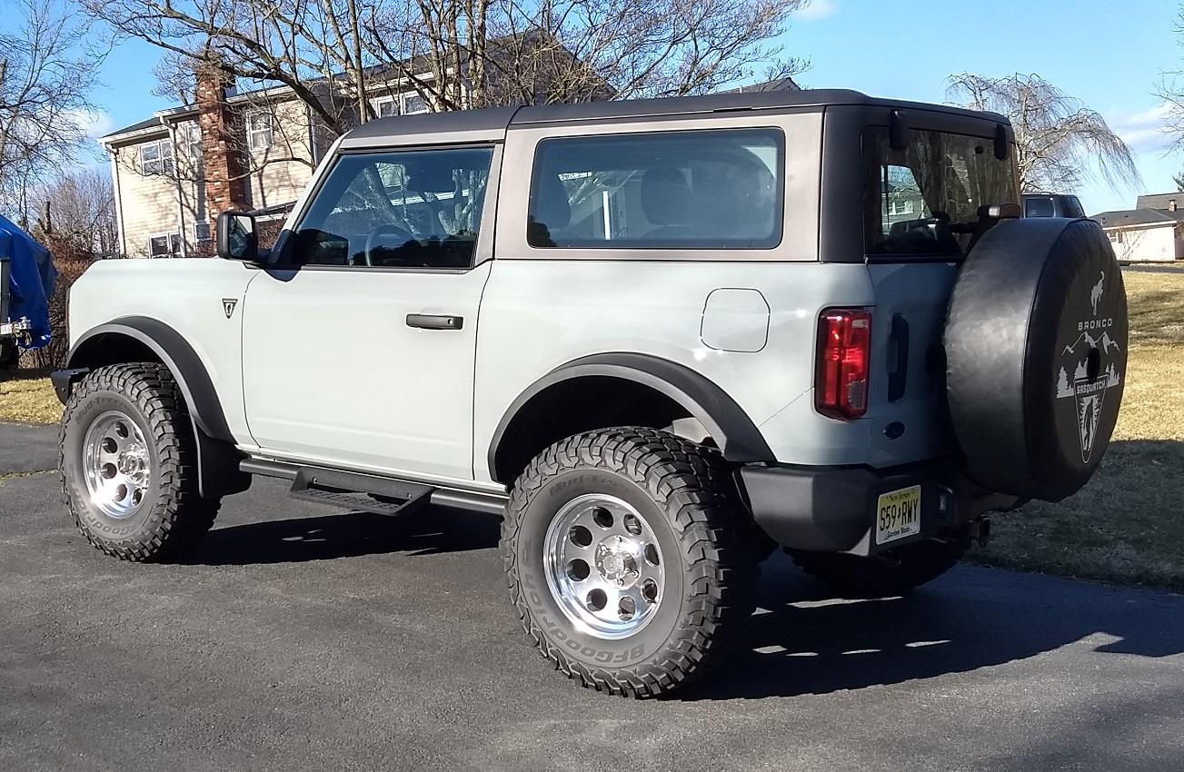

I put them on my base Sas and they fit fine with the hoop steps. When I added the Pro Comp wheels, they rubbed the flaps due to the -6 offset so I had to grind down some of the inside edge for clearance.

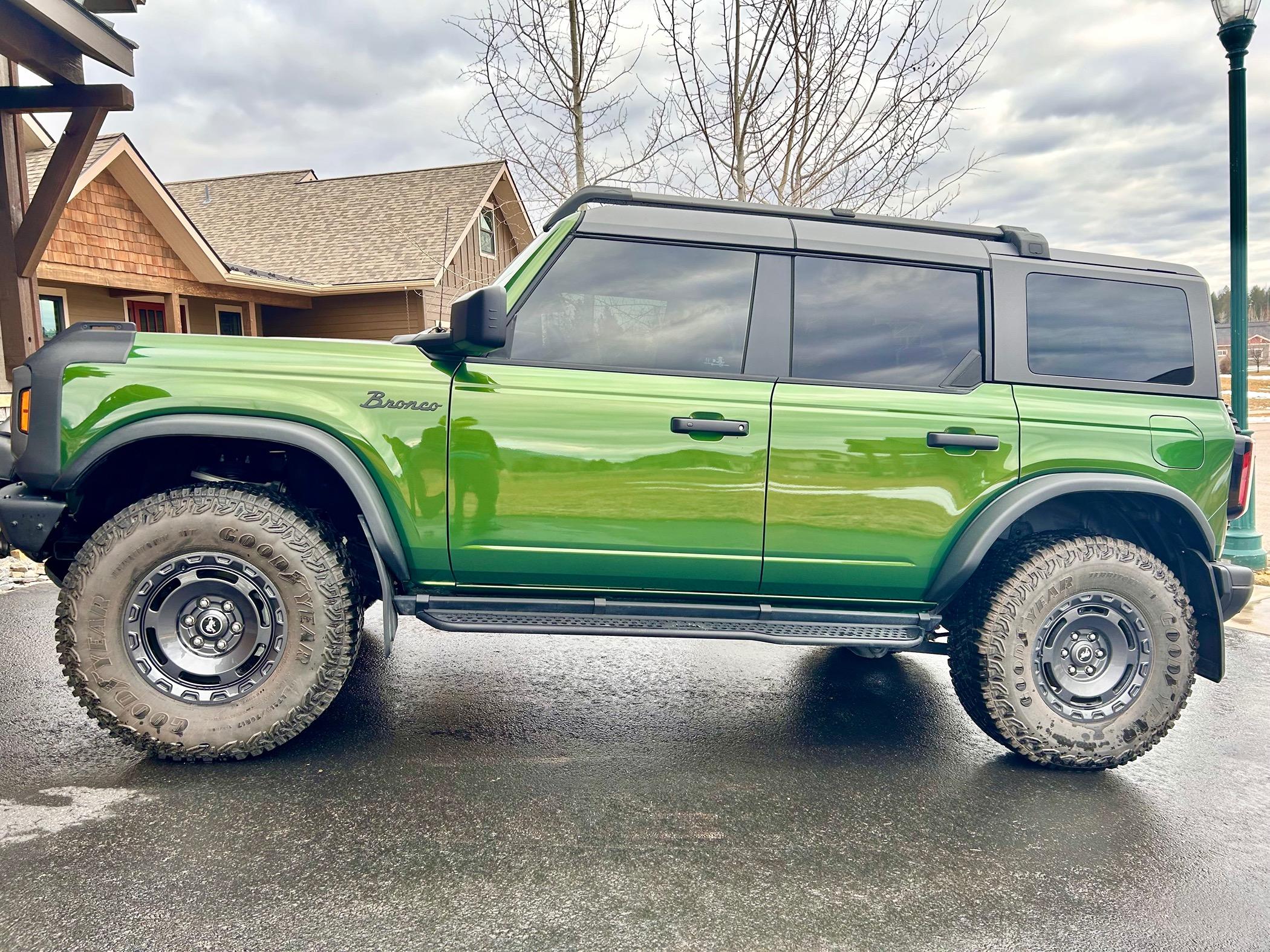

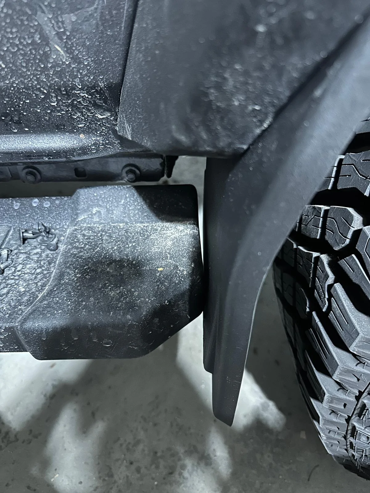

Here’s how good they look with the squared fenders…it is recommended to trim the fender by the mount hole or get longer clips at your hardware store to make threading the bolts easier

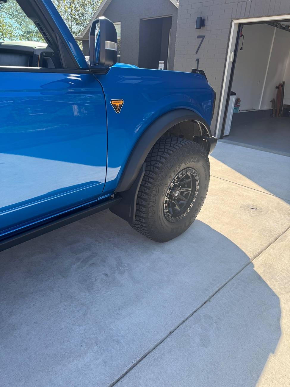

I put these on my Everglades and they fit fine. Watching a video for instructions was kind of annoying but the video was well made, clear and concise. No yabbering.
I had to file out one of the holes for the clips to fit. Used a chainsaw file. It took some monkeying to get the bolts and nuts to connect but even
I put some black plastic thread nipples on the rear fasteners facing the tires. They were about an 1” too long. The black cleans them up to make them look less shiny.
So far they work great. I also added the IAG ez full length running boards.

Had the same issue with filing one of the holes with mine as well... Overall like the flaps though.

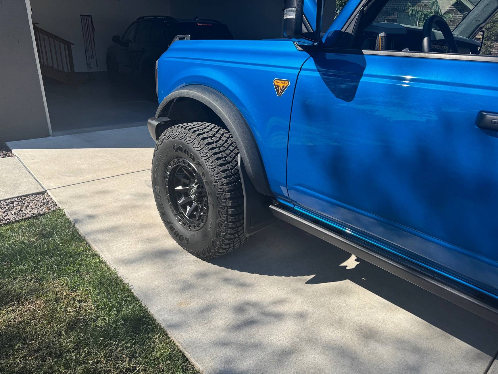

Anyone else having an issue with the flaps not quite sitting flush on the stock side step? The drivers side looked pretty good but the passenger side on mine is crooked.
