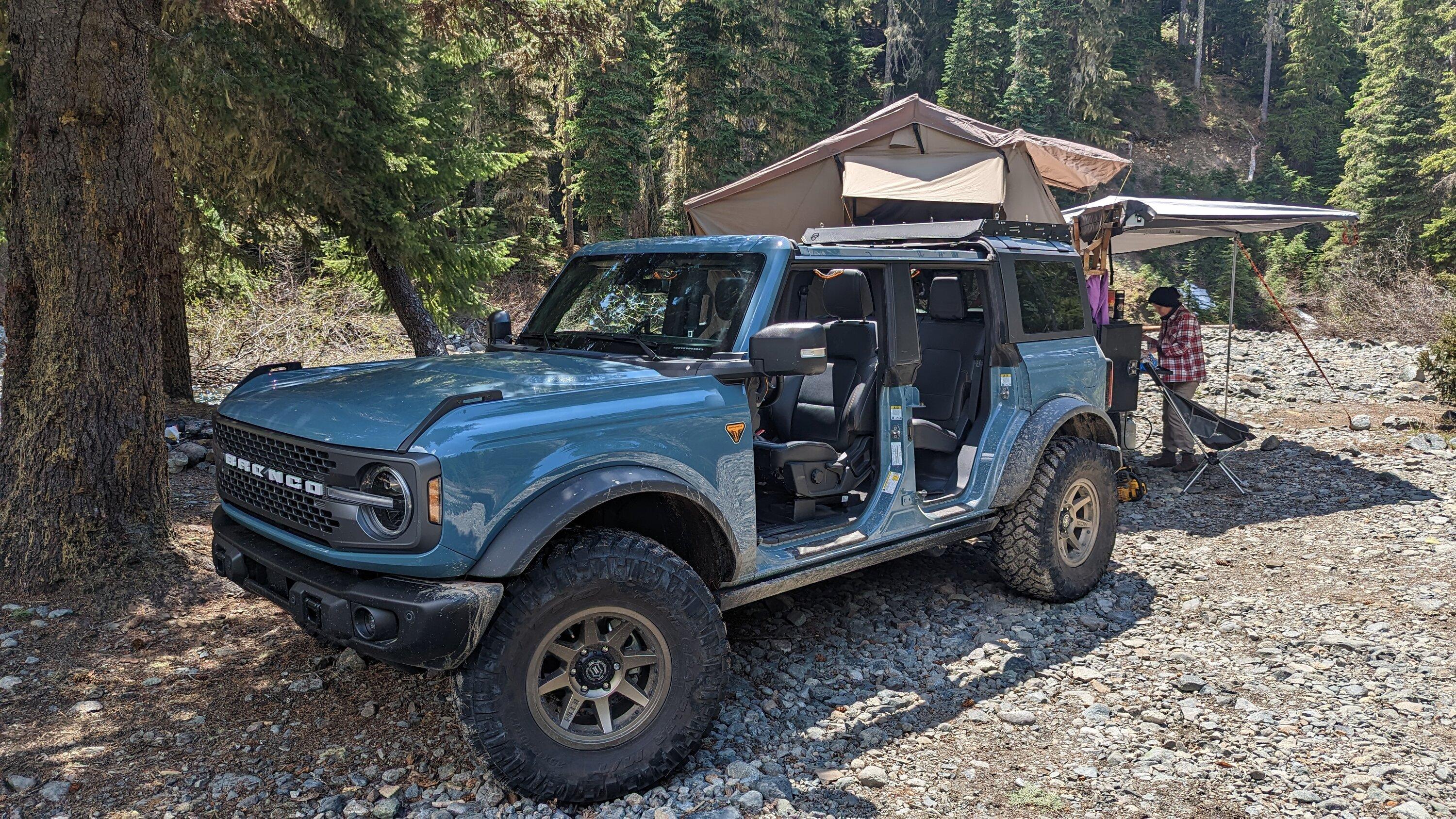

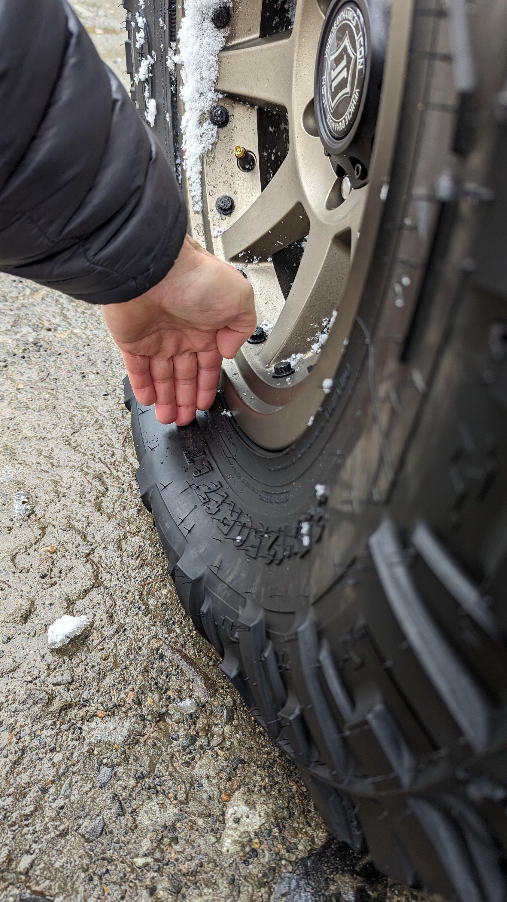

I don't think you can go wrong with either choice, I have run the Icons for about 6 months now and used them down to 1.5 PSI in snow & 10 PSI on rock. They have worked great, no issues.
I think bead grips work great too, the only downside is I hear removing the tire from the rim can destroy the tire. If true I don't think its a big deal as you don't typically remove good tires, but it could be an issue if you need to patch one.
Ford Bronco Icon Rebound Pro "Inner Lock" vs Method "Bead Grip" PXL_20230527_203814299 (2)
Ford Bronco Icon Rebound Pro "Inner Lock" vs Method "Bead Grip" PXL_20230402_173159183 (1)
