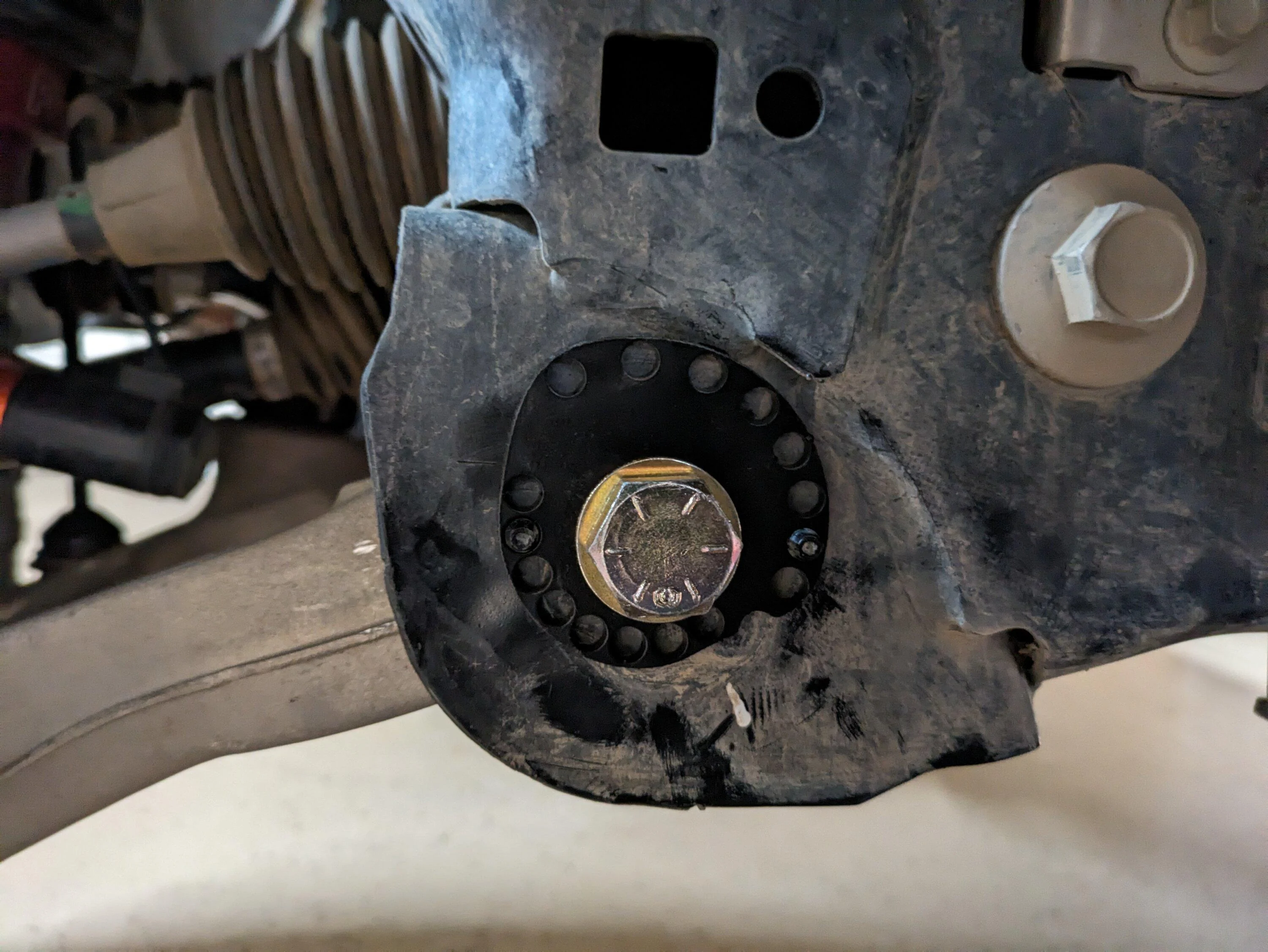

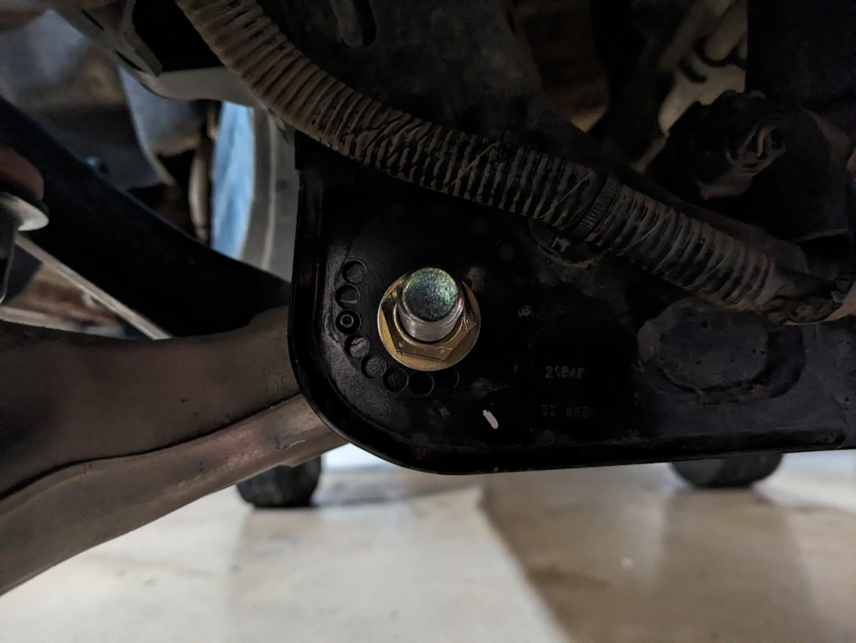

Got this project done today. These are by BDS Suspension. Bronco is headed to a 4x4 alignment rack on Wednesday. Now I won't have to worry about the alignment moving around which happens when you off road enough in the rocks and/or jump it.

So there is a weld and no weld solution for this? You have to have adjustable UCAs also, right?

Not sure what your asking. I am using the stock LCA's and the OEM pins.

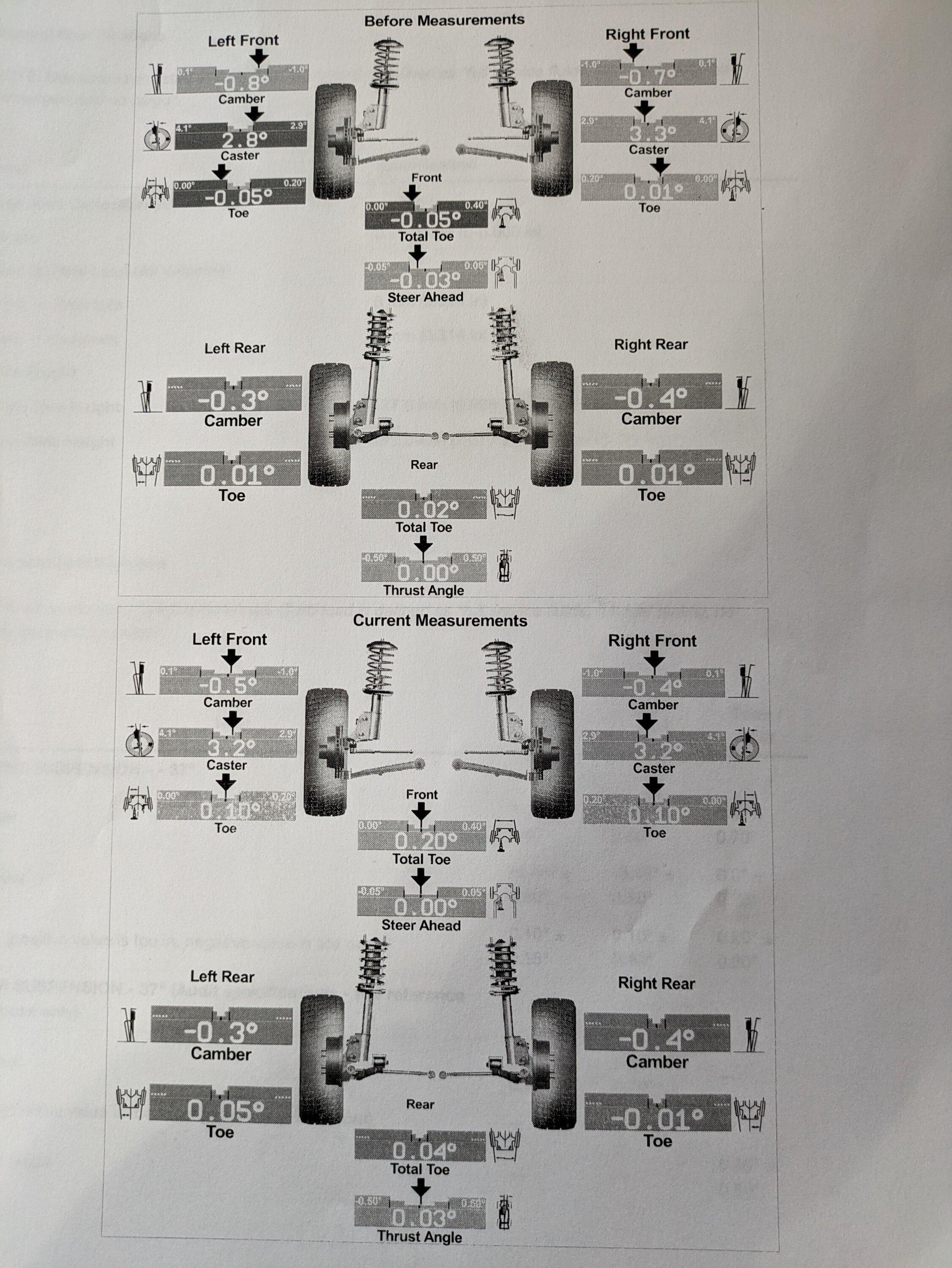

Alignment was done yesterday and now it's back to OEM spec parameters plus my steering wheel is straight now.
