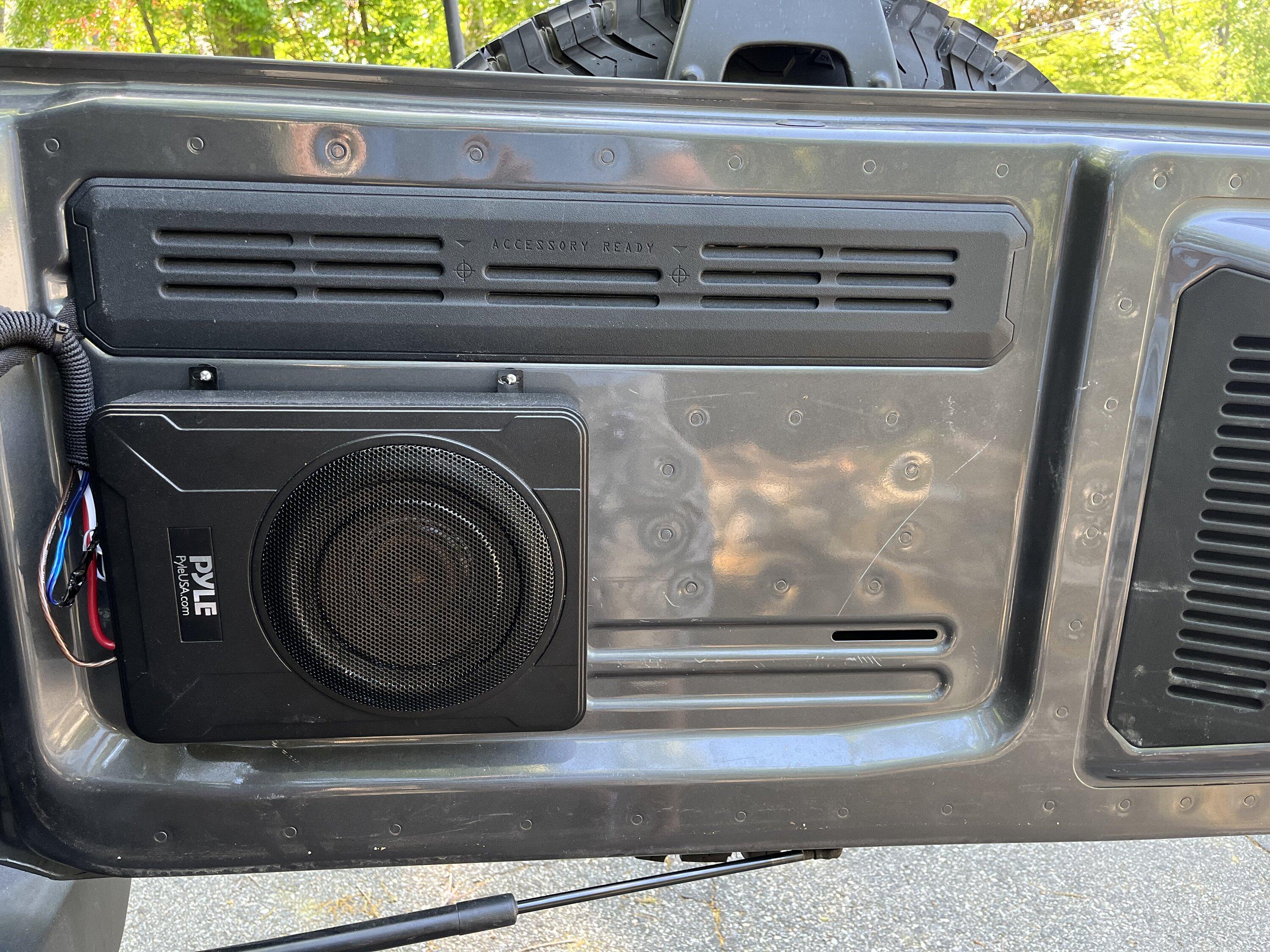

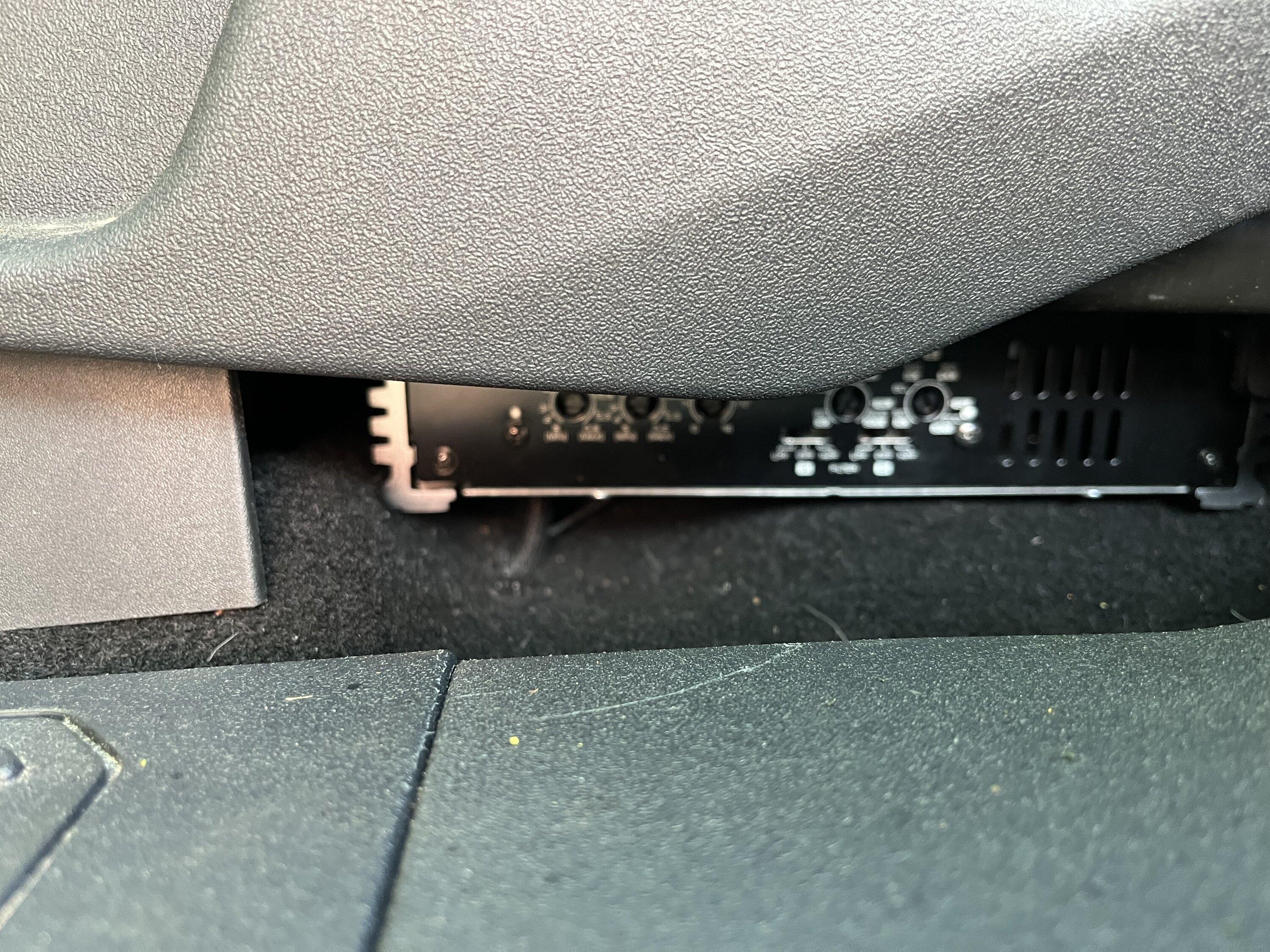

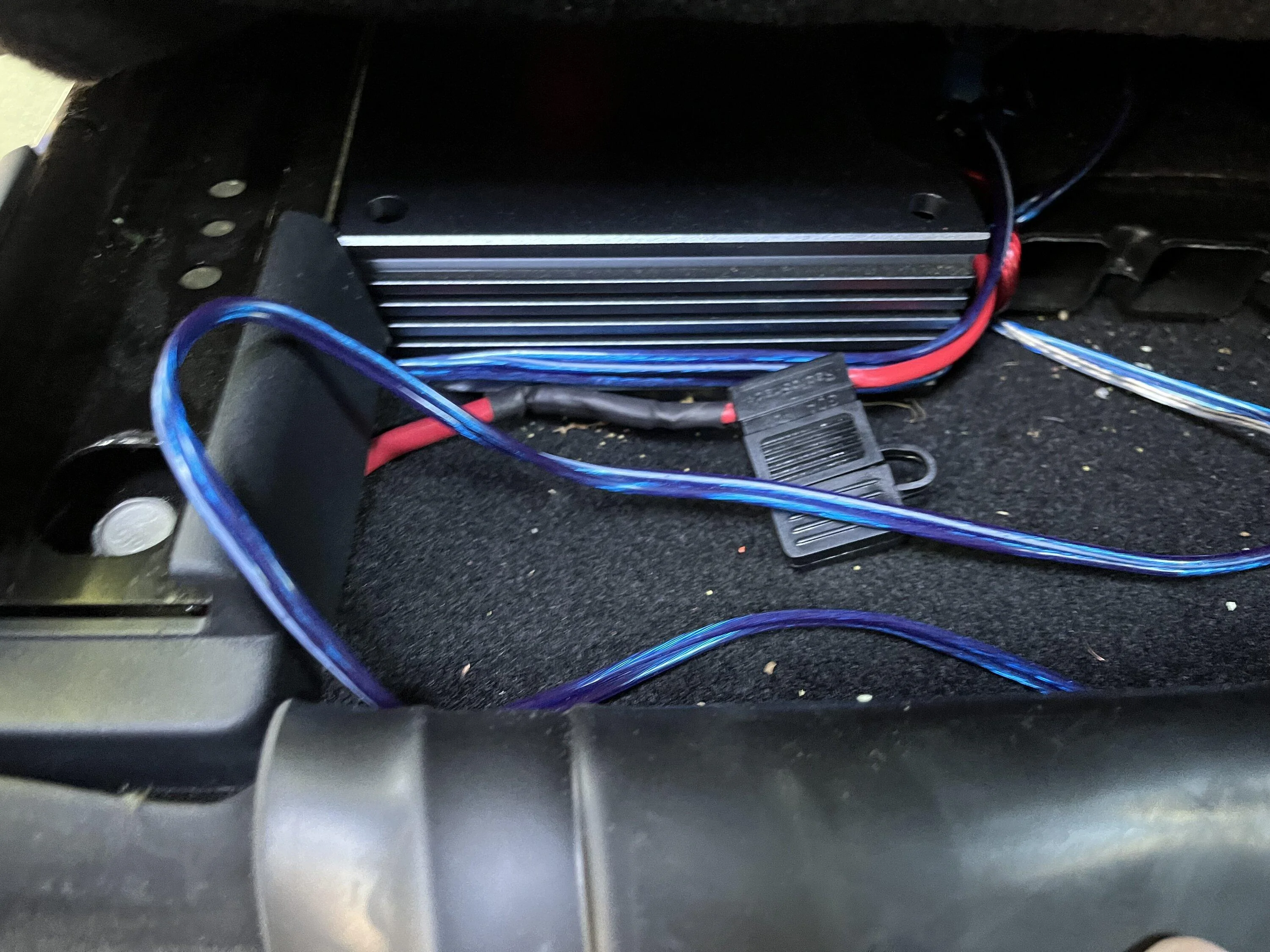

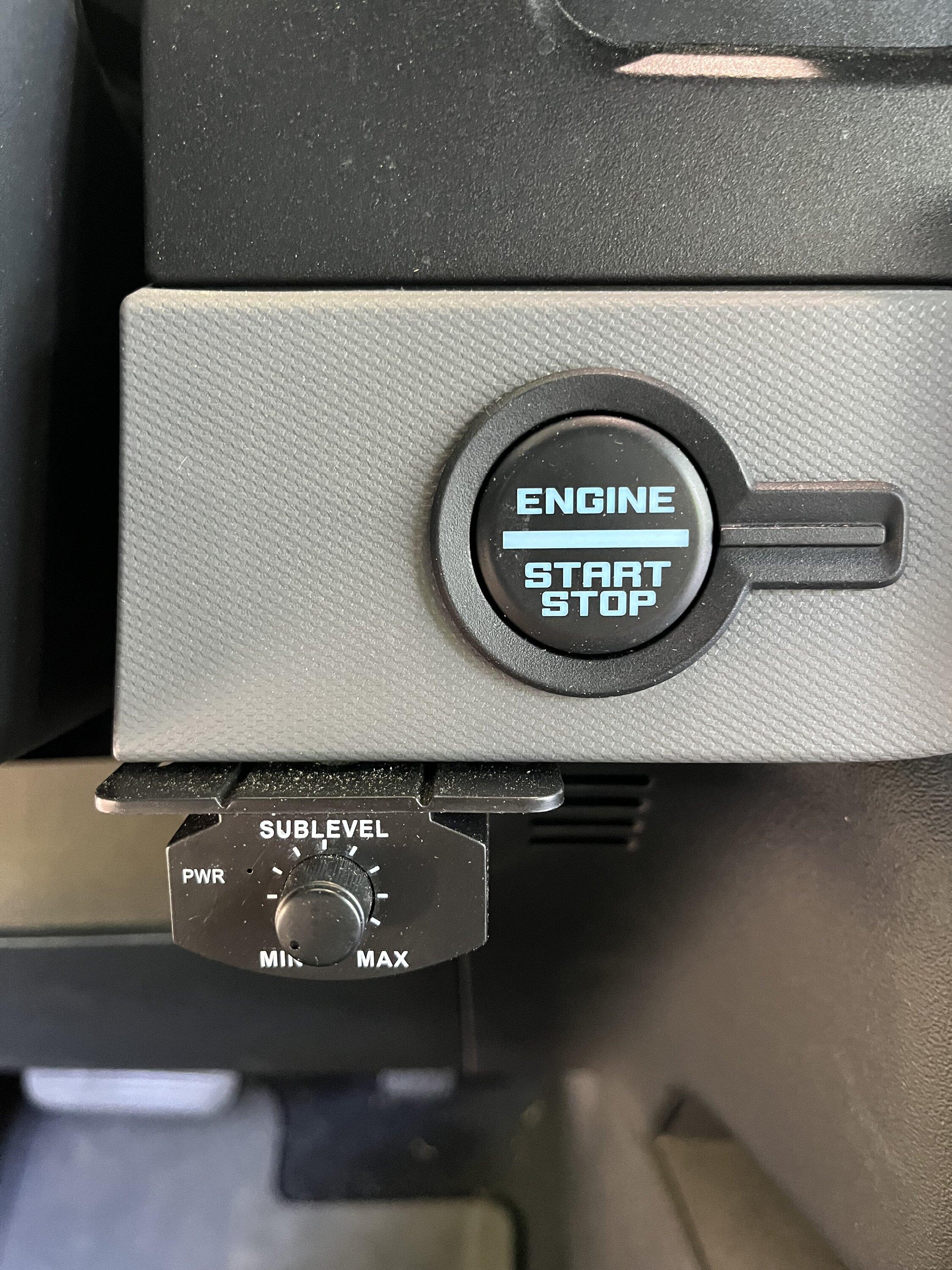

Not looking to blow my doors off so did a simple upgrade. The kicker 4 and 6” in front, kicker 6 in mabett pods in back all went in easy. Kenwood 4x100 under driver seat. Pyle powered sub on tailgate. Forscan eq reset does have an effect. Sounds decent, plenty loud and didn’t break the bank.

Did you use self tapping screws to mount the sub?

No. It’s a 1/4 threaded rivet with rubber washers between sun and door. The rivet tool was like $25 at harbor freight. Just fixed a better wire loom in place.
