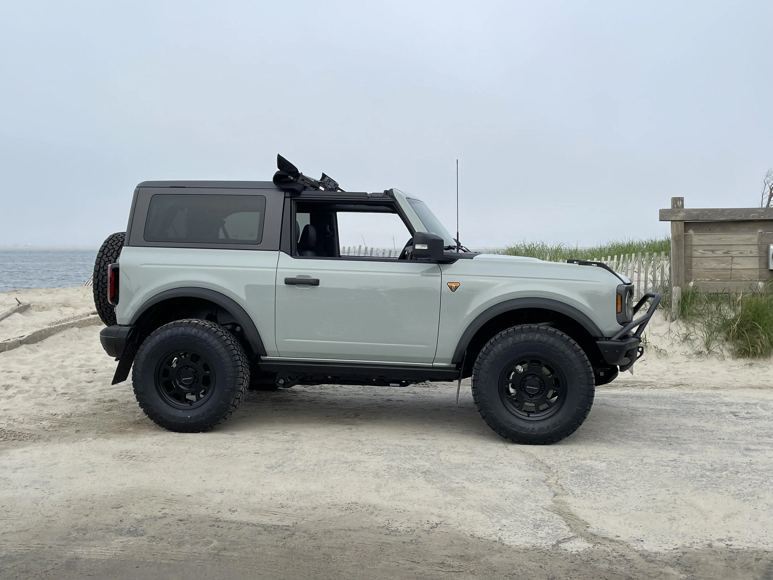

Just installed my Bestop Sunrider for my 2-door OB. May be the best improvement Ive made. Fits perfectly. Easy installation. Great quality. Highly recommend this product from Bestop. Makes a big difference over the two removable hard top panels.

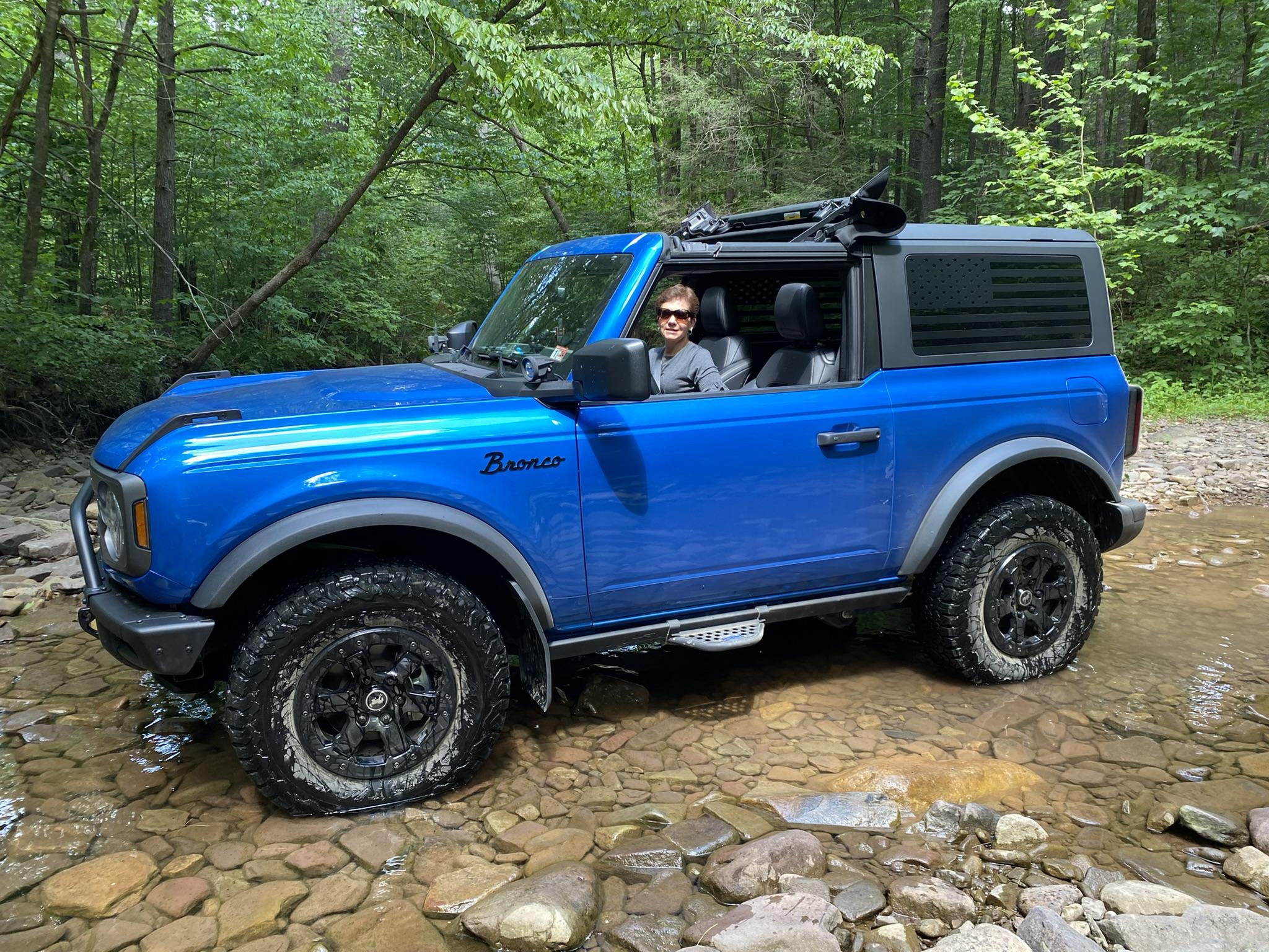

I agree! Just a few notes from my install.
I found the plastic supplied shims to be too thick and prevented the rear of the cover from sealing to the hardtop. 2 stainless fender washers per side fixed that.
Take a look at the rivets toward the front of the frame side bars. There are 2 per side. Mine as well as many others had them hit and remove paint from the roll bar. Stupid design.
The center of the cover will make a flapping sound if the windows are down and the cover is closed. The center cross tube is much smaller diameter than the pocket in the cover causing the issue. I undid the velcro and installed some round foam crack filler on either side of the tube and closed the velcro back up. Was afraid to use weatherstrip with sticky tape since heat up there may cause it to melt and make a mess. So far seems to work.
