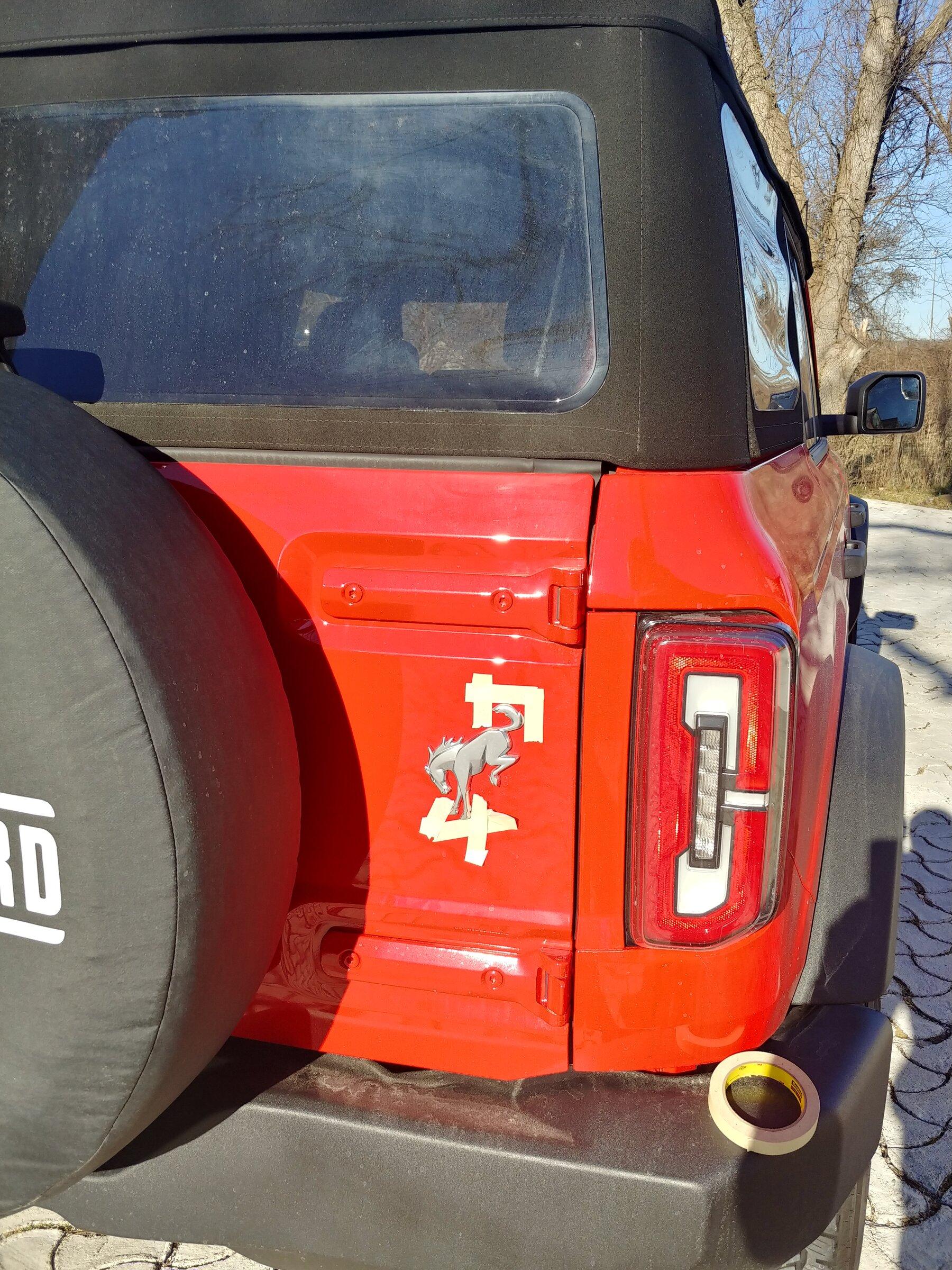

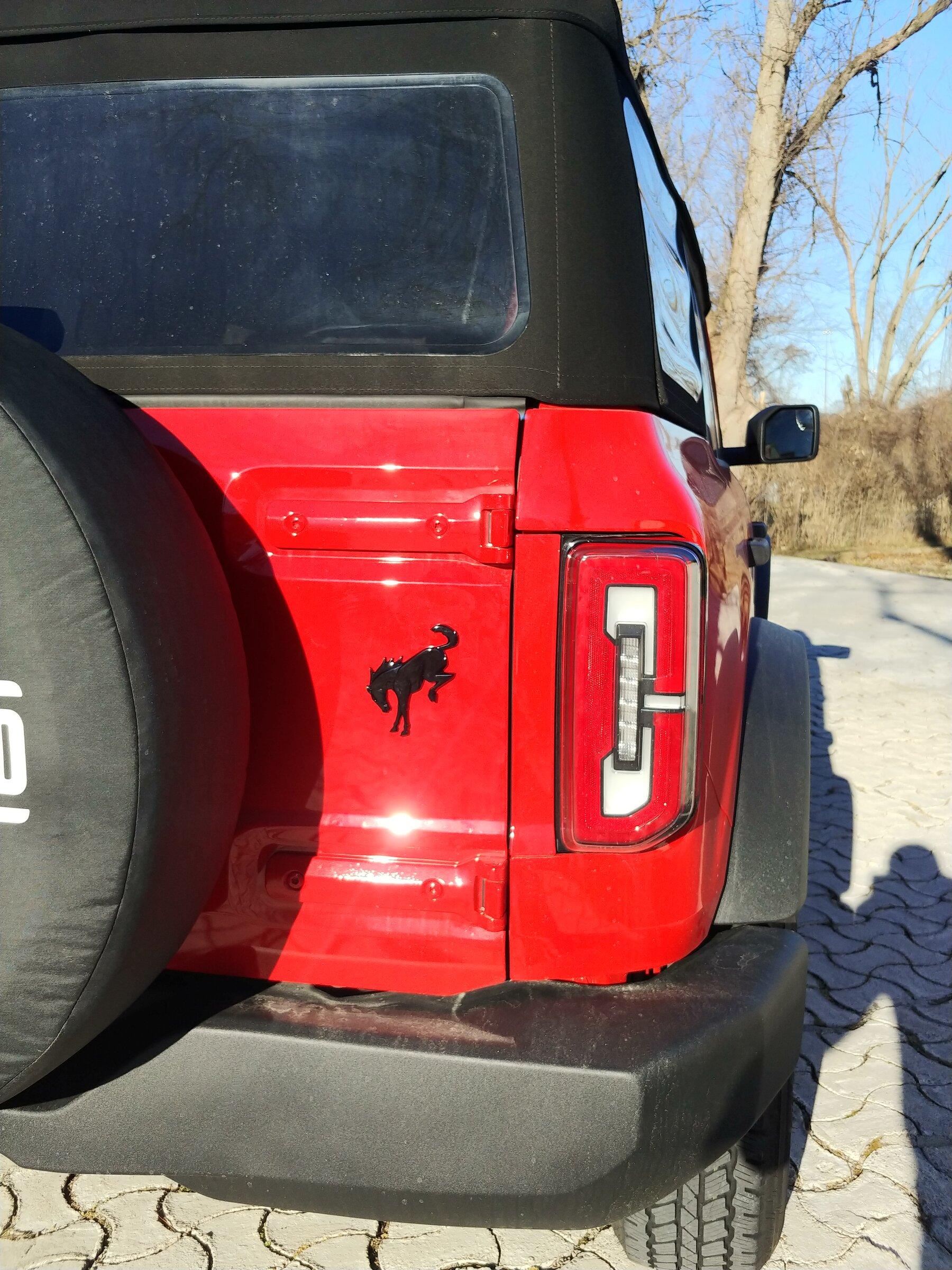

I put the black bronco on the rear of my Big Bend. Just used masking tape before removing old badge to mark location. I love it and was happy to get rid of the chrome

How did you get the old badge off?
Fishing line and use it kinda like a saw pulling away from the vehicle. Then remove big chunks of adhesive with your hands finished with Goo Gone.

Why does your rear bumper look funny? Was it smashed?

Where’d you get the spare horse emblem??
Nope, just some dirt collected on it and that one black spot below the emblem is a cutout part of the design
Got with my local dealers parts department. I had to check a few times to see if it was in stock and finally a location in Canada was showing they had over 100 of them, so we ordered it!
