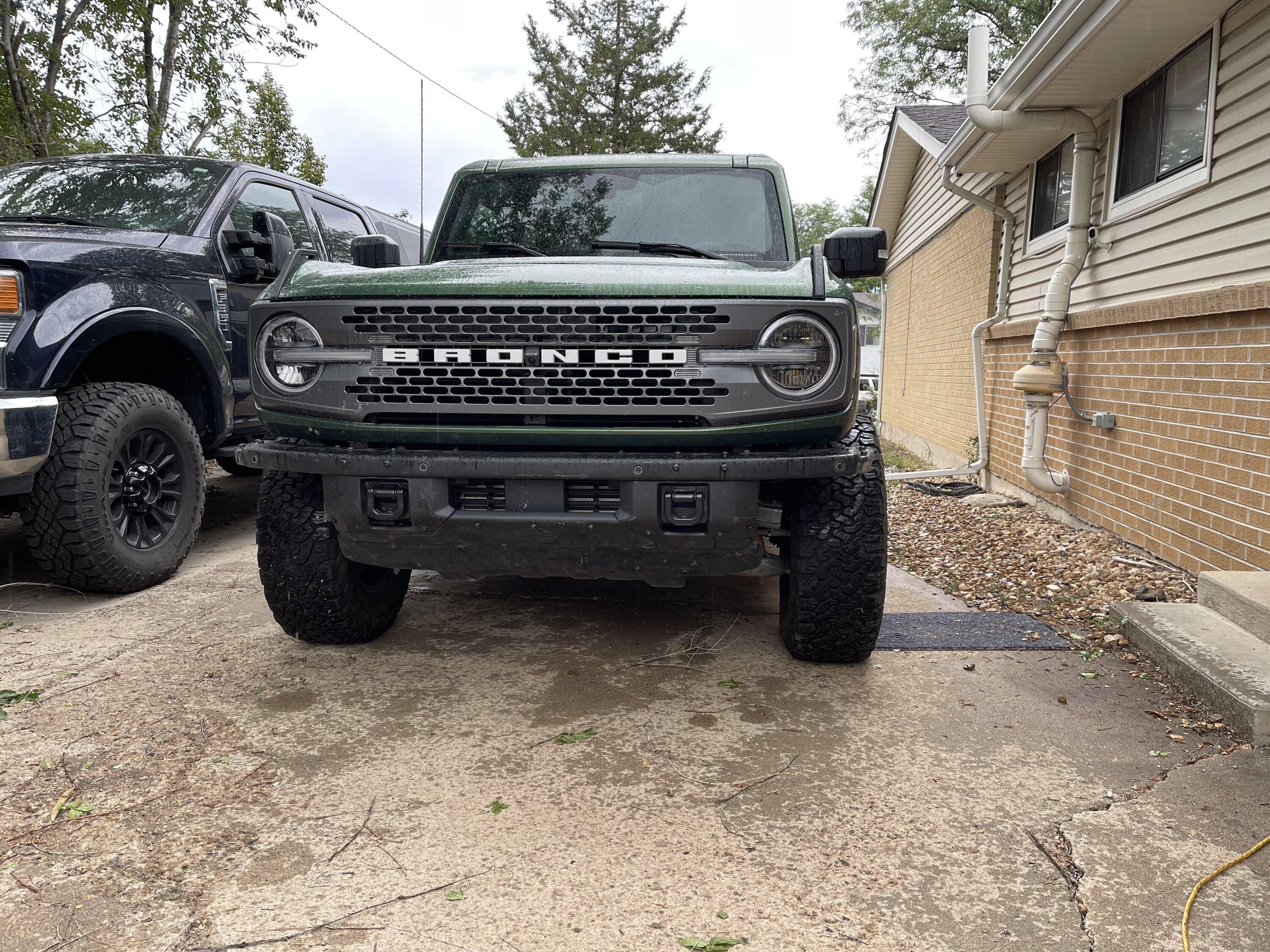

Bumper on, all sensors work, used floor jack to lift and a little help from my wife. I’ll post pics in a bit.
The sensors worked just fine? So basically just cut off thr hooks rewire the sensors and its good to go?

Cut off hooks ? i pulled harness off old bumper and put on new. the little tabs dont all line up on mod bumper so I just trimmed off with razor knife the ones that dont align.

I did this last weekend. The capable bumper wiring harness is a little tight on the modular bumper but it fits. Pop the plastic off around the tow hooks, remove the three bolts on each hook and the bumper comes right off. No way it’s an 8 hour deal….
I kept the capable hooks on the modular bumper. I like them better.
