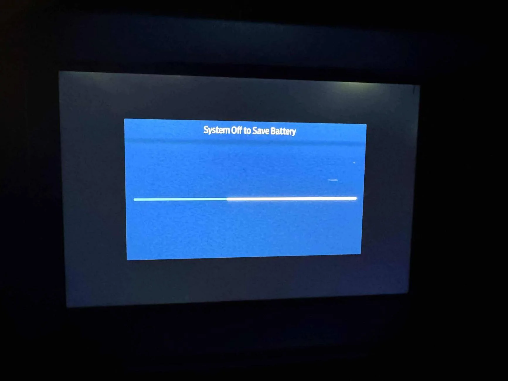

Yeah, I noticed that too. Did a remote start about 20 seconds before i hopped into the rig and saw this on the screen...
Ford Bronco Issues with the latest software update? 1733671450082-gg
Then it says “system off to save battery” with a task bar

It’s not the battery. I had it checked. I’ll have to call the dealer tomorrow
