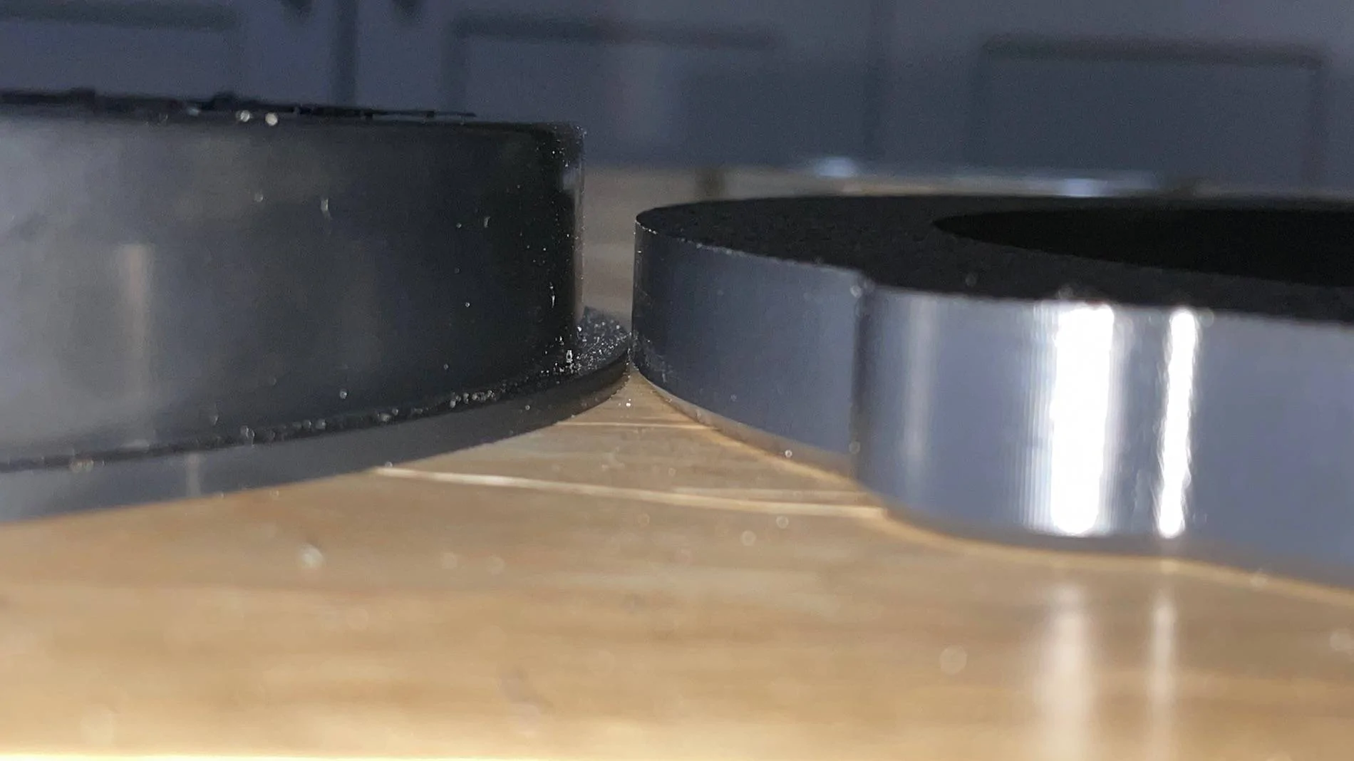

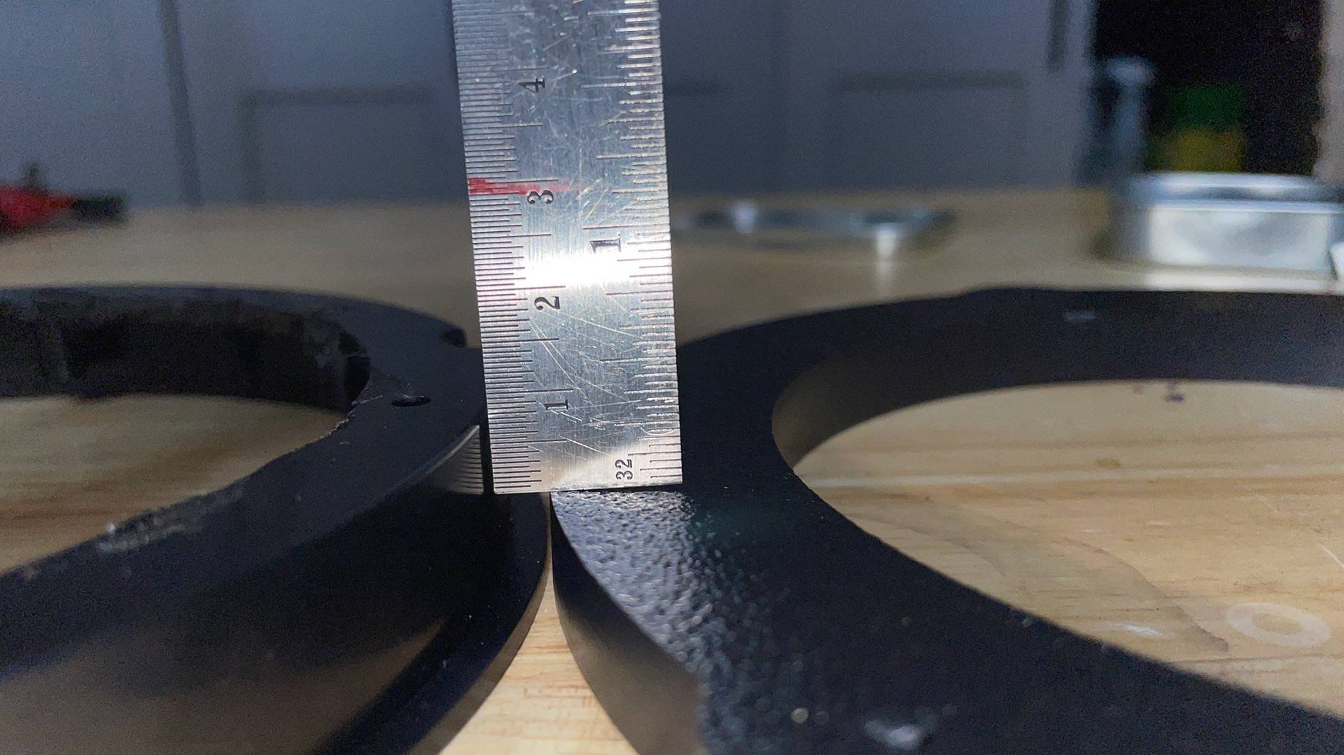

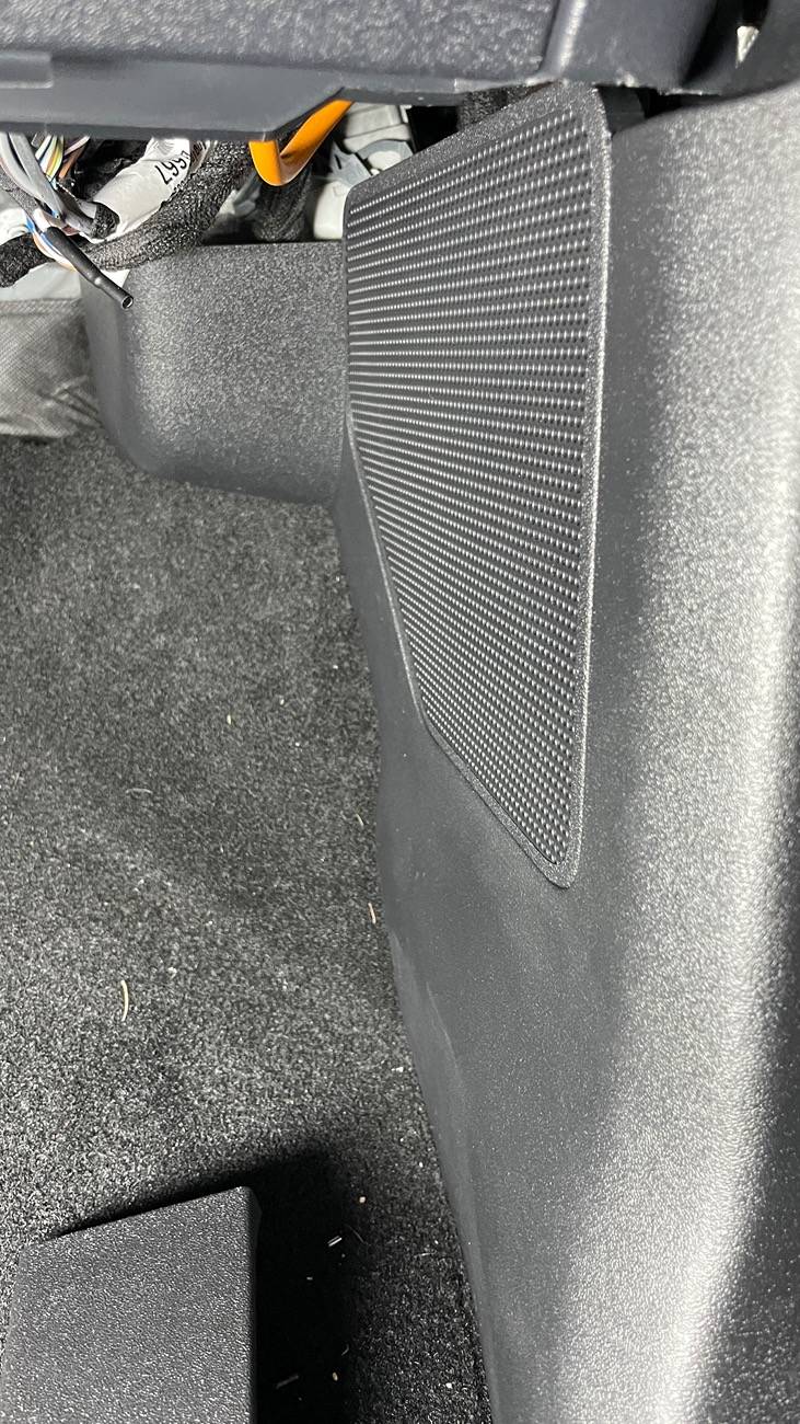

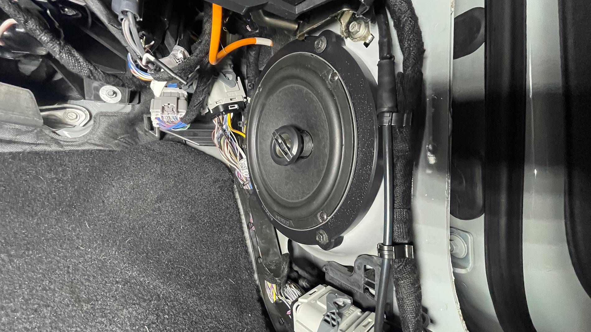

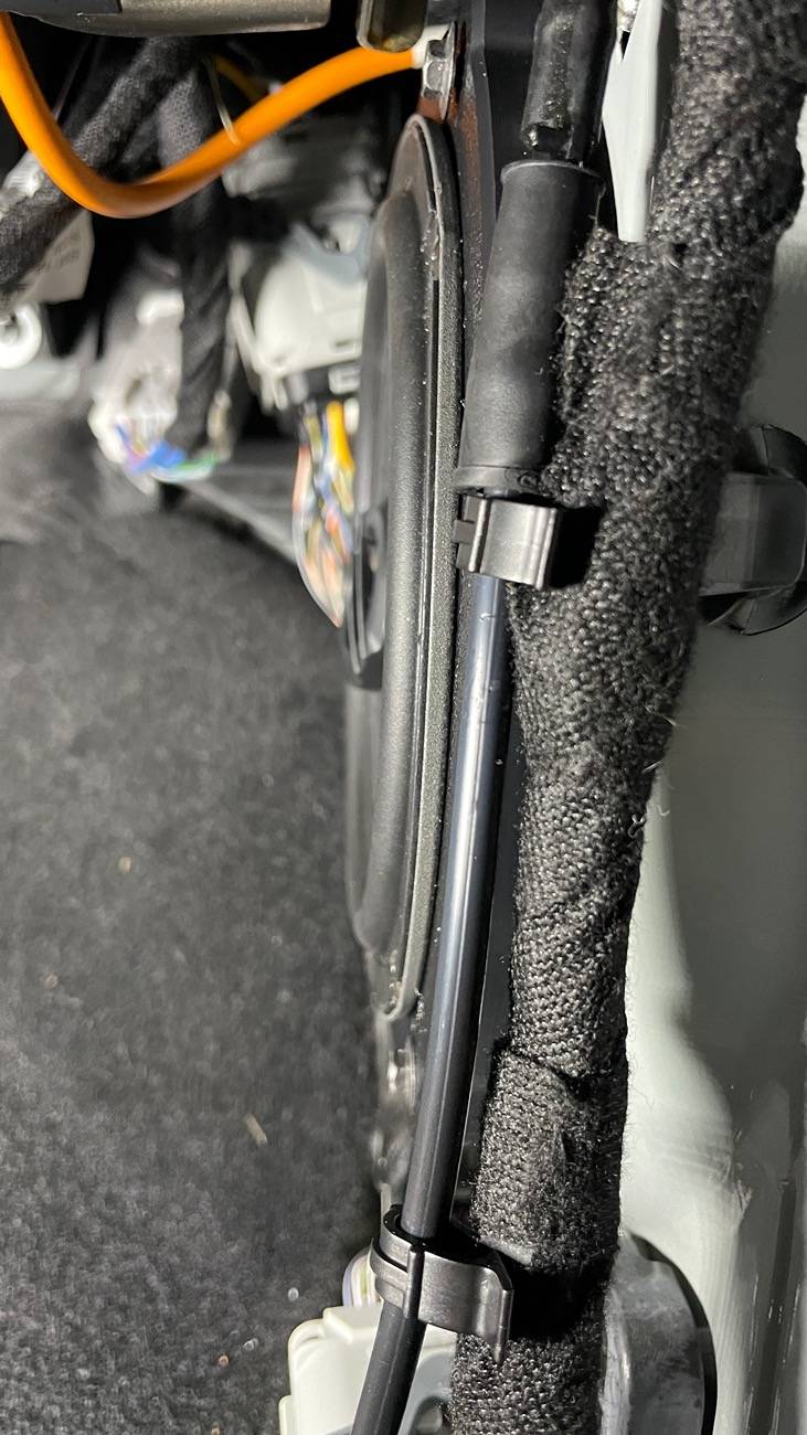

I was able to install the Sounds Good Stereo adapters this morning and they give about 8mm more clearance vs. the Metras. The OEM grille covers snap in easily and there's plenty of clearance with the Hertz CX Centro 165's. No issues on the installation whatsoever. Third time is the charm I guess.
Pics...First one is driver's side obviously, with the SGS adapter in place, lots more clearance. Second pic, passenger's side, with the grille installed. Third pic, for those that have looked at the Metro setup, you can see how it's more flush. 4th pic just showing the installation with the SGS adapters. Fifth, a ruler showing the difference in height (approximately 8mm).
The SGS are more expensive but at least you'll know they'll work. They're pretty solid and I pre-drilled pilot holes for the speaker to adapter screws. The three outer adapter to bronco screws are pre-drilled and due to the lower height, they're far easier to install than the Metras as it was easier to see the holes and what you were doing.
Hope this helps!
Hope this helps!
