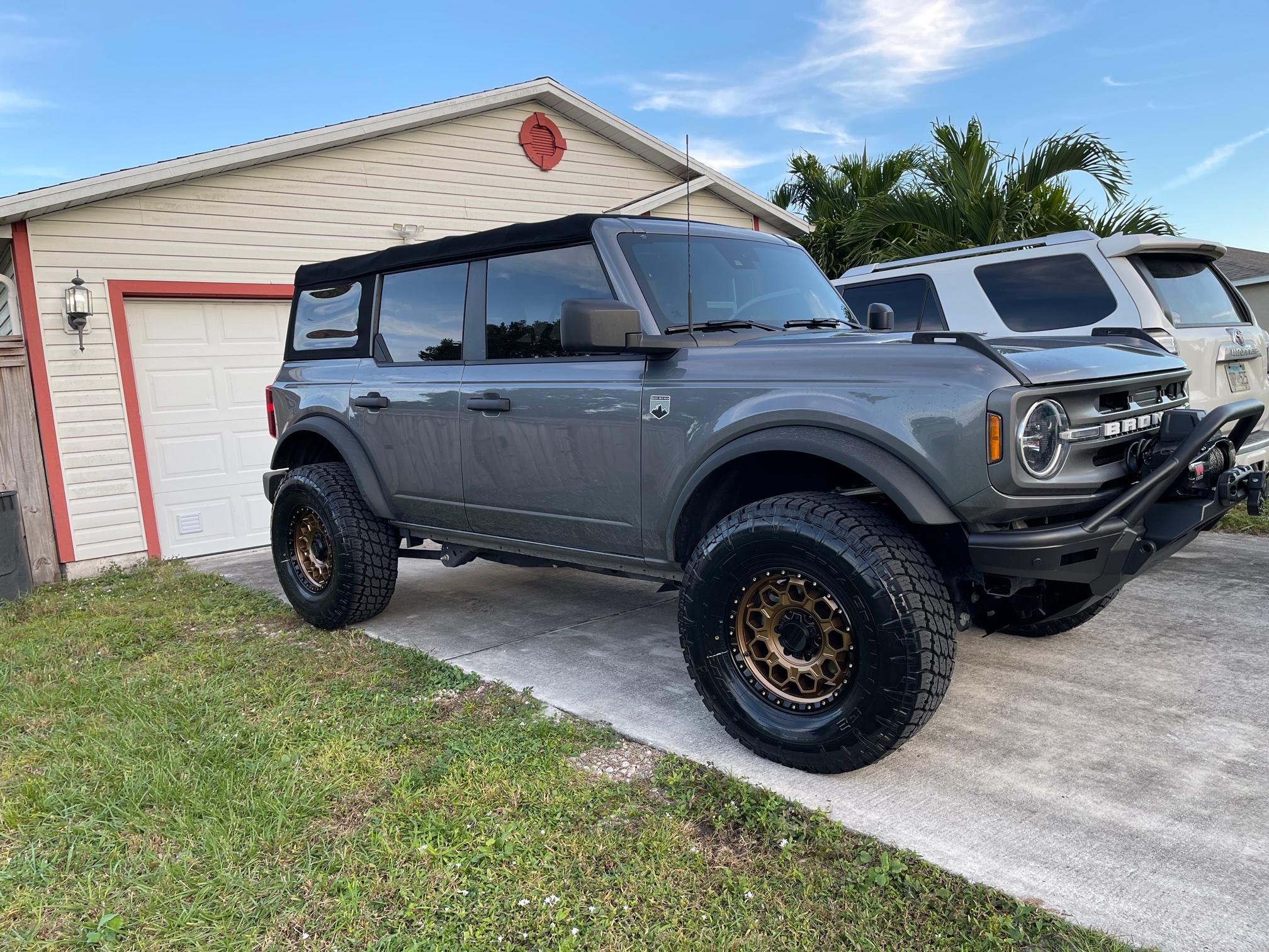

wheels good. 2 inch best for 35s imo but 1 inch level easier cheaper. I've seen zone spacer and rough country and like zone best as it is tapered for front to better mate with angle of suspension.

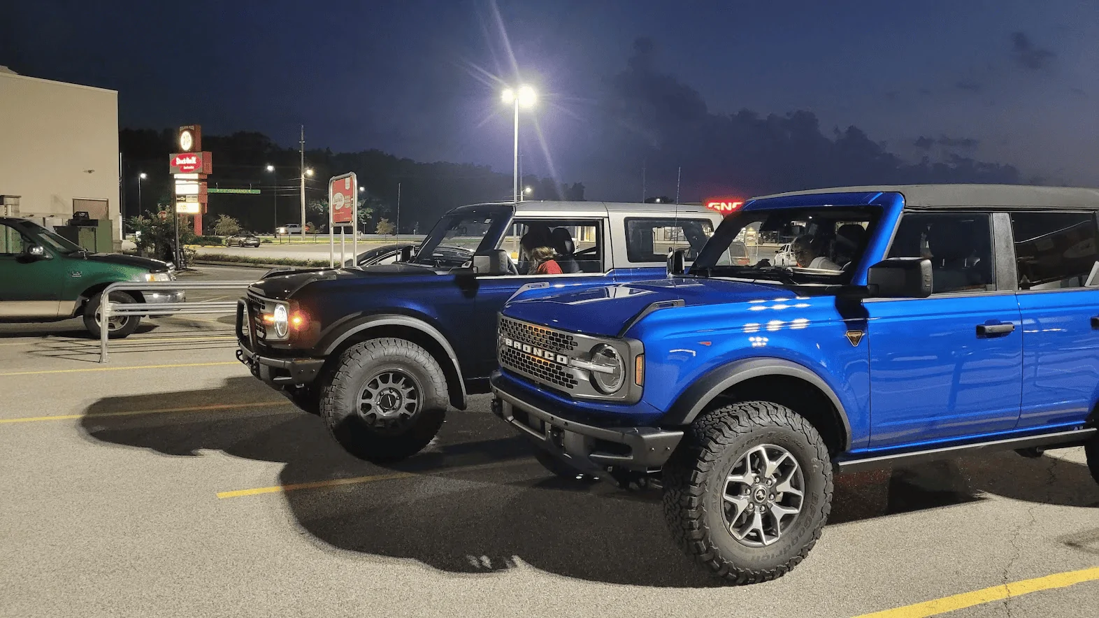

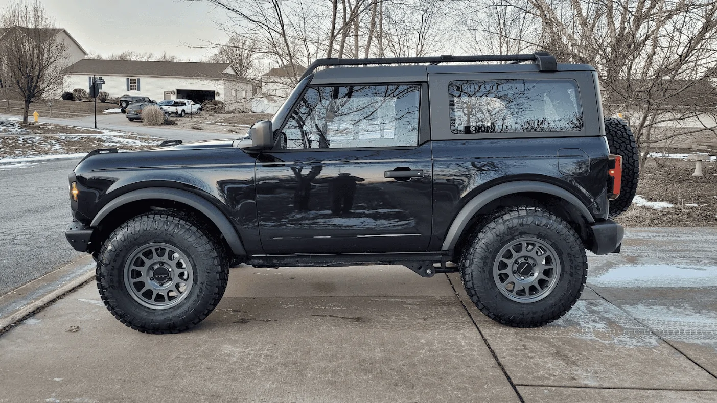

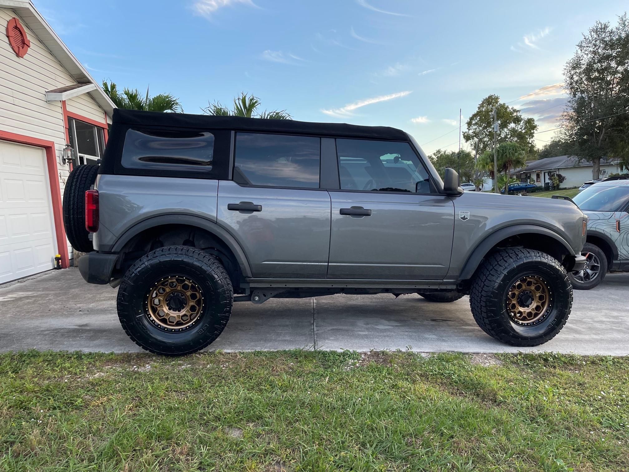

for reference. 17x9 +18 offset wheels, 315x70x17 tires, 2" RC spacers ($150ish) no rub at all. You will have to remove front the rear crash bars though.

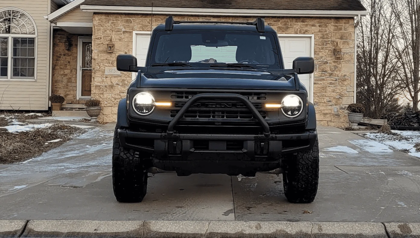

Lift not neccesarily needed.
My Base has 35 X 11.5's on 17 X 8.5 w/ +35mm offset. NO LIFT , they fit fine for street driving. No rub at all.
If/when I lift, it will be with the Icon spacer lift. They built it to handle a full stuff with 35 x 12.5's and their +25MM wheels.
https://www.bronco6g.com/forum/threads/icon-3-level-lift-spacer-kit.29215/
https://www.bronco6g.com/forum/threads/2-door-base-non-squatch-on-35-nittos-icon-rebound-pros.26789/

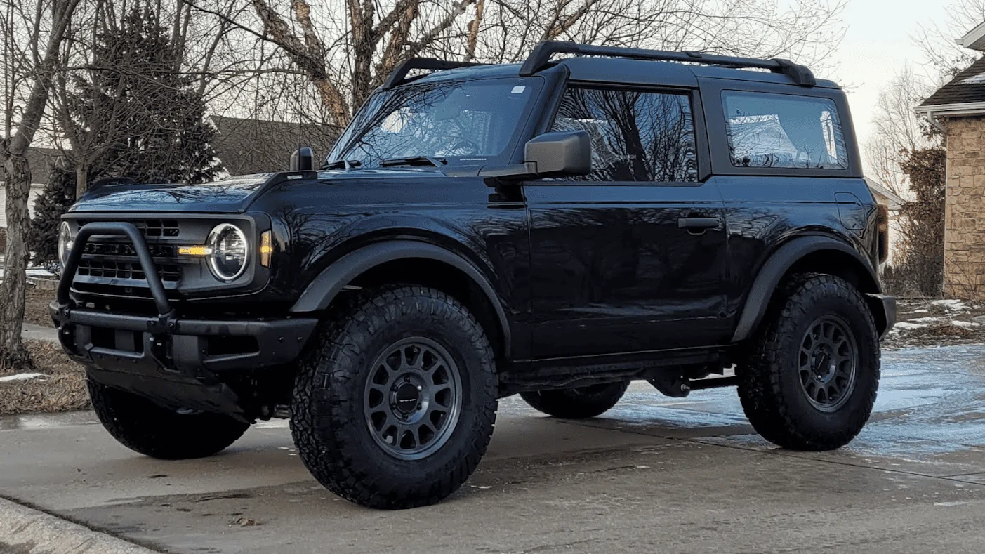

Stock:
Ford Bronco Lift kit recommendations for 17" wheels (+25 offset) & 35's ? 1645340850145
new wheels and 35 x 11.5's : NO LIFT

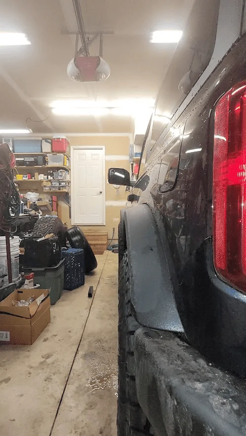

Hows the poke on that, looks awesome! does it throw mud/dirt on the side? @HoosierDaddy
HoosierDaddy
Mar 6, 2016
5,433
13,856
Indiana
68&69 Broncos, 21 AMB Base 2dr, 23 VB BL 4dr
Ford Bronco Lift kit recommendations for 17" wheels (+25 offset) & 35's ? 1691450847396
Pretty much any of them will plaster the sides.
I ended up going with Ford's front mud flaps, mainly because of rock chips, it helps, but I probably need something longer.
