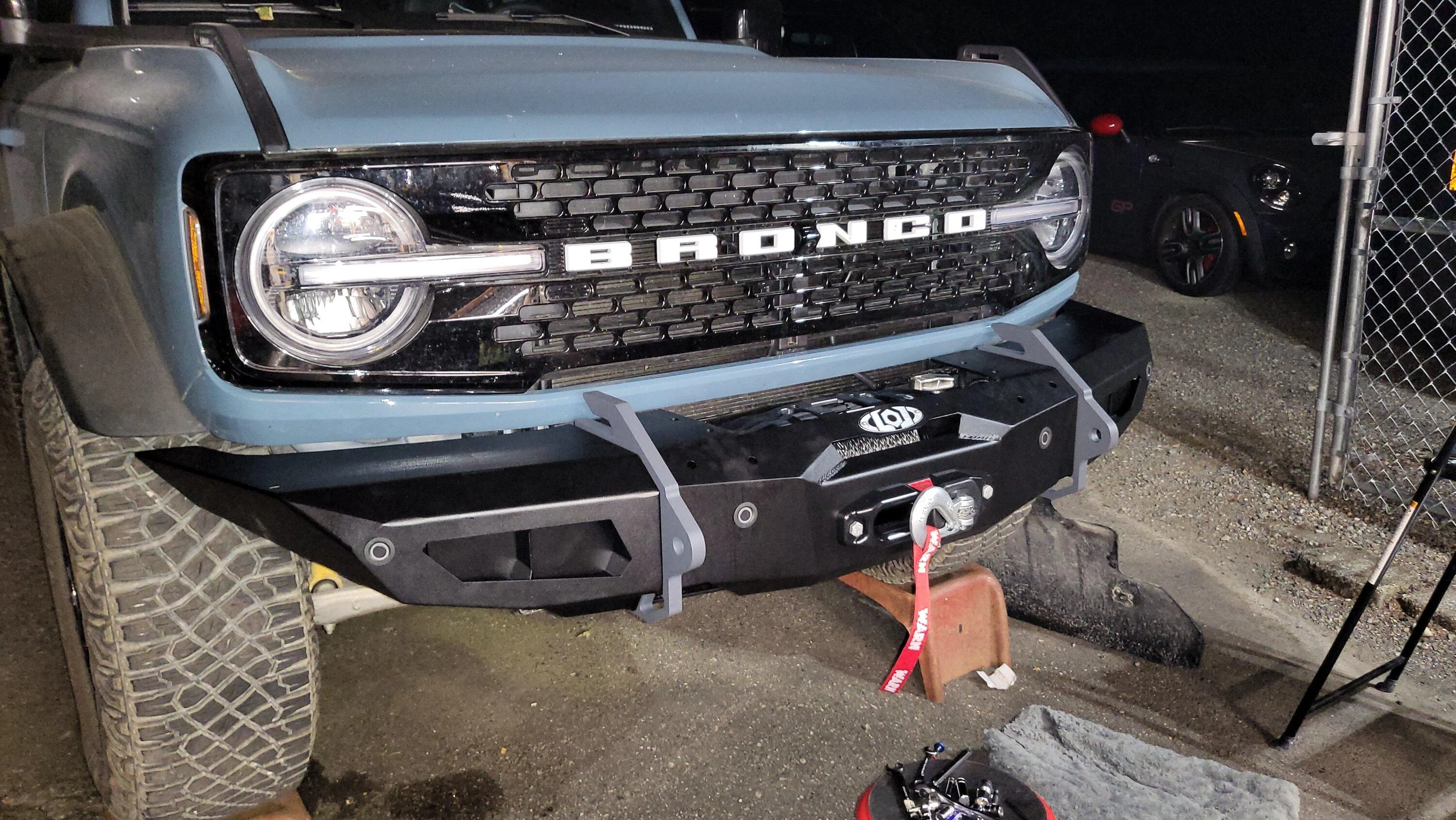

I just finished up the install of this bumper with a Warn Evo 12. install was very straightforward. My challenge was relocating the ACC, and the decision to remote mount the winch control unit.
I will say that the quality control on some of the Ford bolts is a little suspect... I had one tow hook bolt gall on removal, and one of the lower control arm cam bolts also galled during removal. (for installation of new front springs due to the weight increase from the bumper and winch)
I also installed the front bash plate and the front diff plate.
One comment to LOD Offroad, please consider running a tap through the captured nuts prior to shipping, the extra coating on the nut threads made it difficult to get the bolts started and tightened.
Overall I am really happy with LOD Offroad products.

What springs did you go with?
Old Man Emu, medium weight for heavy load, they are specifically for the four door. But they fit fine, and leveled out the front to rear stagger. I just did the front, since I do not intend to carry a lot of weight in the rear. No weekend overlanding for me, just day trips.
