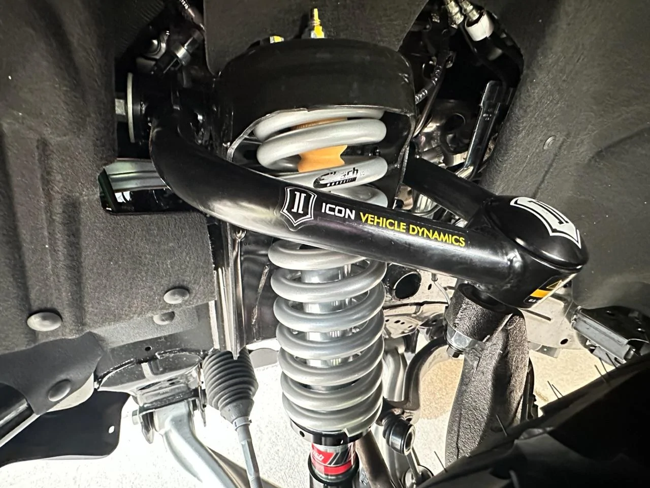

I put the 550 springs up front on the Eibach Coilovers and it turned out great. Ride is awesome. Badlands 4dr 2.7. Front and back are within 1/4” and got around 2.5-3” of lift. 37” BFG All Terrains, Icon UCA, Method 315’s w/0 Offset.

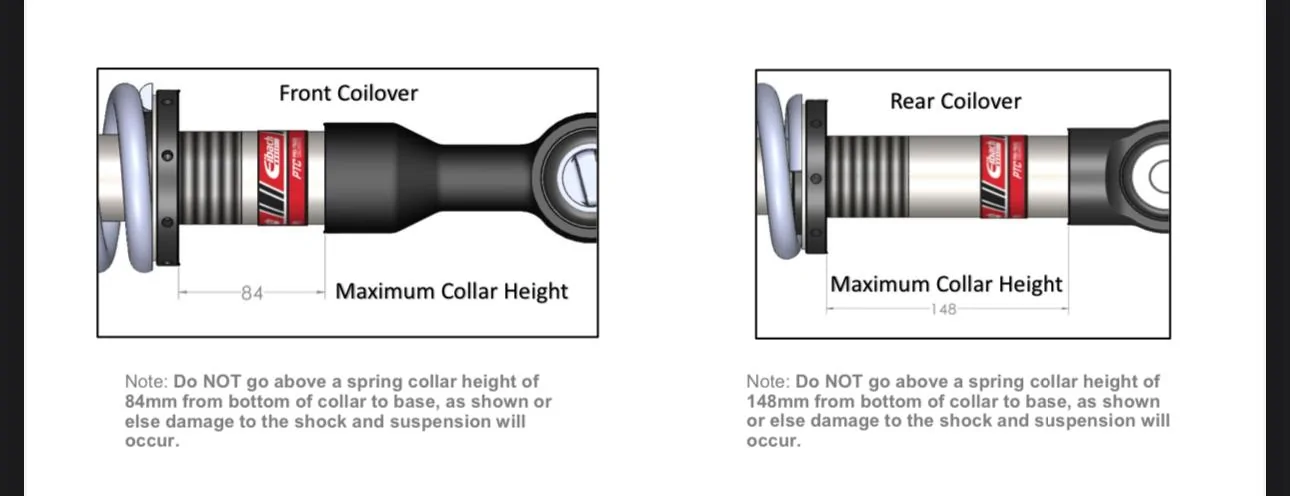

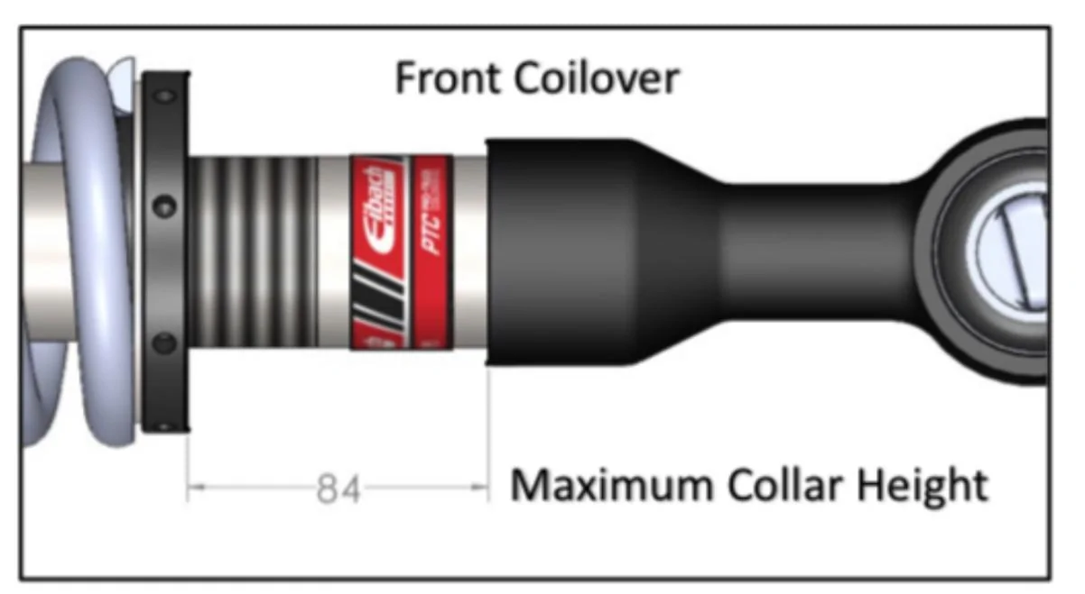

Refering to this measurement.
Eibach says with the 550 spring, 19mm of adjustability is lost. So max setting would be 65mm collar height where the 450 spring is 84mm.
Triathlonfun
Ken
Sep 6, 2020
297
598
2023 Bronco

Hmm… that’s what mine originally came in set at. They told me 65mm would be max collar height for the 550 spring. Now I am curious to what everyone else’s “max setting” is, maxed out according to threads on shock body or according to Eibachs max measurement for the collar. Maybe this is why I am not getting as much lift as everyone else.
I installed the 550 springs and set to max according to Eibach (65mm) and I am ~1.4” lift over SAS.
