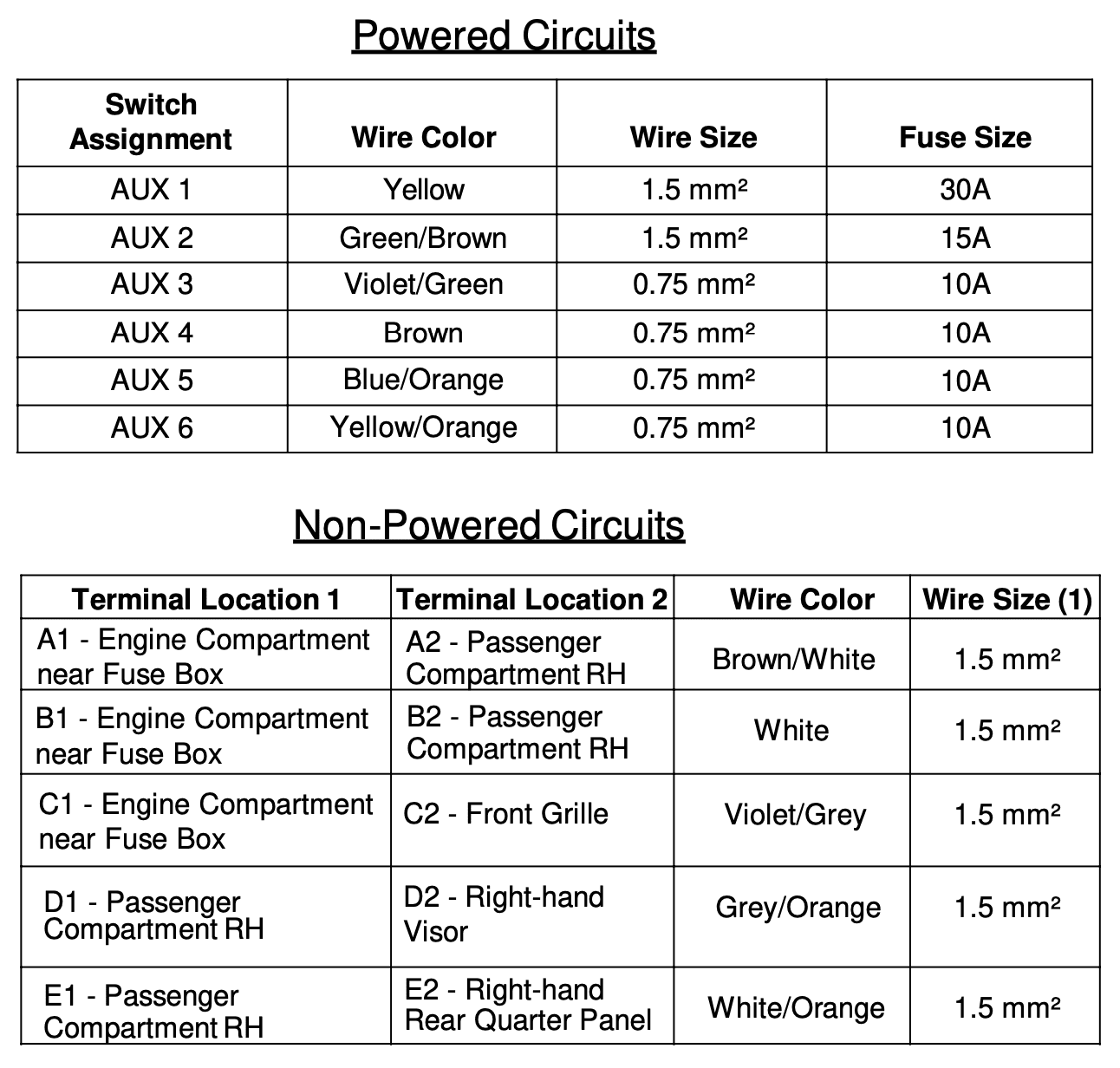

Do you have the #5 & 6 going to a relay? They are only 5 amp switches on their own.
Suppost to be 10 amps. I thought the aux switches were already relayed. The rear lights are 15 watts and #6 for air compressor is just a trigger wire. The air compressor is wired to battery

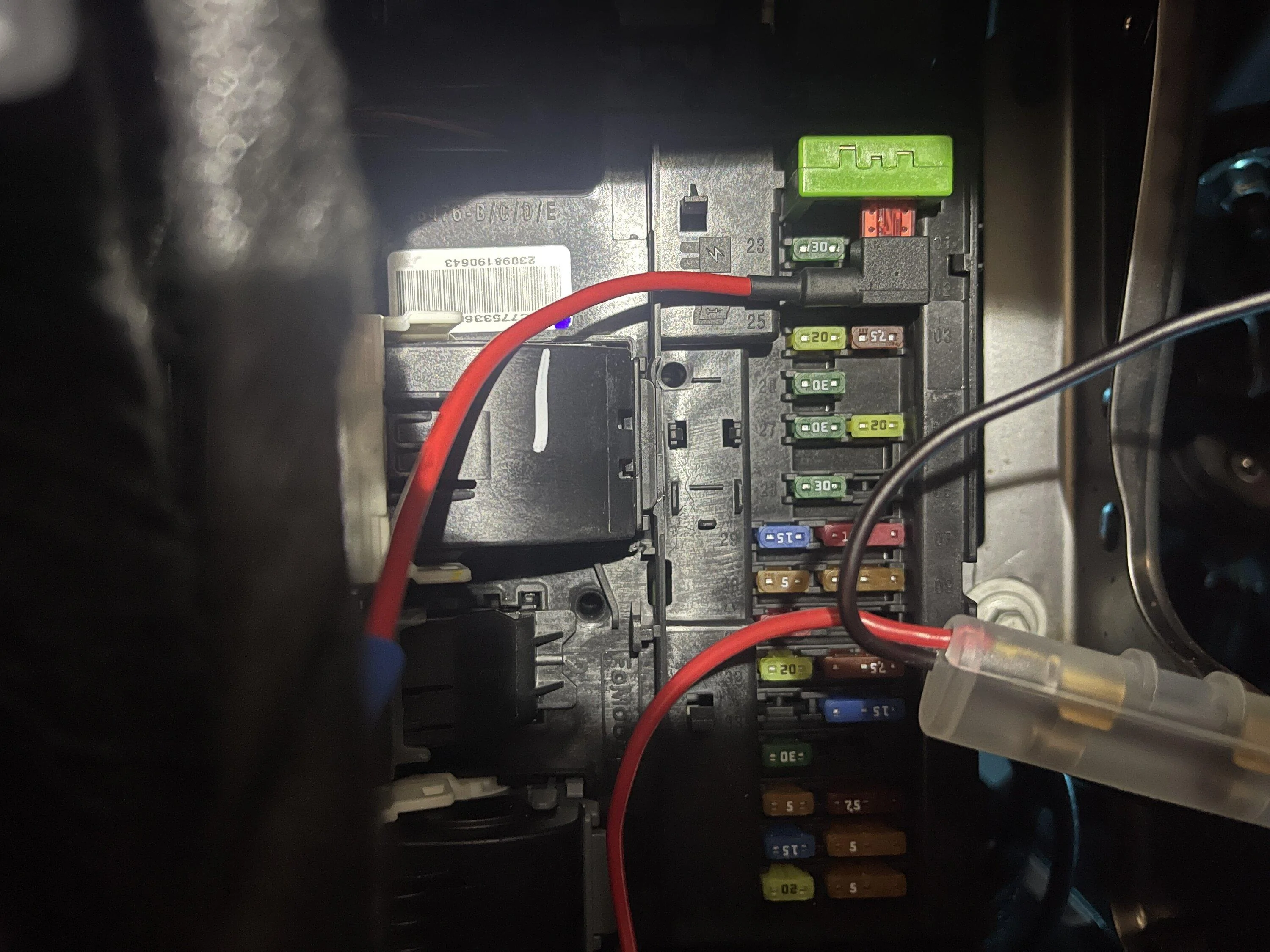

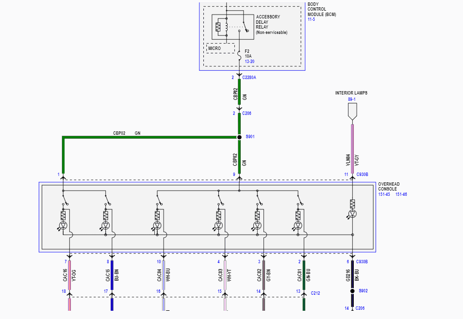

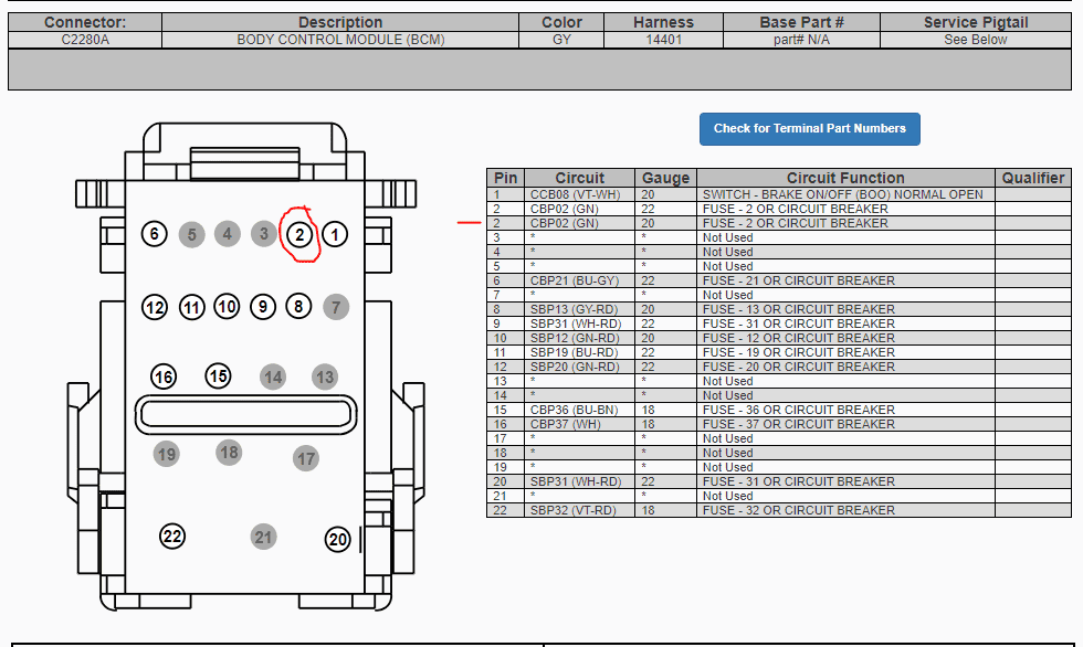

Was working on before I got caught with an extended phone call. If fuse F2 (10A) in the BCM is good, my guess is the accessory delay relay may have an issue which requires the BCM to be replaced.
There's going to need to be some testing done to see where you have and don't have power so pull the driver A-pillar trim to get to the green wire on that harness or pull the overhead console to see if you have power on the green wire. No power, then follow back down to BCM.

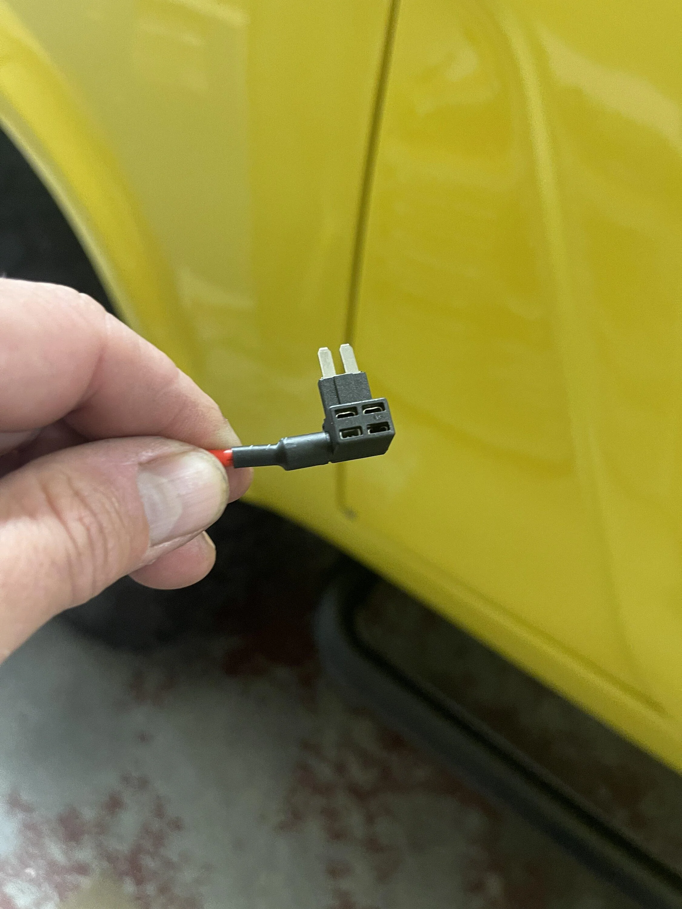

Thanks Flip. F2 is what I have my GMRS radio tied into with an add a fuse link. I guess it jarred loose. Put the fuse in the back spot of the add a fuse link and now everything is working as should. So now we know.
