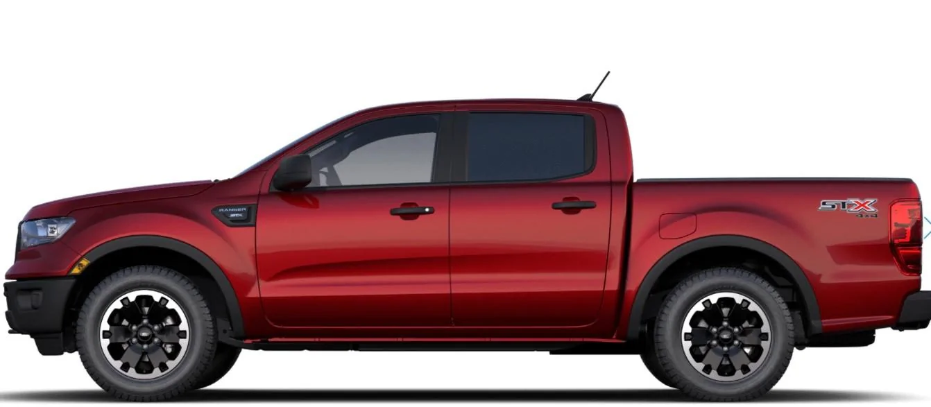

Here they are on the 2021 Ranger with the STX Special Edition package.
Ford Bronco M2DZ-1K007-A Wheel Kit specs? Size? Ranger STX Special Edition Pkg 3
