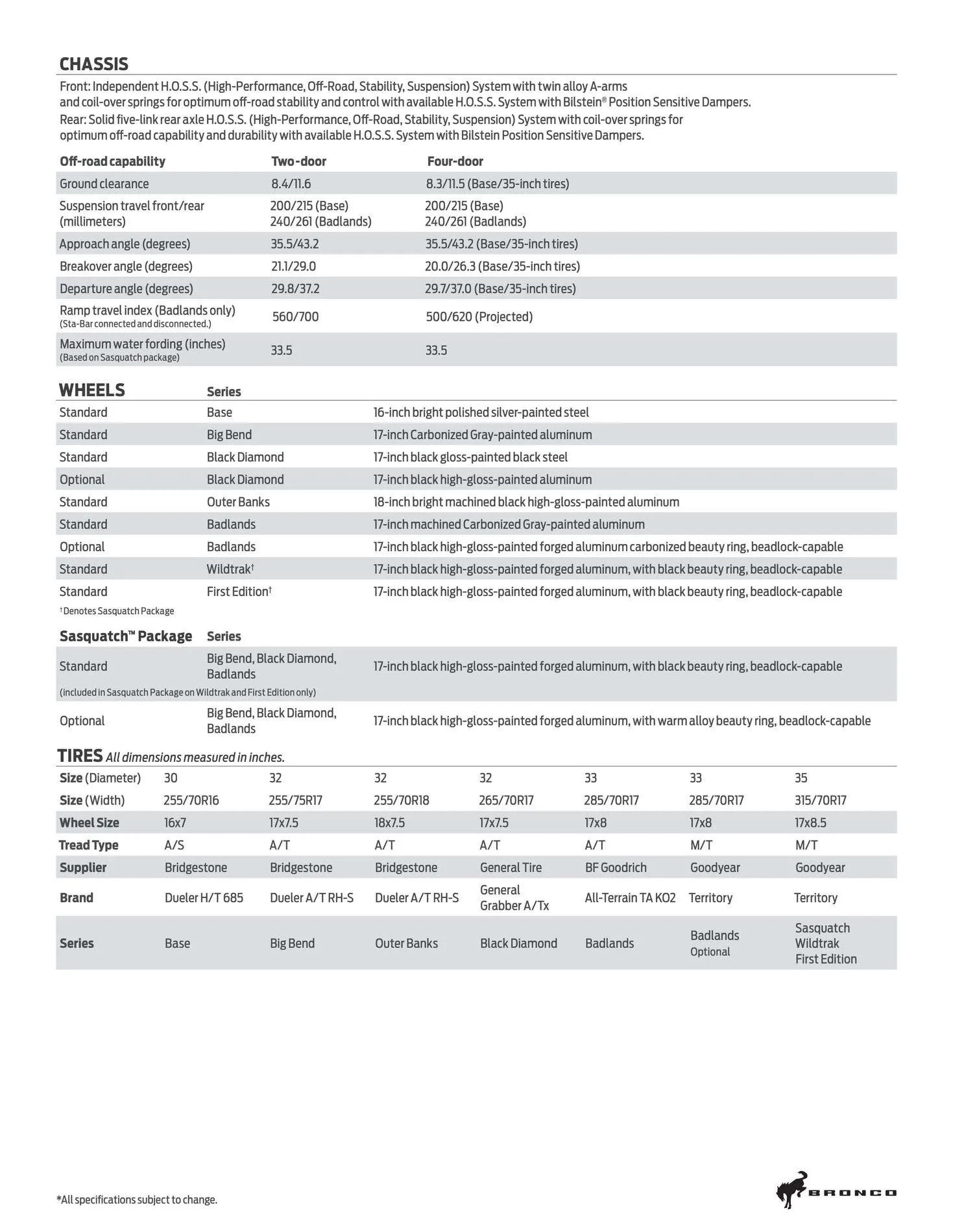

Anybody know the size of the beadlock capable 17" Sasquatch wheels? I'm hoping for 17x8.5"...

They're mated with 315 width tires so.. a lot larger than 8.5" wheel.

Oh that's great! I hadn't seen a spec sheet

It says on the Spec Sheet 17x8.5
it must be different when dealing with off road tires but typically a 315 tire requires an 11” wide wheel to get the appropriate contact patch.

Stock Jeep Rubicon wheels are 17x7.5" which are barely safe with 315/70s and most tire shops won't put a 35x12.5 on a 7.5" width wheel. 8.5s are great!!
