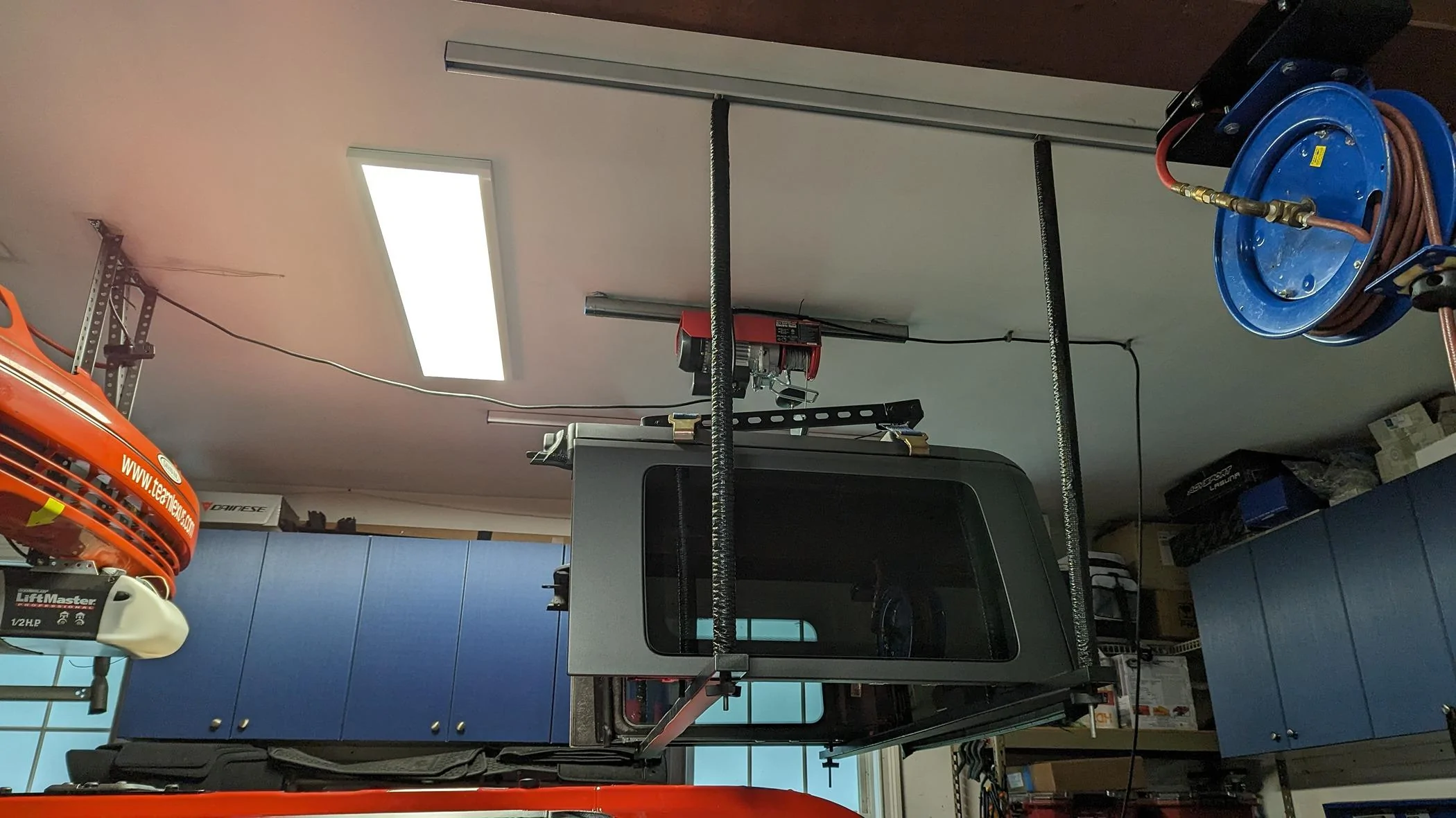

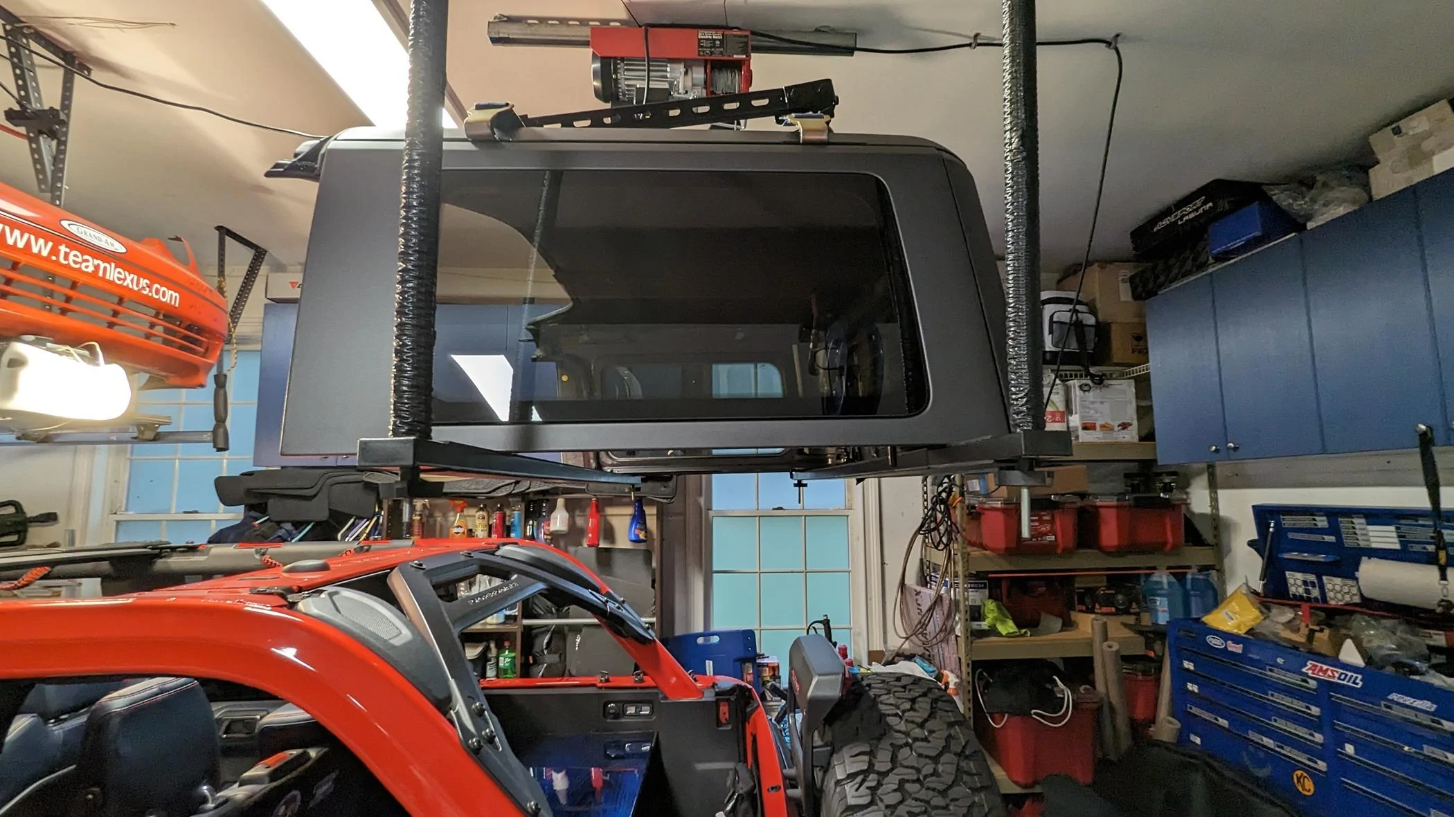

Closeups of my floating shelf for my hardtop - gonna add a 3rd pair of threaded rods at the front and an aluminum rectangular tube - that'll give me the extra span I need to store my mid panel turned longways. As you can see from the hoist straps - all pressure is relieved from the MIC top.

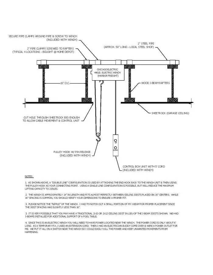

I saw a thread in here where the guy mounted the hoist in his attic and ran the cable through a hole in the ceiling...saved a lot of room. He had shot ceilings also
This is what I designed and installed back in my Jeep days. Can’t believe I still had the CAD file, lol.
Anyhow, in my case I had tall ceilings…close to 10’ tall. However, this design would work great for any height ASSUMING YOU HAVE ATTIC ACCESS ABOVE THE GARAGE.
For the Jeep I bought seatbelt straps and had a custom harness stitched by a local seamstress. Included a D ring for a pick point. When I would lift I threw a blanket on top of the hard top and would then (gently) snug it against the sheetrock for max clearance.
I haven’t decided what to do with the Bronco yet. As much as I like this concept, I have living space above the garage so this design isn’t practicable for my current scenario.
