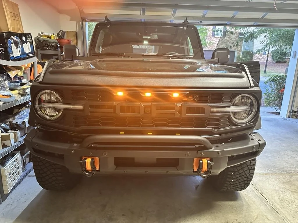

I bought one of the eBay Chinese mod bumpers, swapped out my capable. Actually the hardest part was swapping out the sensors and wiring harness, other than that it was pretty easy, bolted right up. It came with bolts but I used the bolts on the old bumper for mounting. If you search YouTube you will find several howto videos.

I just checked, the vendor I bought from he is sold out. There are several vendors on eBay selling pretty much if not the same exact bumper. I think the Chinese vendors get the bumper from the same source. My bumper had a $900 buy it now price with free shipping, I made an offer of $650 and he took it, made the same offer to two others and they declined or made a higher counter-offer. Others that either bought or made offers aren't getting those lower offers accepted, maybe because I was one of the first to buy the bumper, I've been hearing in the $750-$850 range. Try different vendors and if you don't mind waiting see if you can get one to take a lower offer.

I didn't have any issue with the the wiring harness or the sensors, the Chinese Mod comes with the plastic sleeves for the sensors so you just pop the sensors in, I remember seeing on one of the YT videos where a guy doing the swap with a factory Mod bumper had to make an adjustment by trimming two of the plastic sleeves from the Capable to get them to fit with the Mod. I also installed some fog lights at the same time, you can see them in my photo, I was able to use the connector on the factory bumper harness and of course the factory switch from the Capable installation. All in all I thought it was a pretty easy installation except for the part of having to dismantle half the bumper to install the wiring harness. I was afraid the bumper harness might not reach where it connects to the vehicle harness but not an issue, connected right up with some to spare. Make sure you put the sensors in the exact order you pulled them out of the Capable bumper.
