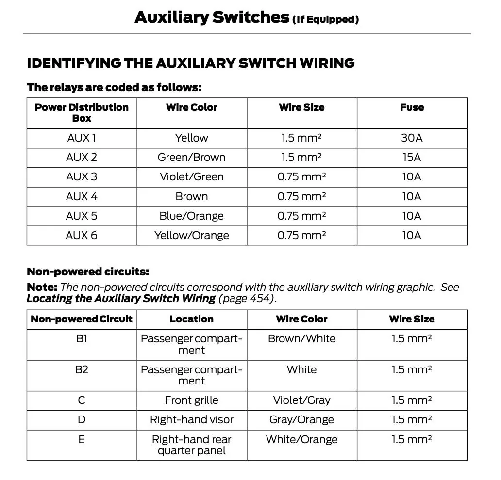

My question here for those that have added after market fog lights is this. Considering you have the added AUX switches from the factory, is there wiring already in place to the front of the vehicle that makes for an easy "plug and play" or are did you need to run wires through the firewall to the switches? If the addition of fog lights is fairly straight forward I will probably keep the Modular bumper vs change my order to the Capable one. If it's running wires, my thought is to switch to the Capable bumper.

Ford's page describing the how-to
Bronco Nation's how-to
Bronco Nation's has a good video. In the owner's manual I believe there is a description of which are accessory powered and which are hot all the time; bottom of page 455 2022 manual; 459 in the *.pdf.

Thank you Robert.............I'm pretty handy, can turn a wrench and do some wiring, I'm just trying to see how involved this mod is.

Sadly, mine is slotted to be built on the 24th, and I would assume it goes to Ice Mountain from there so I don't have one physically in front of me. I MIGHT be able to pull a wiring schematic for you from Ford, to see if there is a harness already wired and not used that you might be able to steal... the best I can do is try tp pull pics for you following the inside of the fender and the schematics. You tell me what you NEED, and I'll do what I can dude... just sucks not having mine yet or I'd be WAAAAAAY more helpful.

Looking at the schematic you sent and watching the video of the aux switches, it looks like the wiring is already to where it is needed. Once I get mine, maybe by Fall of 2022, ( I ordered on 10/13/21) I will look more into the details of this modification. Doing these things are fun and I am looking forward to doing it, just need that Bronco to show up and the line is LOOONG.

Might find this helpful as well...
