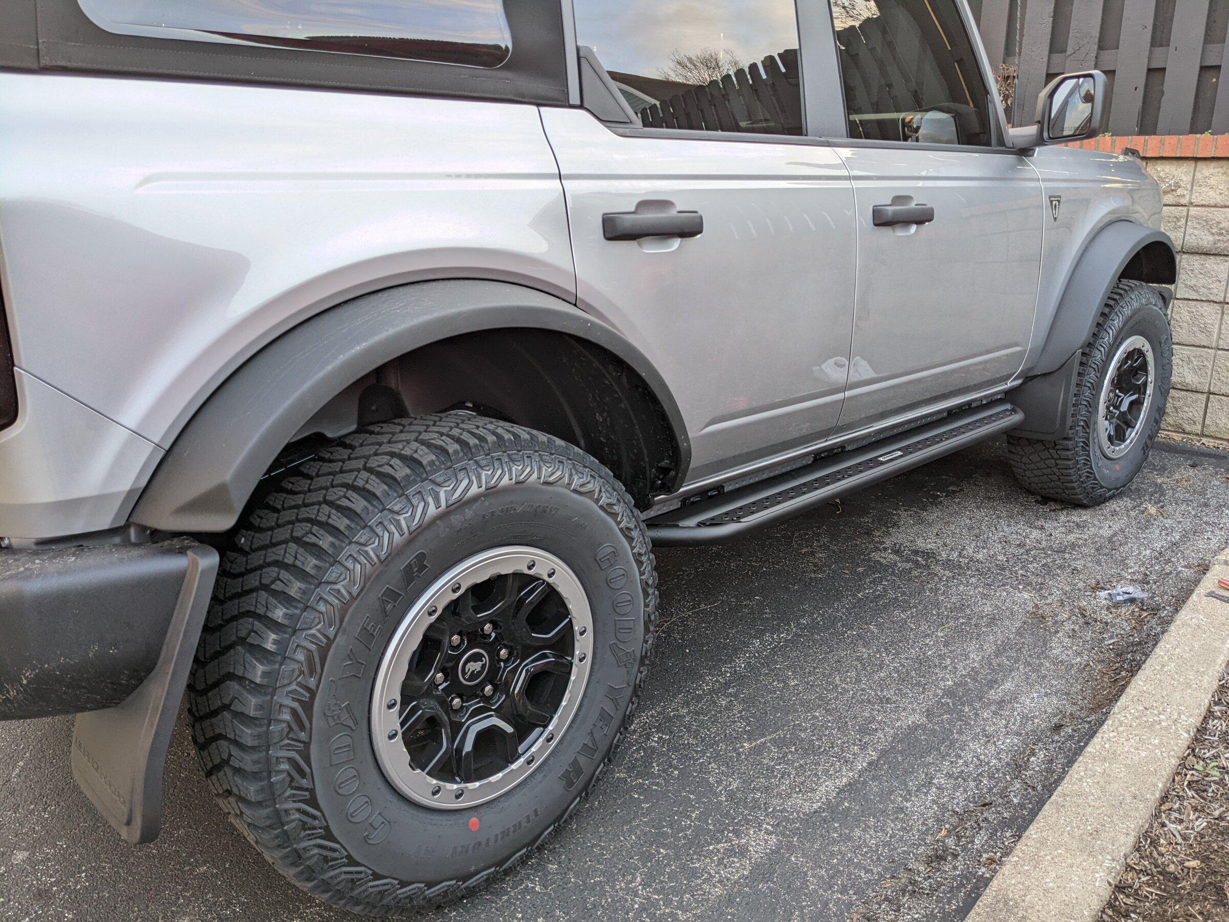

Fronts take about 20 minutes each. Rears go right on 3 screws each side. I used blue painters tape to trace the cut out needed for the Sas flare. Then cut them wide, meaning add a little extra flap ⅛" or so and it will fill the gap nicely. It's a 2 beer job.
That's spot on. On mine I had to take the small plastic filler off the back and the bolt holes were not in the same location. I had to make all new mounting holes for the rear as well, but it's just plastic so only took a moment

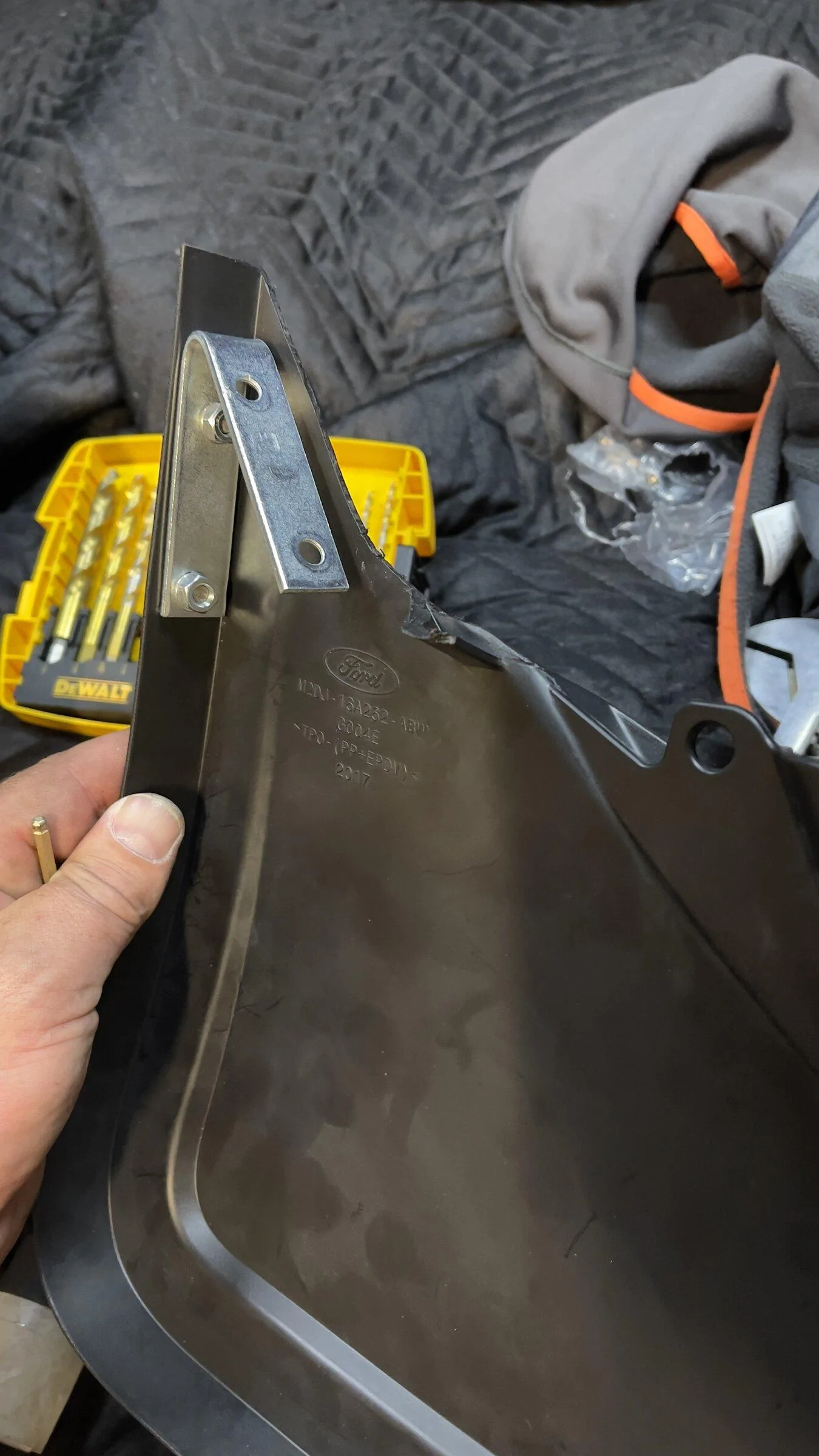

Ford Bronco Mud flaps for Sasquatch ? JPEG image 2
This is what the bracket looks like. This is one that @Roll Sound did for his. Mine is copied from his design.
