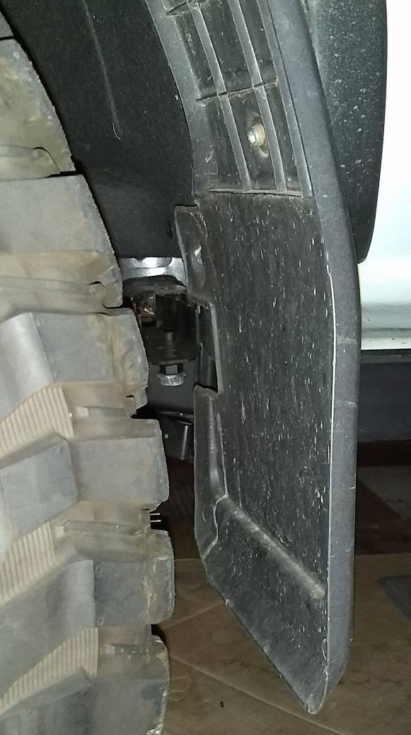

I have 17x9 with -6 offset wheels and my km3 35's were rubbing the mud flaps at full lock even after trimming them a bit. So I know those flaps won't come close to working with 37's.
Here's the ground down flap that was still hitting the 35's on the inside edge.
