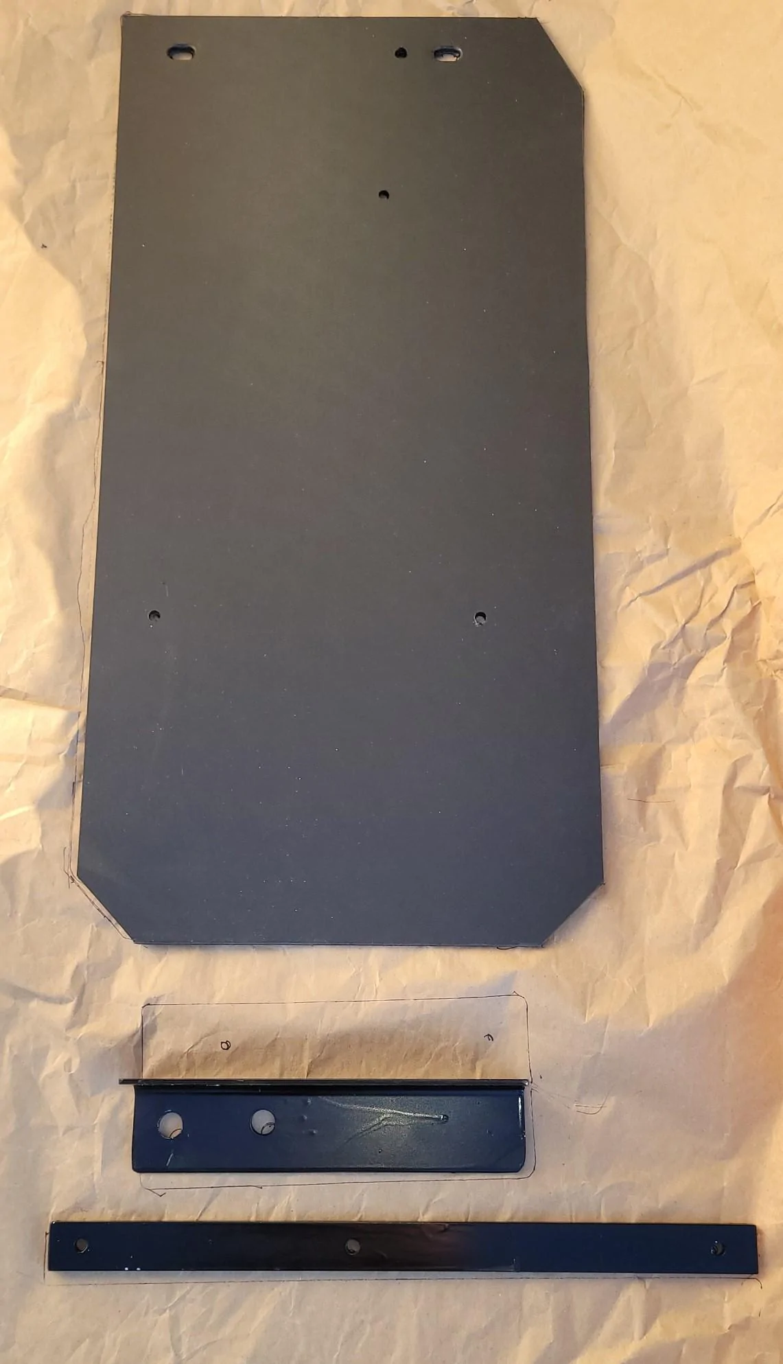

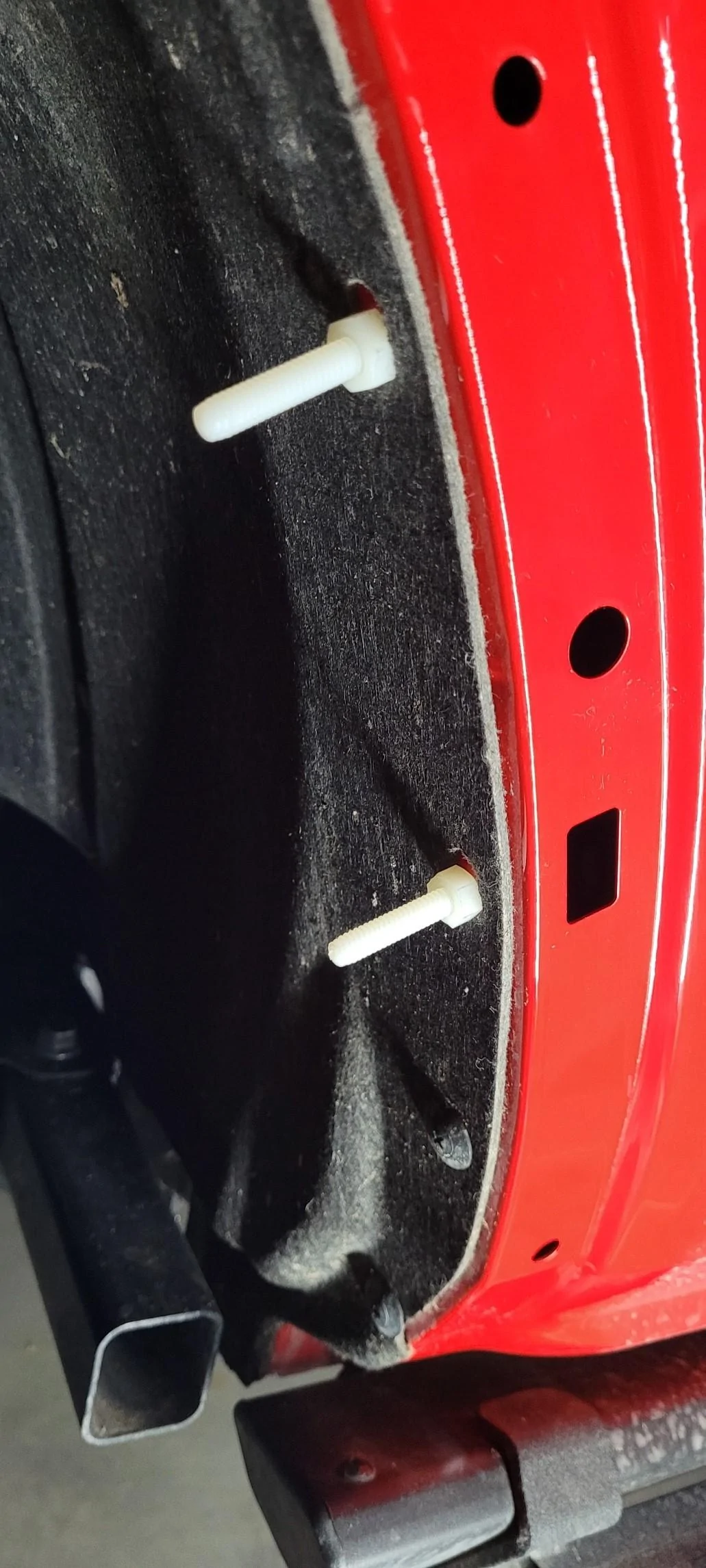

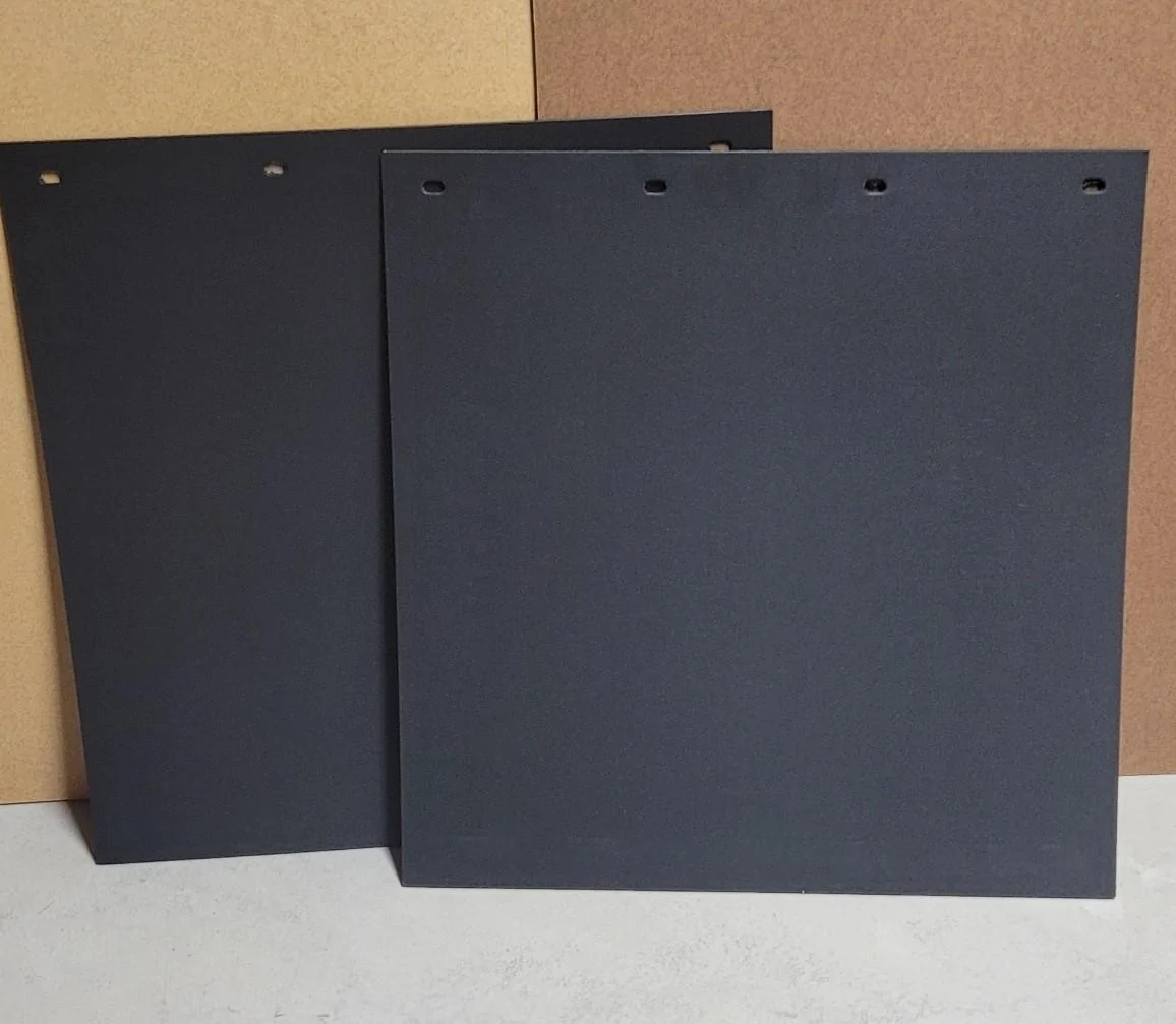

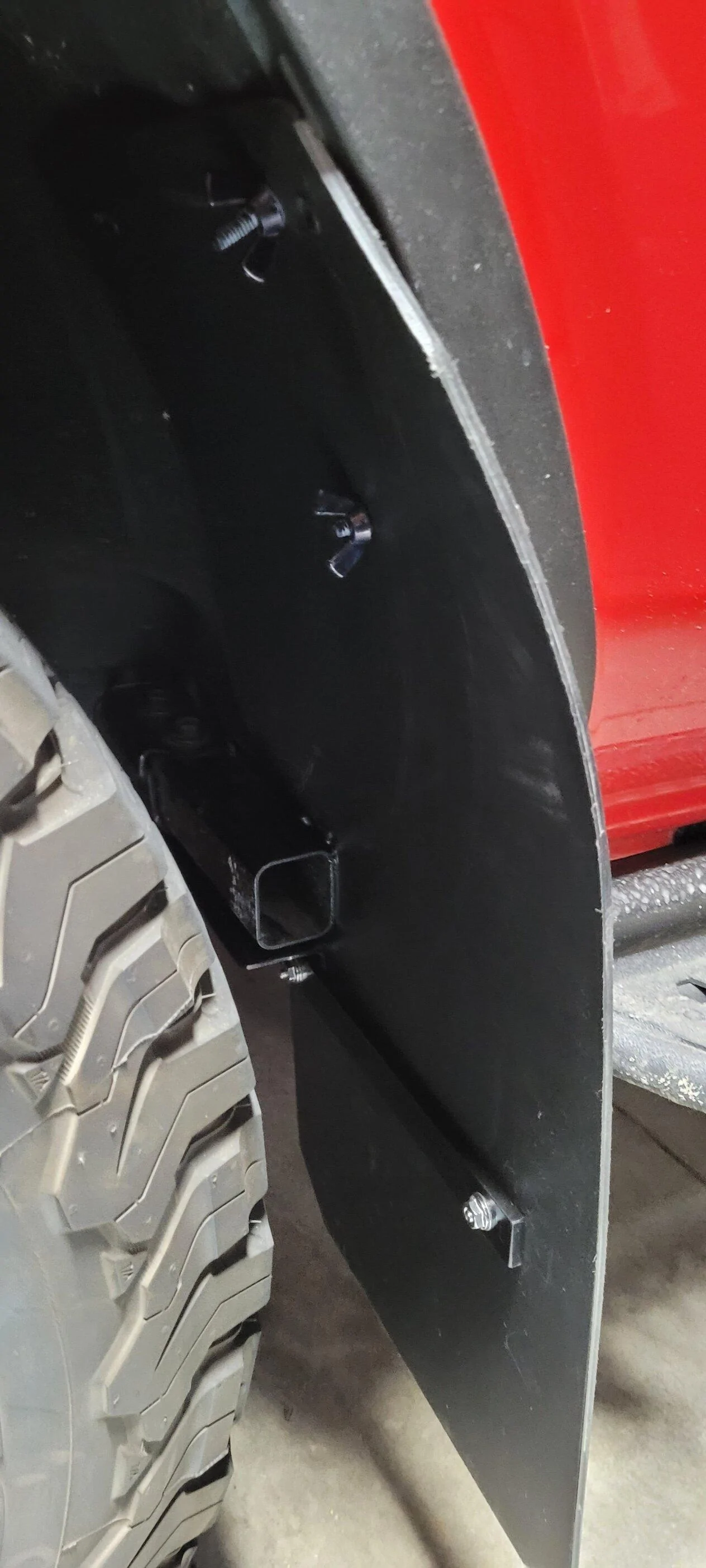

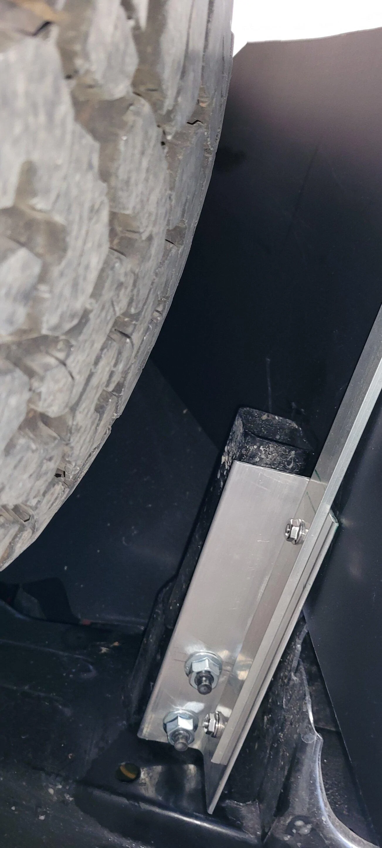

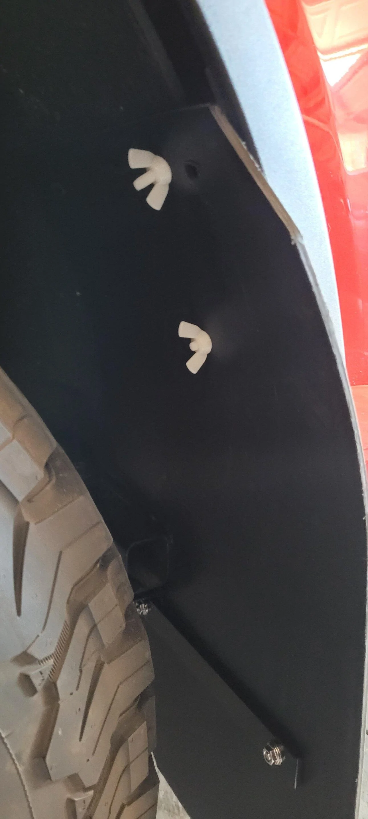

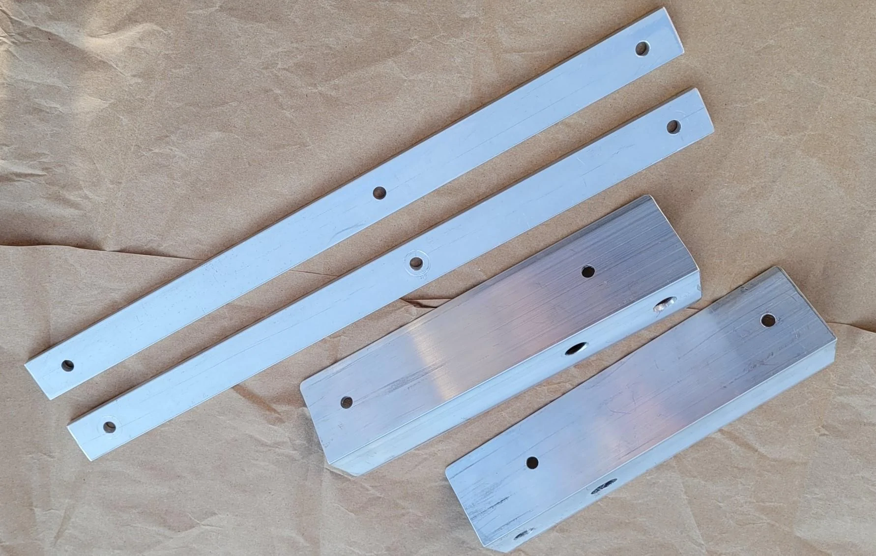

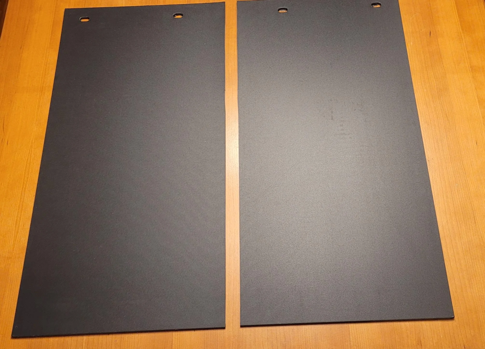

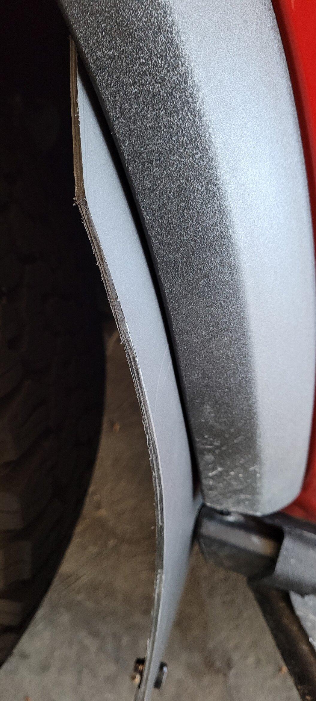

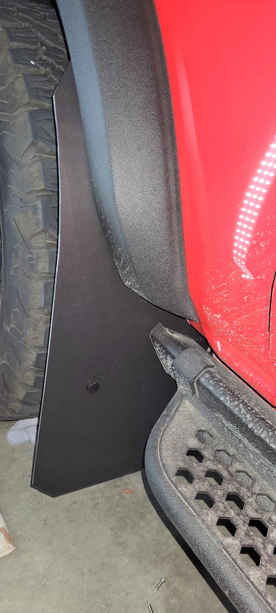

I have a Badlands with the factory rails. Just did a DIY using $28 Black Polymer Mudflaps 24x24" from Amazon (listed as 24x30 but spec is 24x24). Used one panel and split in two. Since I didn't screw up, I have a panel to use if I do rears. Made brackets from aluminum stock I had and a small purchase of 2" 90-degree aluminum angle stock. Stainless nuts/bolts flap to bracket. Used nylon wingnut/bolts to make quick removal of flap (or to access flare lever if needed) along with removing 2 nuts securing bracket to bottom of crash bar. Was able to get flap between rock rail and inner fender/crash bar. As installed, the bottom of the flap is about 7" from the ground. Now I need to find some mud/winter to test out.
