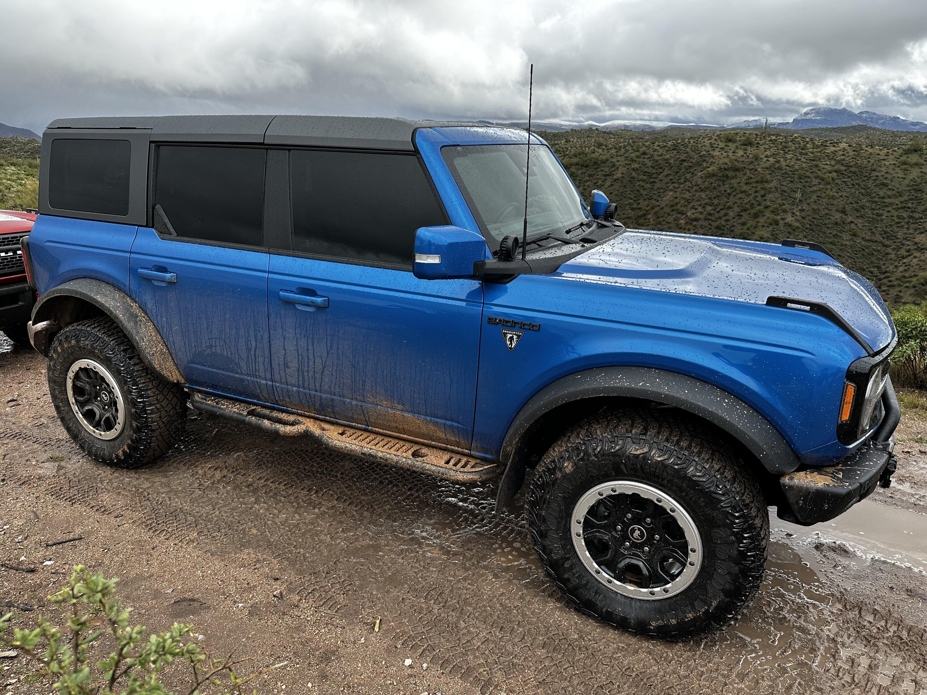

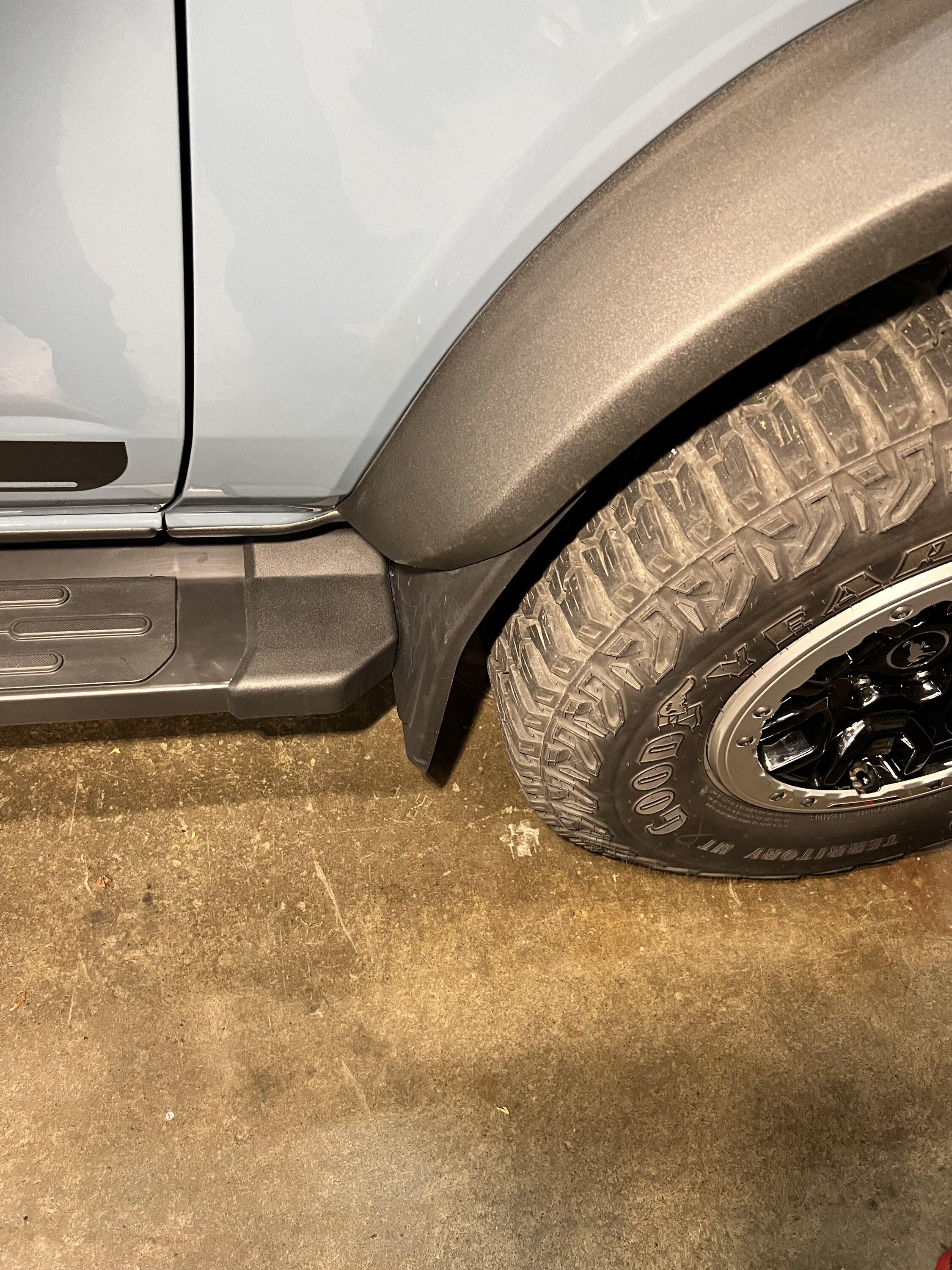

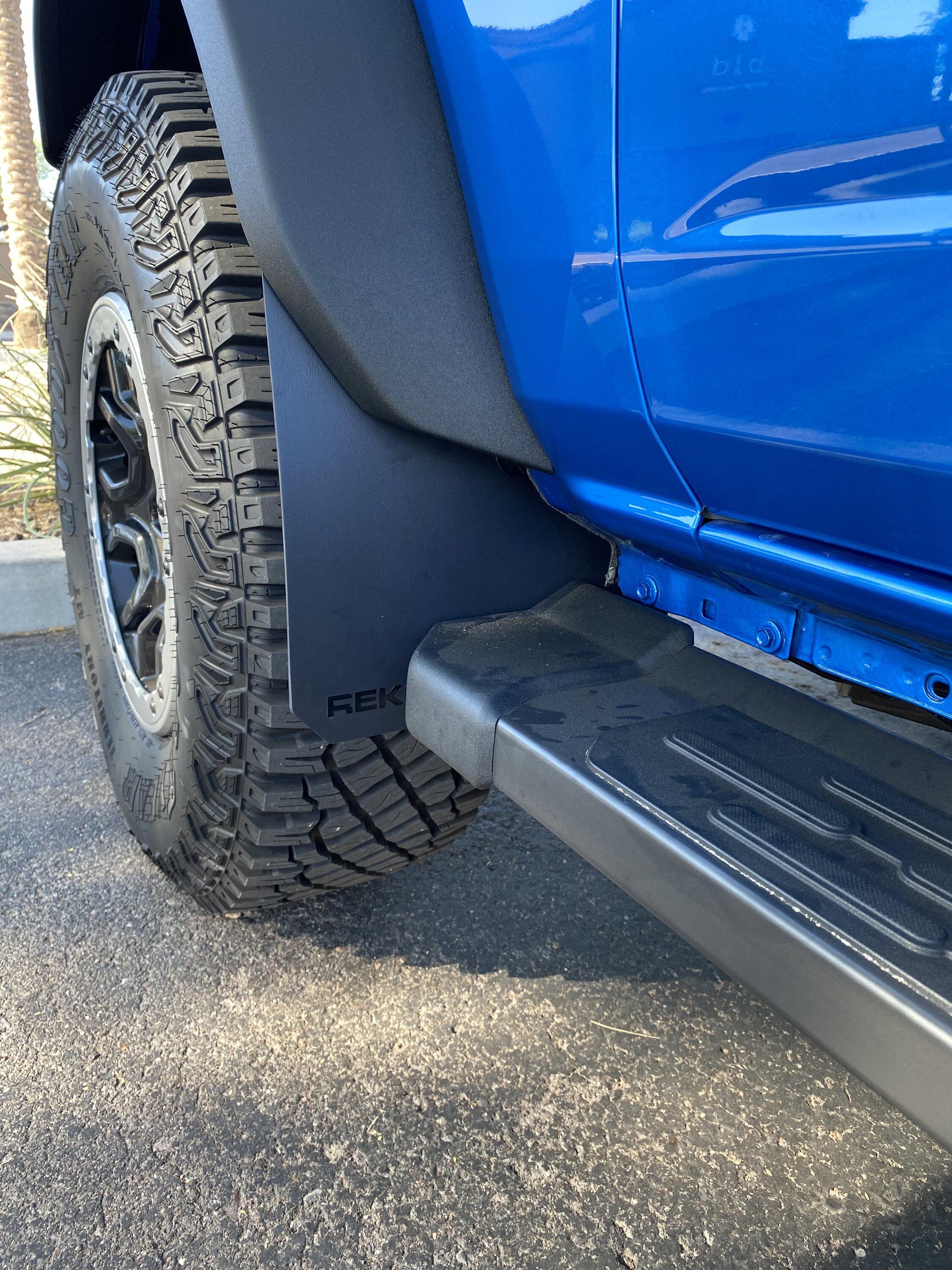

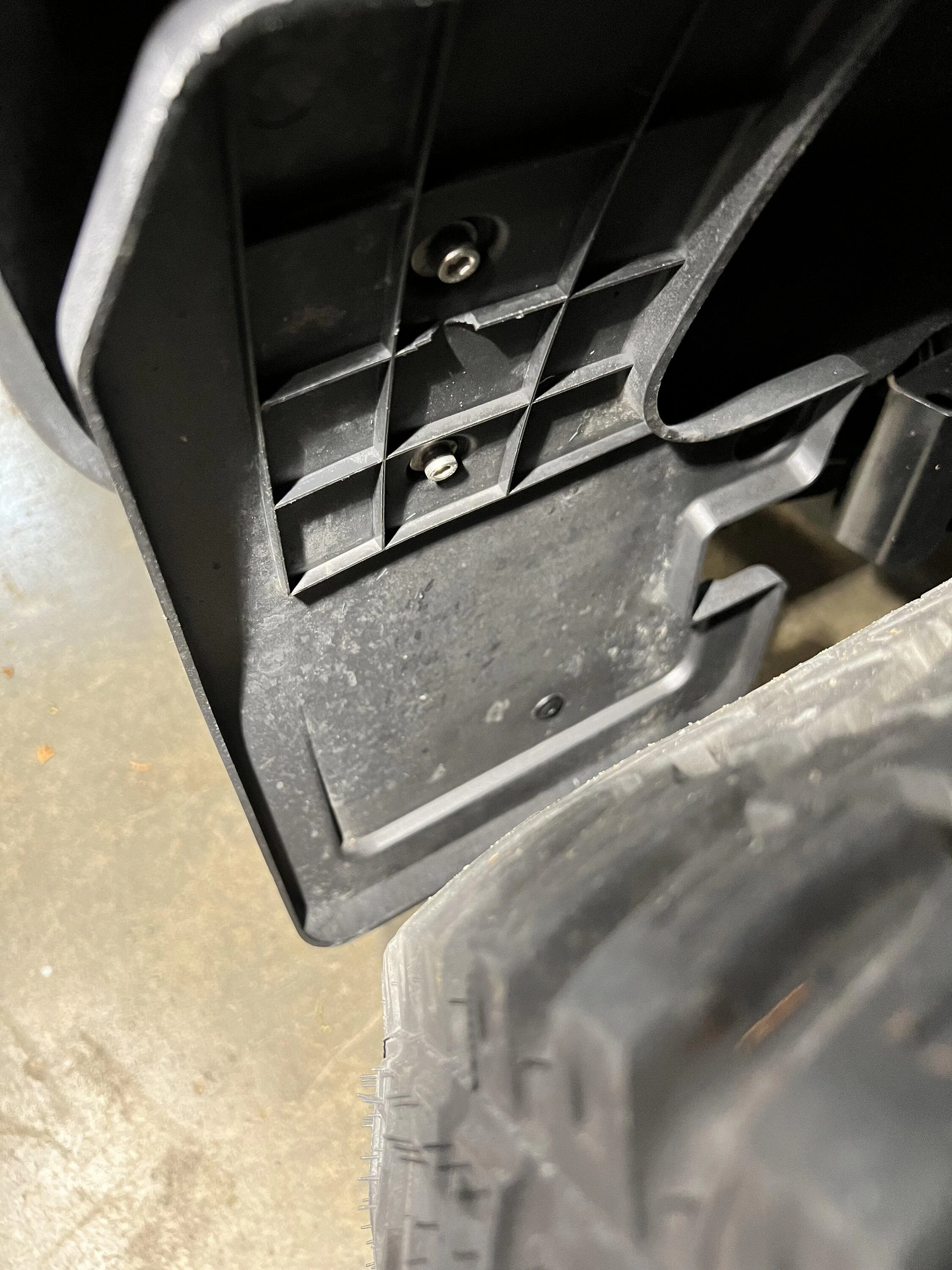

RekGen (non-XL) is what I haven on front only and do a great job stopping rock chips. The running boards themselves also help. I have since replaced my factory running boards with DV8 rock slider steps, but having the same positive results.

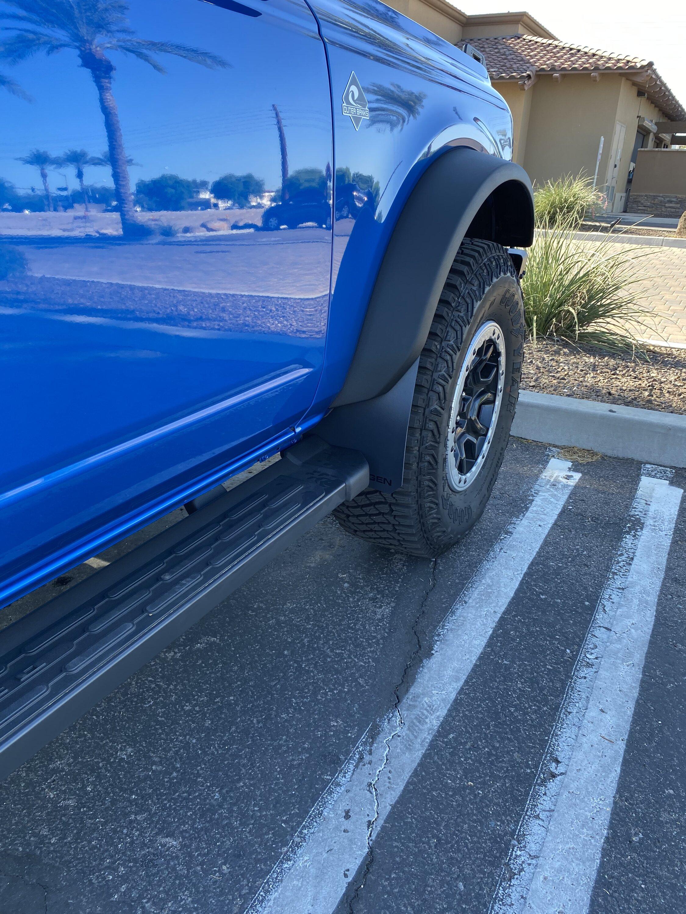

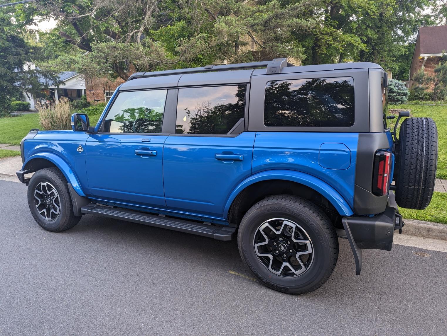

The factory ones will work but you will have to move the running boards back about 1"+- to get the front ones on the way they are designed to fit. Ford?? The factory holes on the running boards won't line up but I just used SS tech screws and it worked fine. I installed all 4 just because I like the balanced look.

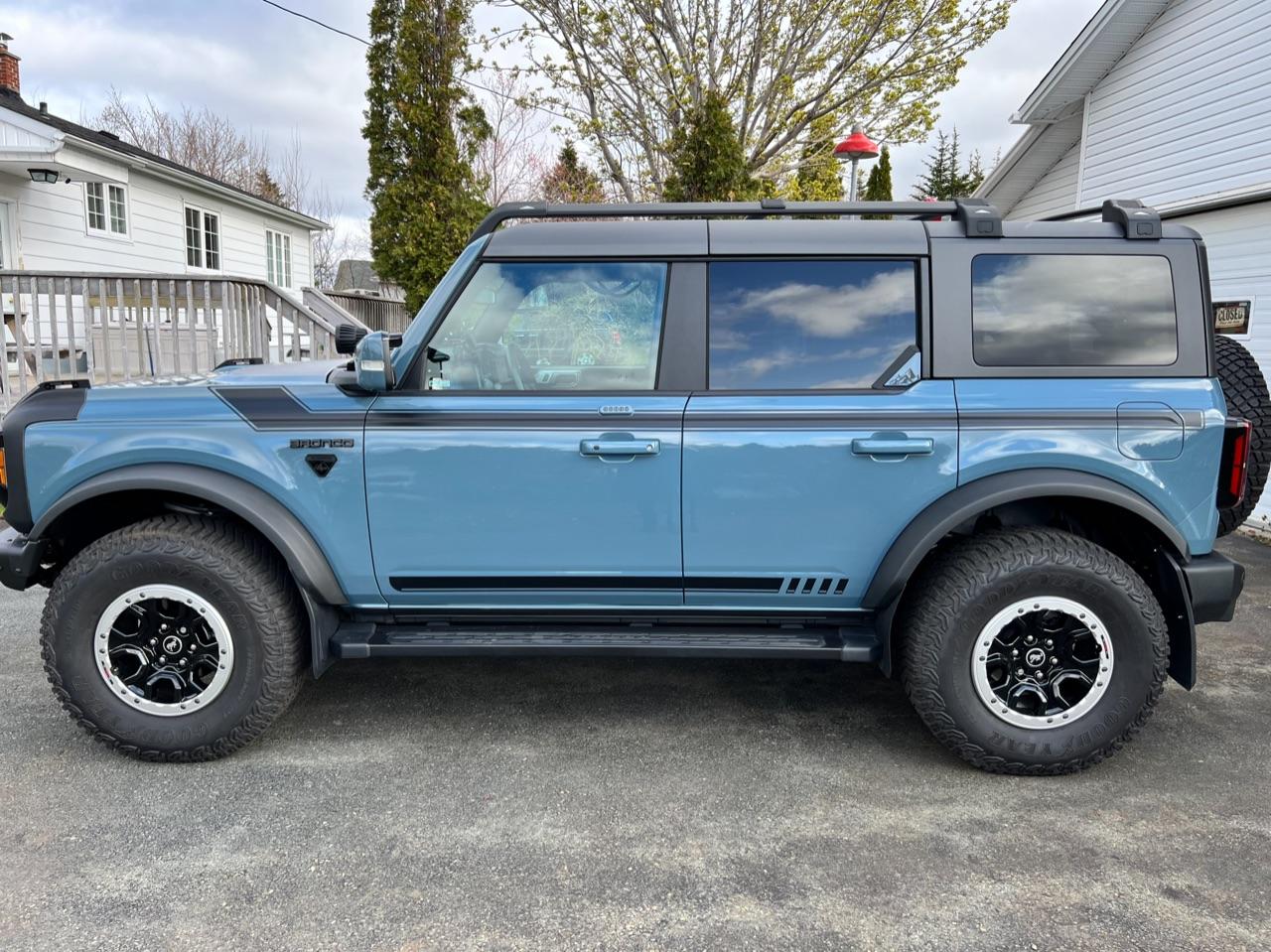

I put the Mabett ones on mine. Find them great. They’ve been on our Sasquatch for almost a year now.
Ford Bronco Mud flaps for OBX with Sasquatch package PXL_20230512_234911216
Do you get any rubbing in the front? I went with these at the advise of my salesman, he had already tried 3 different types. The Fronts don't fit tight to running board, and rub when turning tight. I am thinking of using 3M tape to secure to running board to pull away from tire. Terrible idea?
Appreciate any input...
Wildfire1
Paul
Jan 14, 2021
334
736
Nfld, Canada
1993 GMC 4X4 / 2012 Mustang convert

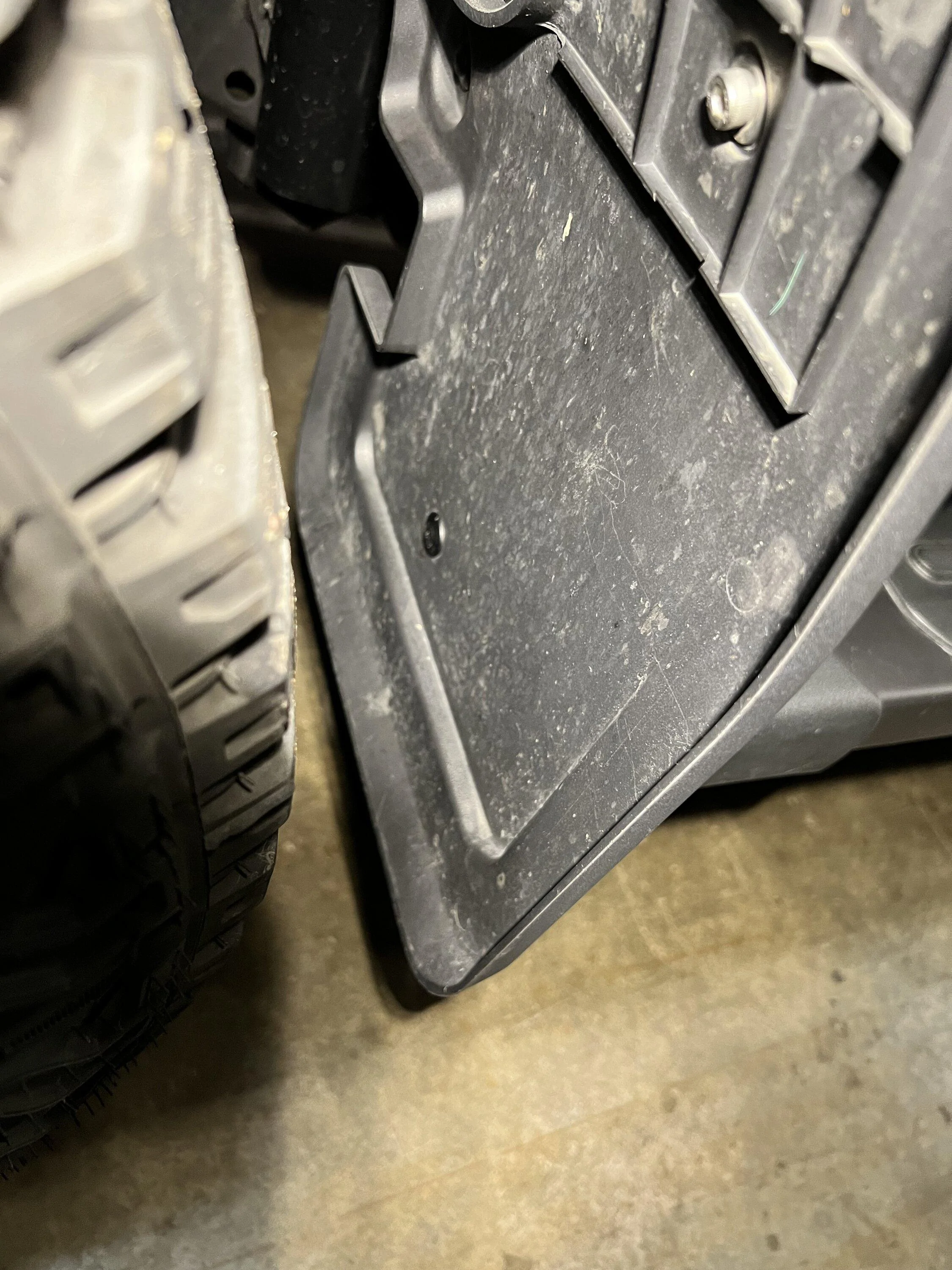

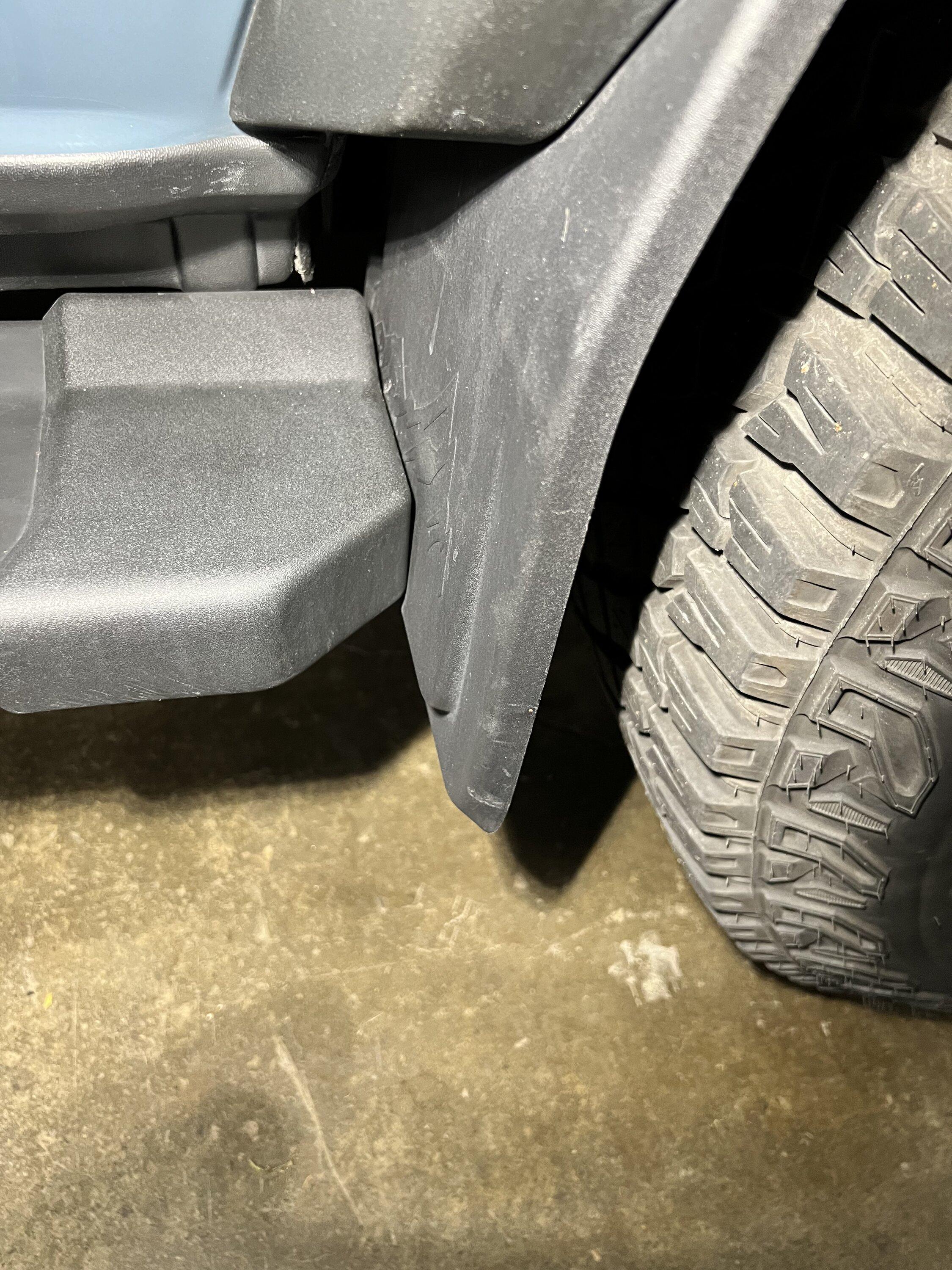

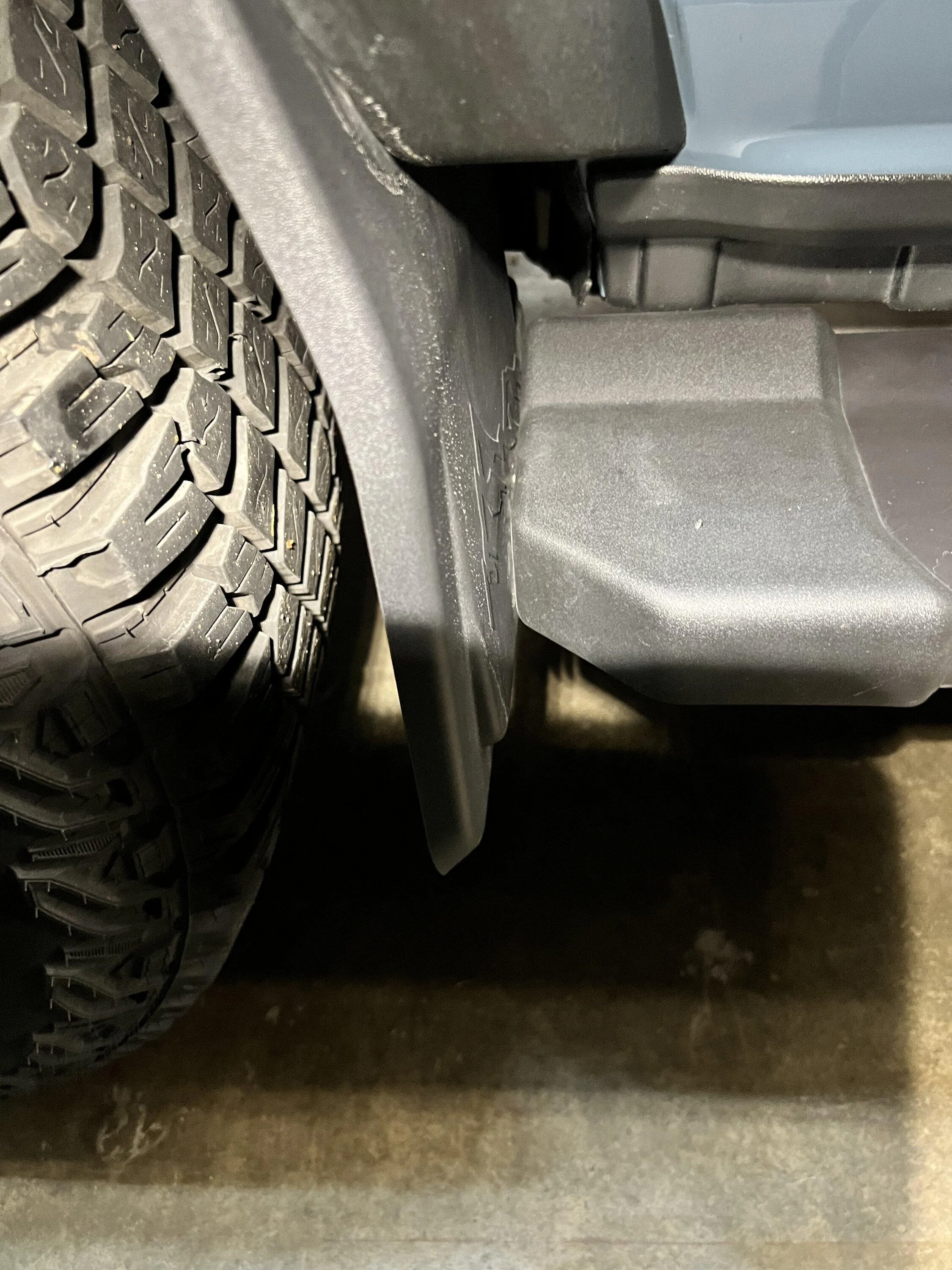

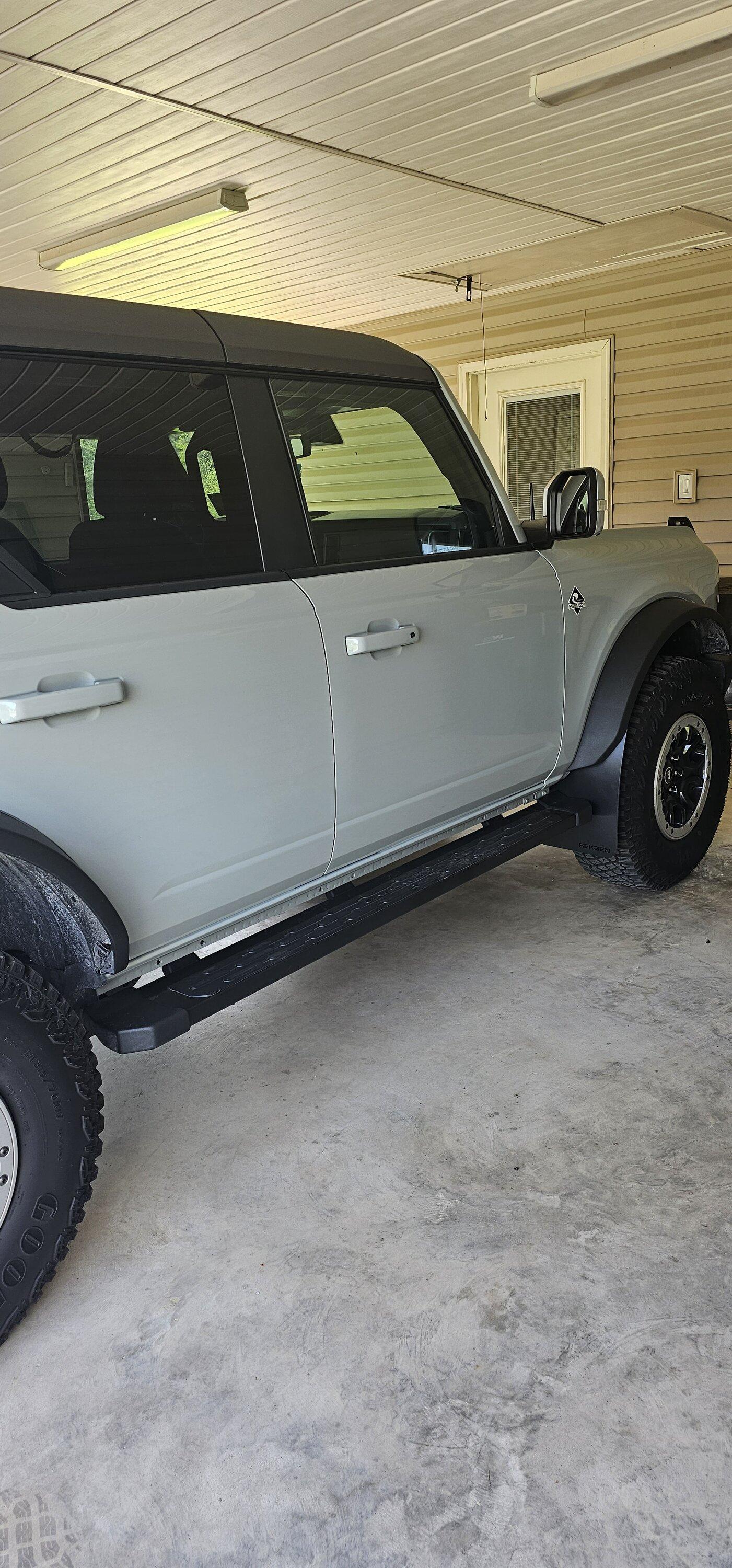

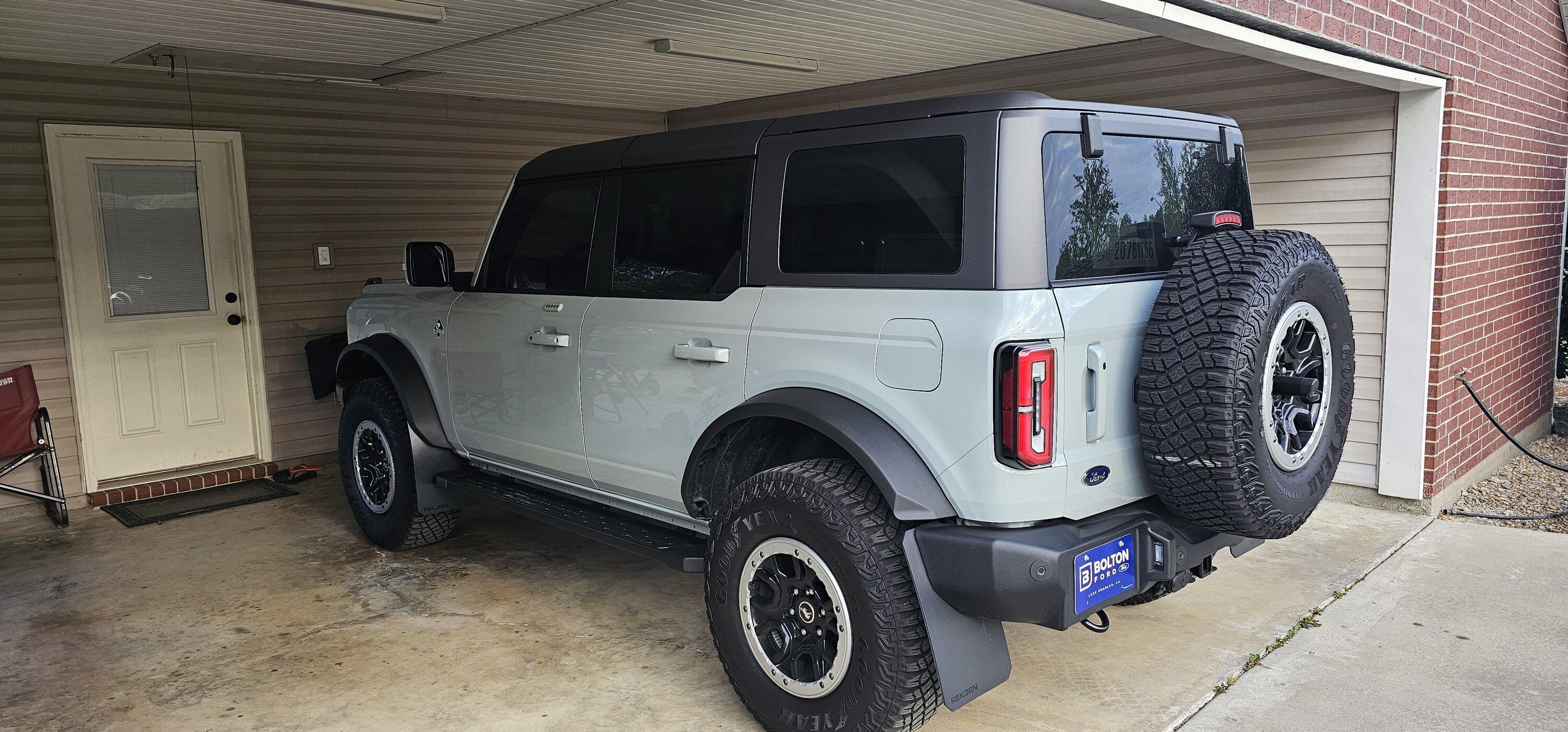

I’ve had mine on two years now with no issues at all but I did notice during the installation that there was a small gap between the running board and the mud flap so the simple fix for that was one 1/4 plastic rivet on each flap to close the gap which you can see in the pics I just took for you.
