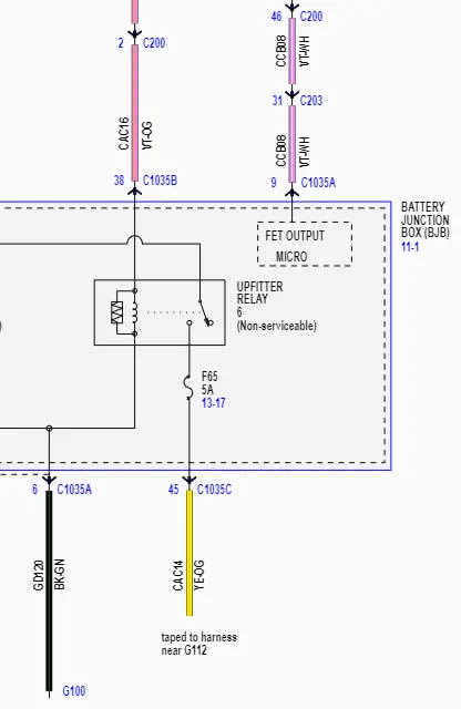

When you say you "checked the fuse", which one do you mean? The 5 amp fuse marked F65 to upfitter relay 6 in the diagram above?
That fuse is on the LOAD side of the relay, not the control side. The switches could be on either the ground side or the power side of the relay control circuit, they don't show on that diagram so hard to tell. The fuse could be good or bad, it won't matter if the problem is the switch itself.
