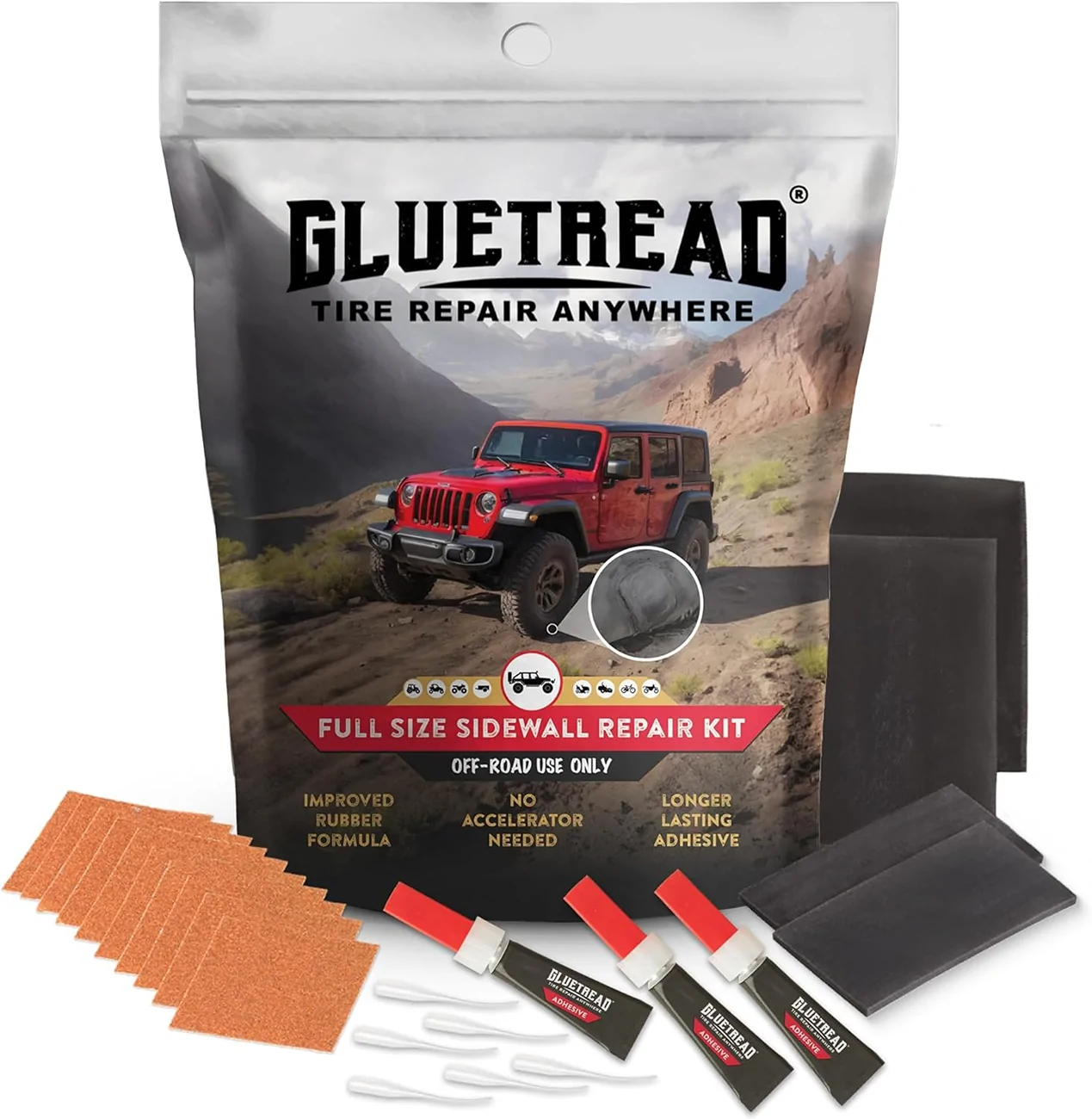

First take the tire to another tire shop or two and see if it's really beyond repair. Maybe as a limited use spare. Promise them you'll treat it as a limited-use donut. Of course, you may not want that if you have a flat backcountry
I sliced a sidewall on my 35-inch OEM Goodyears at about 25,000 miles. I wish I knew about this, then. I do carry it now, even on my daily drive:
Ford Bronco Need to replace one tire, any options? 1765069071770-a4
Check out online videos. Available on Amazon, but illegal (n)in my "Progressive" state.:mad: I could have fixed it for limited use and worn down my OEMS. As this option was not available, here's what I did:
I shopped around and got a good deal on my next set (KO2s, as things turned out), and bought five. I had one mounted and put on the tailgate as my spare, then kept my OEMS on the hubs, beginning a 4-tire rotation. I stayed with those OEMs until I hit 53K, then swapped them out for the 4 remaining KO2s which were in my basement. Now, I'm back to a 5-wheel rotation, doing fine. (I think I could have worn them another 7K-10K but that would have compromised my off-roading.)
To summarize, I think your best bet is to see if a single tire replacement is feasible at 12K. Dealers may say they can't do it because the tread difference is too great. (That would be true with runflats.) Maybe, maybe not. Get 2nd and 3rd opinions. Consider a radical repair, maybe a DIY? Or maybe buy the whole replacement set, and wear down the KO2 you have.
Let us know what you do!
