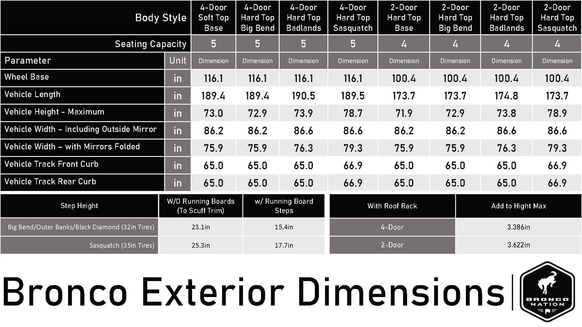

Thank you very much!
Not sure that chart is accurate. Two different sources have listed the Squatched Badlands hard top at 75.9" and I thought I read something about this BN chart not being accurate. I'll be curious to hear others chime in.

Hmmm. I'll still measure and see if the height above fits and go from there. If it fits, going by this chart, then I'm all good. Until it goes on 37's. 😆

I have the same question for my pending SAS badlands. Does the max height listed include the roof rack? Hoping someone with an actual SAS bronco can give a real measurement. Not that I don't trust ford specs!

You know what, I bet that BN chart is with the roof rack now that you mention it.

Look in the lower right corner of the chart, it tells you how many inches to add for height with roof rack based on how many doors you have

I saw that and was assuming it meant the height included the roof rack. If it is really added that puts a 4 door SAS at around 81". Dang that is tall.
I'm worried about the 78.7" height though. Not sure that will clear my garage entrance.

It would be great to see some actual measurements from owners. Some of the B6G members are meticulous and I would probably trust their real world measurements more than anything we've seen published to date.

Mine measures about 75" to the roof and 78 1/4" to the top of the roof rack. Both measured at the rear where it appears to be highest. That chart looks to be pretty close for my combo since I probably have 50 pounds of tools in the back.

Sweet! Thanks for a real measurement. And I am jealous you have your but good for you.
