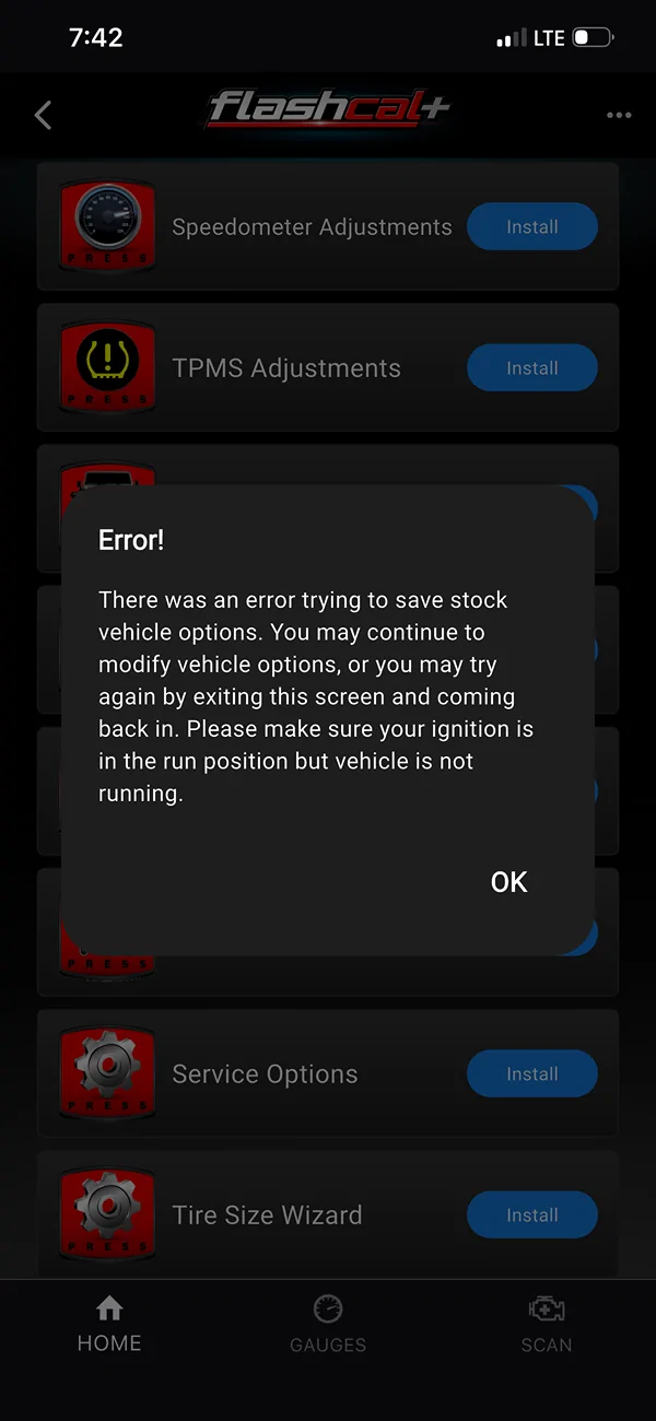

Received module, unable to upload data for Goat modes.
Says it's not allowed on my 25 Badlands.
In fact, it doesn't load up any GOAT modes, all say they are unavailable and not allowed.
Doesnt modify lights, nothing...
I do have the Ford Performance Procal in play.
2.7 auto
2.7 auto
I got the same thing the first time I tried it.
I did closed the app, removed and reinstalled the module, turned ignition back on to run, opened app and updated the device.
I have not receive that message since.

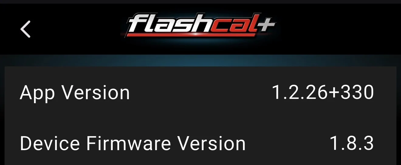

Hi @Superchips_Mktg,
Is the 1.8.3 version the most recent firmware for the device?

BlueDewey
Dewey
Feb 20, 2026
Georgia, USA
Bronco Badlands
Edit from earlier post (last night) Had to download updates...took about 8-10 minutes with device plugged into vehicle. Then it worked.
Got out there at 5am, couldn't leave it alone.
Sport mode 'added' 25 badlands
