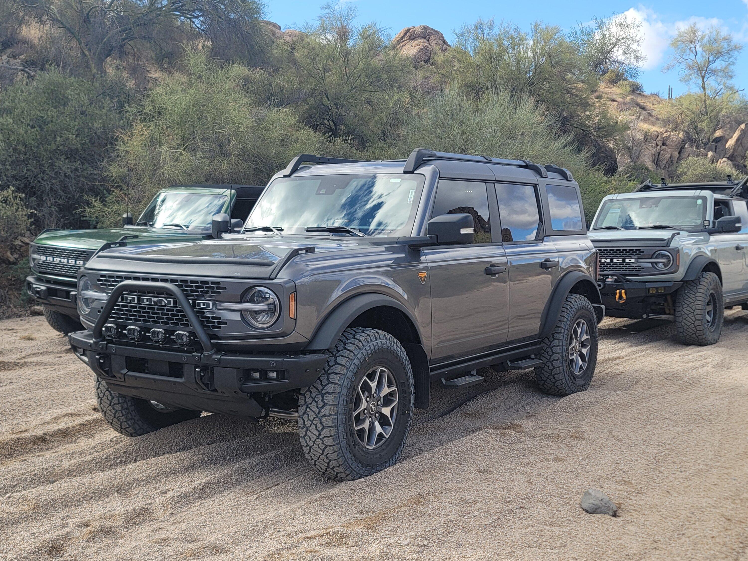

I like the wheels and tires on the truck behind yours! I want wider taller tires.

BTW I didn't mean any disrespect. Your wheels are beautiful - however that depicts what I am trying to accomplish and compare different wheels. The ones in the back is what I was looking for in terms of offset and width.
That looks like about 0 offset, he has the wider flares. If you want flush or a little poke with your flares you should be looking at the +20-30 range.

Really? I guess I wrongly thought the 0 offset would put the wheels about even with the body (not wheel well liners). I was thinking I needed -12 or so to get good width. but -12 might and probably is TOO much.

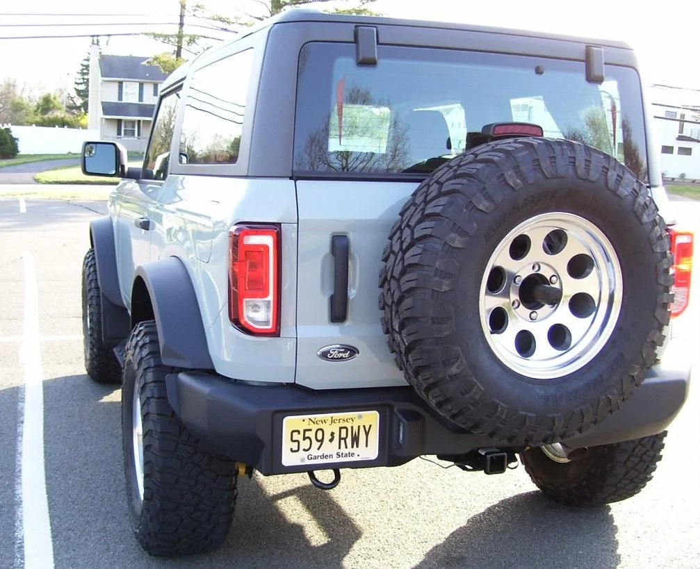

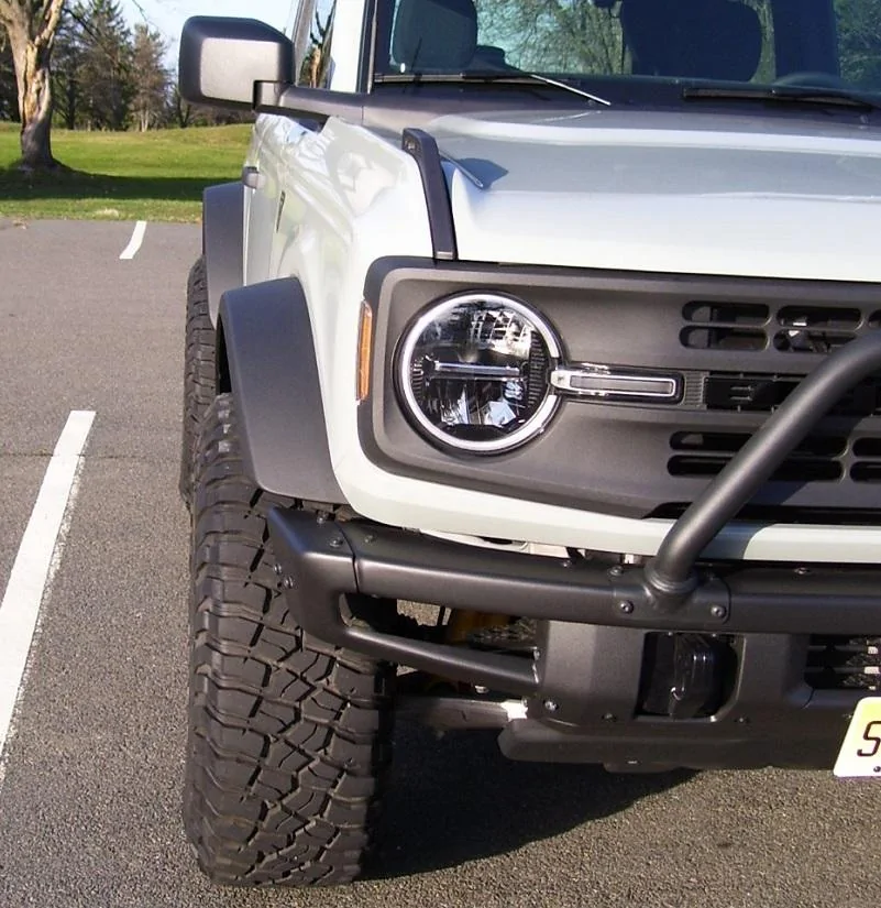

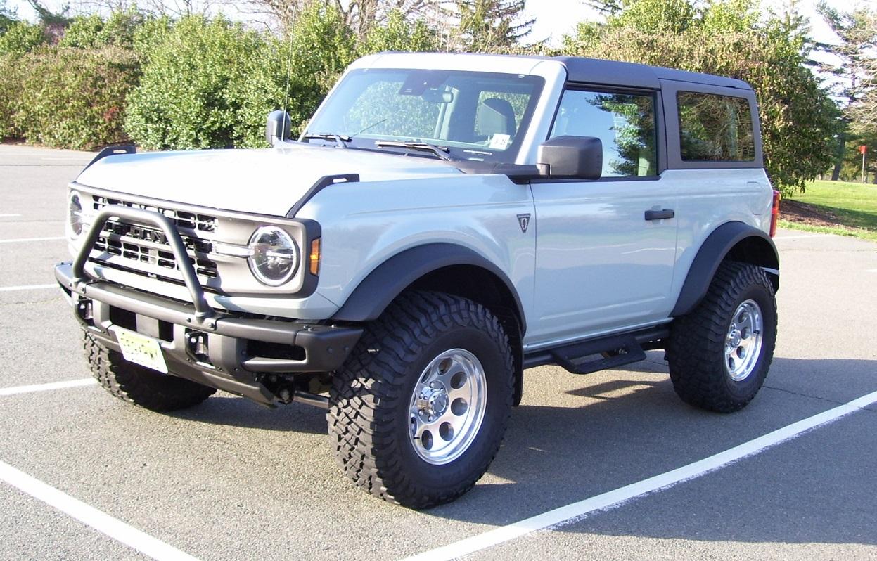

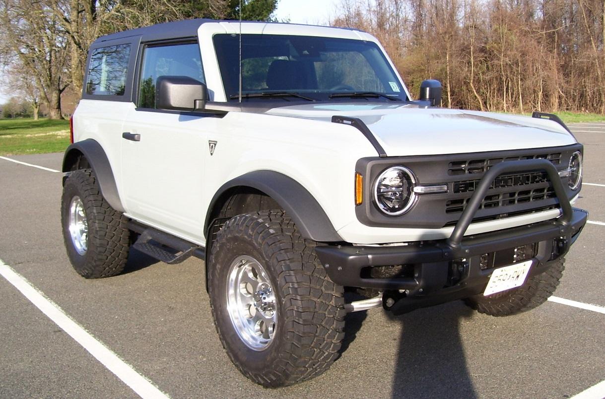

I have Non-Sas OBX and put Nitto Recons 315/70 r17 on G-FX TR-19 Rims (17 X8.5 +18 offset) and hub centric rings. No lift. No rubbing. I removed the crash bars but I installed 4WheelParts alternative crash bars. I’m happy with the look and the height. Originally I had planned on a lift but the tires alone gave me what I’m looking for at least in the immediate term. Hope this helps.

It will depend on if you stick with stock flares or go to Sas flares that are wider. The width of the wheel also determines how much pokes out along with the offset or backspacing. On my base Sasquatch, I have 17x9 wheels with -6 offset wheels and 35x12.5x17 tires (almost the same size tires as Sas 315/70/17).
