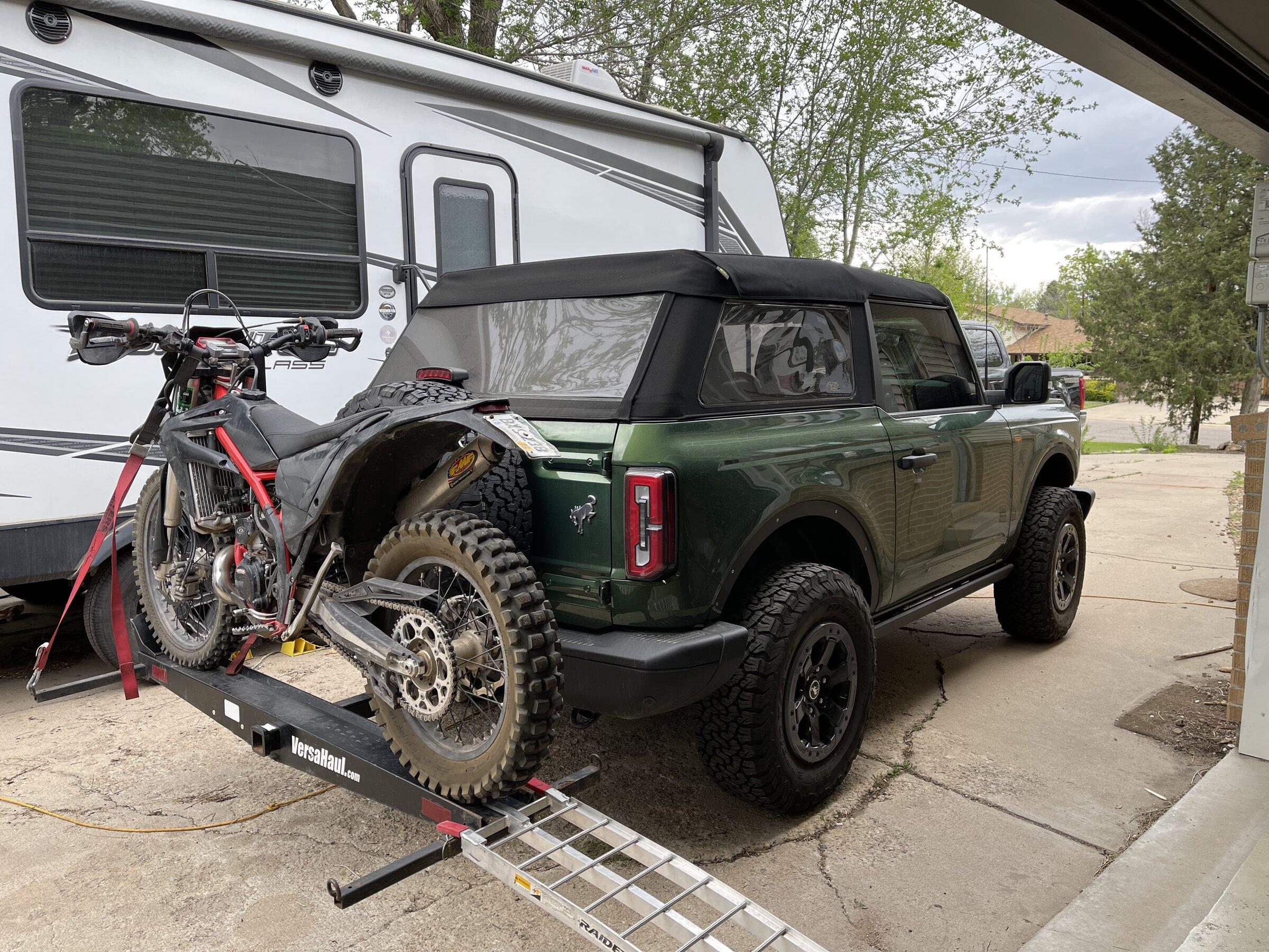

Loaded up one of the bikes and did a trail work day. I’d say it was close to 300lbs on the hitch. Hardly noticed it was back there.
Probably closer to 600+ pounds at the hitch. Unless the bike and mount only weigh 150 pounds total.
The use of a hitch extender reduces the tongue weight capacity of the trailer hitch by 50 percent. So if the trailer hitch is rated for 1,000 pounds tongue weight it would be reduced to just 500 pounds tongue weight capacity when using an extension. It doesn't reduce the gross trailer weight capacity, only the tongue weight. Some extenders also have the additional restriction of flat towing only (towing a vehicle with all 4 wheels down) and cannot be used with trailers.

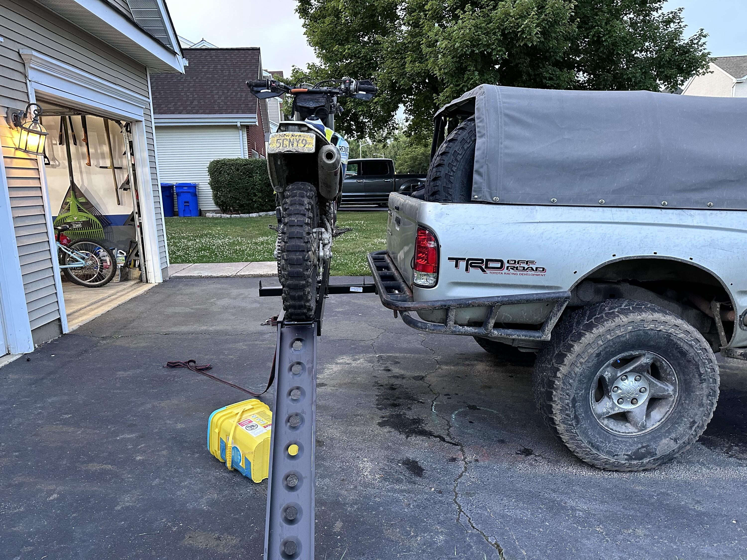

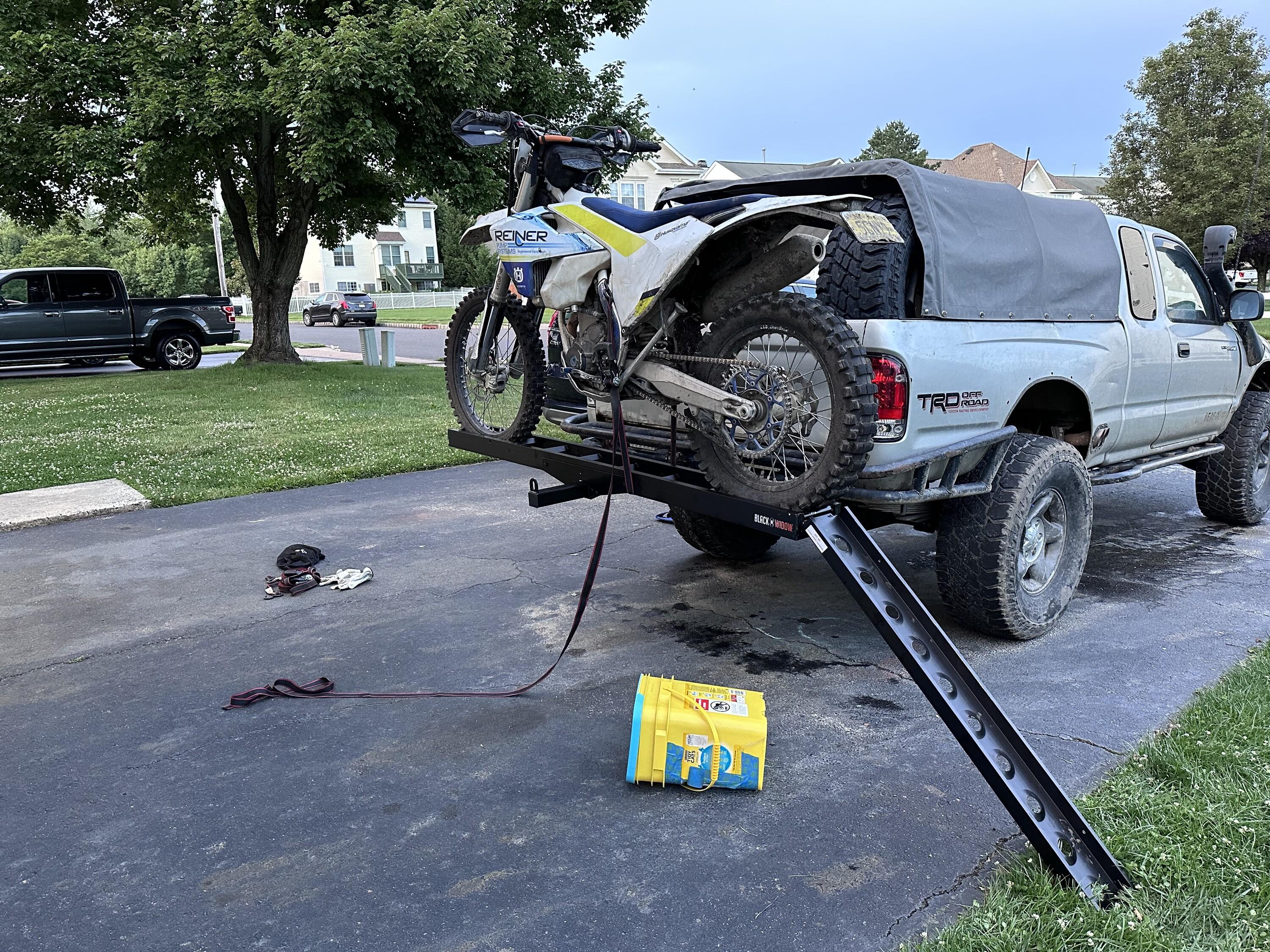

Have you still have had no issues? I just picked this up for my Tacoma (I gotta get a drop because this was almost impossible to load) and plan on hauling my fe350. I think I can probably even get away with the spare still being on without an extender but we will see when the Bronco comes in (23 Wildtrak 4dr). If not I think I just won't run the spare since I plan on only using this for local riding or dual sports which is just street driving.

I’ve ran it a few times more. The bronco isn’t the dedicated hauler. That’s looks like a steep push up that ramp with a heavy bike.
Ha yeah hence the need for the drop on this rig. This isn't the primary way for me to haul this bike, but got the hitch hauler for options.
